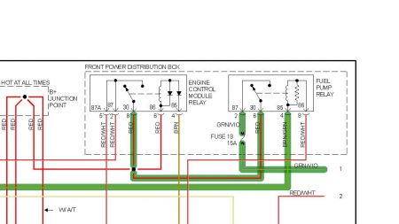

Car has petrol and working battery, fuel pump has been tested and works but when connected to car it won't work, have checked the fuse and all fine. Please help

Test the fuel pump relay/engine control module relay see below
https://www.2carpros.com/forum/automotive_pictures/12900_fp_2.jpg

At that age and with those miles, I would replace the fuel pump and the filter to remove suspicion and as preventive maintenance.
