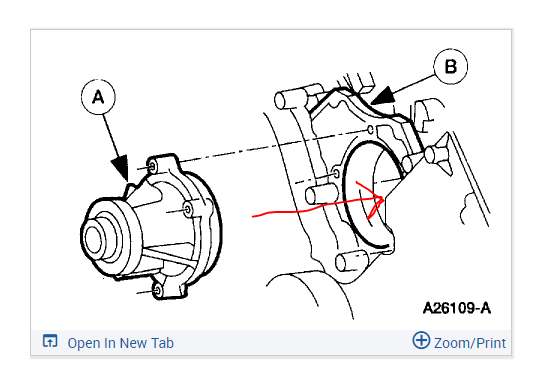

  • 110,194 POSTS
If it is coming in that fast, I have a feeling the block may be cracked. I had one a few years ago that had a hole rusted through in one of the coolant channel right where pressure is direct from the water pump.
Check closely for any internal damage to the block. If you can't see anything, I don't want to say it, but the oil pan will need removed to see where the coolant is entering from.
With the pump removed, inspect internally for cracks or rust issues.
See pic below.
Tuesday, March 26th, 2024 AT 8:17 PM

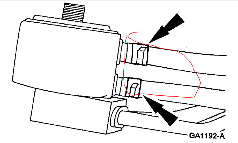

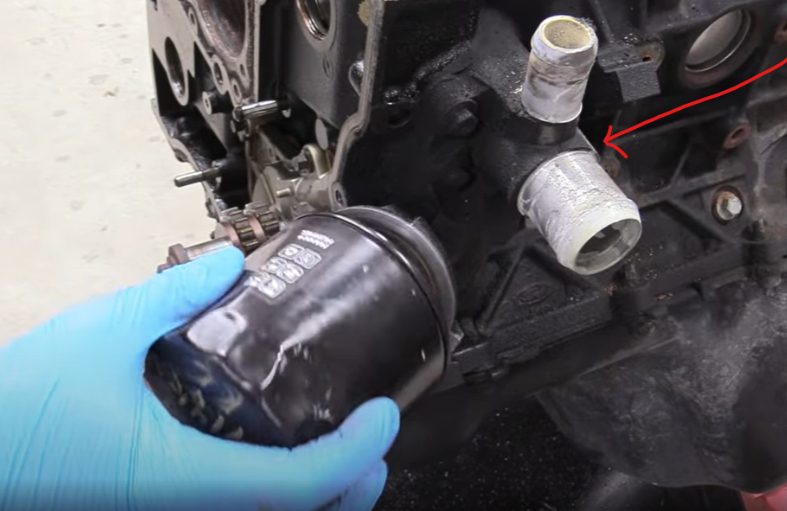

Also, just to confirm. Did you check at the oil cooler, where it attaches to the block? See pics below.
Tuesday, March 26th, 2024 AT 8:41 PM

Hi, a bunch of corrosion at the water pump. I inspected it as best as I could and could find any visible holes. The oil cooler. I also checked that as best I could but have not removed it. With the filter off, no water comes out of the oil filter hole. I read on a forum somewhere that some early 4.6 engines had a ruptured manifold crossover that caused this. I know what a manifold is, but I'm not certain what is meant by "crossover" they mentioned that this was covered under warranty but very few found out about the issue until after the warranty expired. Just random talk in a Ford forum. Nothing from a seasoned mechanic.
Thanks

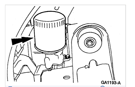

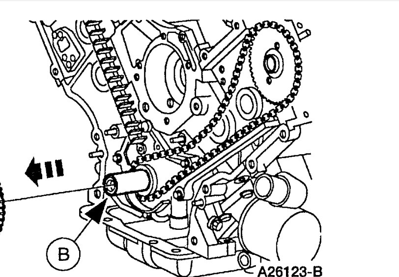

  • 110,194 POSTS
I don't believe the crossover was used on this truck. Try this: pinch off both coolant hoses at the cooler and see if oil still enters.
We may need to remove the oil pan to see where it is coming from.
See pic below.
Wednesday, March 27th, 2024 AT 5:57 PM

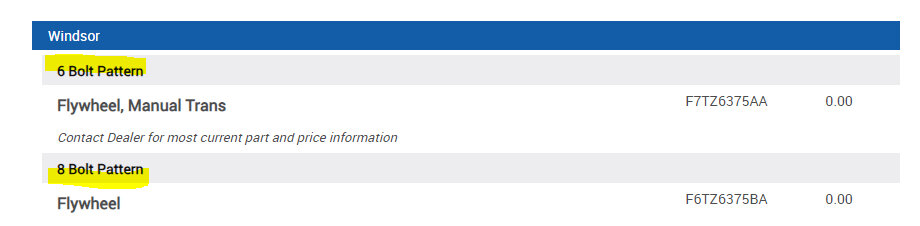

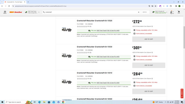

Hi. I didn't get the chance to pinch off the oil cooler hoses today because of the weather, but I'll do it tomorrow. In the meantime, I was looking for used motors in case I need to change the motor. I know my 1997 is a 4.6L Windsor, but evidentially the 97 Windsor's could have either a 6-bolt flywheel or an 8-bolt flywheel? If I may ask, how am I supposed to know which? Mine has a manual transmission if that makes a difference. Thanks
Thursday, March 28th, 2024 AT 7:53 PM
  • 110,194 POSTS
I tried looking for OEM part numbers related to the flywheel. You are correct. There are two different ones.
I can't guarantee it, but if you give me the VIN, I can look up your specific vehicle to see if there is specific information. I suspect because it is a manual transmission, it is the 8 bolt, but I can't be sure. You may have to remove the transmission so you can see it.
See pic below.
Thursday, March 28th, 2024 AT 8:09 PM

Evidentially the 6 bolt flywheels were in the early produced 4.6 Windsor engines and then at some point during the production year they were superseded by the 8 bolt flywheels on the Windsor 4.6. I think the Romeo engines are strictly 8 bolt flywheels for the 4.6.
If my truck is a 1997 model and the truck was produced in 3/96 then I would think that would be one of the earlier produced Windsor engines although I don't know for certain. Thanks

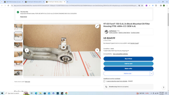

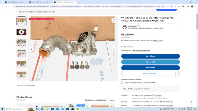

Good morning.

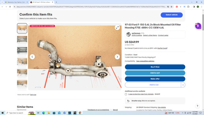

Evidentially some 1997 4.6 Windsor engines come with an oil cooler, and some without an oil cooler. My truck has an oil cooler, but the engine I'm looking at, based on the pictures, do not have an oil cooler. The VIN number's 8th digit matches. The oil pans, from what I've gathered, are the same. Amazed there are so many little differences in these engines that are supposed to be the same. Any idea if the engines without the oil cooler would be able to be swapped out for an engine with an oil cooler? Thanks
My VIN 1FTDX1860VNA40830
Donor engine VIN 1FTDX1761VNB31784
Tuesday, April 2nd, 2024 AT 8:02 AM
SWILSON3828
  • 112 POSTS
Sorry, bad pic of non oil cooler.
Tuesday, April 2nd, 2024 AT 9:30 AM
  • 110,194 POSTS
I'm almost afraid to answer. LOL In theory, you should be able to remove one and install the other. The orientation of the filter between the two will be different, but if you reuse the original one, it should be in the correct place for the vehicle.
I tried to zoom in on the base where it mounts. They appear to be the same. Is that correct or am I missing something?
Tuesday, April 2nd, 2024 AT 10:37 AM
