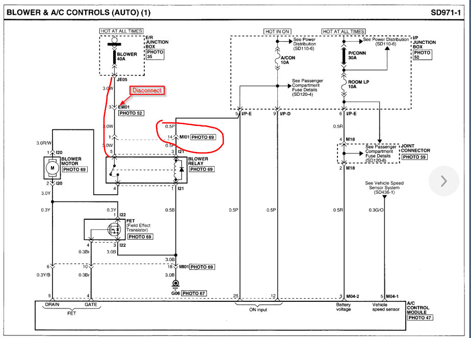

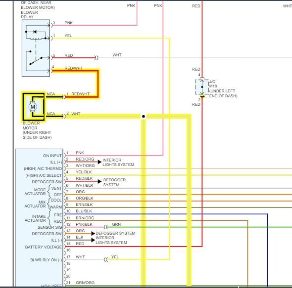

Good morning,

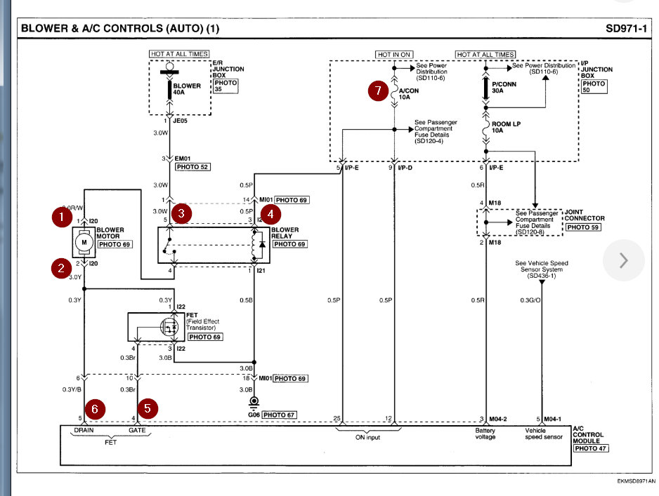

Can I approach this in a different way?
Can you tell me if you have voltage to the red/white wire at the blower with the key in the on position?
I attached a diagram as well.

Okay, good.
What about the white wire?
When you remove the plug, does the white wire have power?

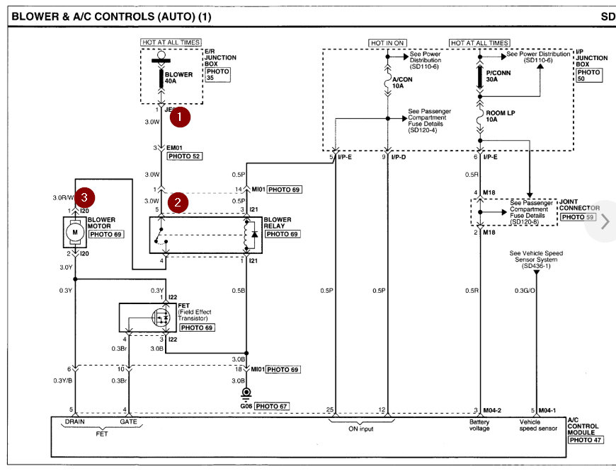

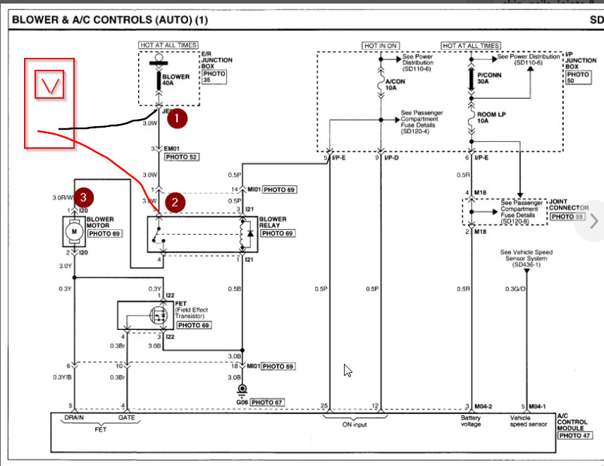

So we may be circling here but you have 0 volts at number 3? If so go back and check it at the fuse and see if you have 0 volts. You should have 12 volts on this wire at all times.
Sunday, May 3rd, 2020 AT 4:50 PM
JERRY ARCHER
  • 25 POSTS

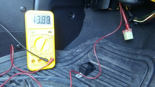

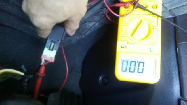

That is exactly right. When the relay is installed I have zero volts. When the relay is removed. Now I have voltage. I sent two pictures to show what I mean.
Tuesday, May 5th, 2020 AT 2:07 PM
Okay. Let's check voltage drop on that wire from the junction block to the relay. Basically just measure voltage from point 1 to 2 with the relay in and the blower turned on.
Then measure voltage from point 2 to 3 with the same settings.
Lastly to prove out the entire control side of the system let's just 12 volts to number 3 and then try to change the fan speed using the normal controls. Are you able to increase and decrease the fan speed when you put 12 volts to the fan?

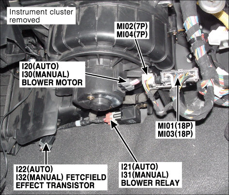

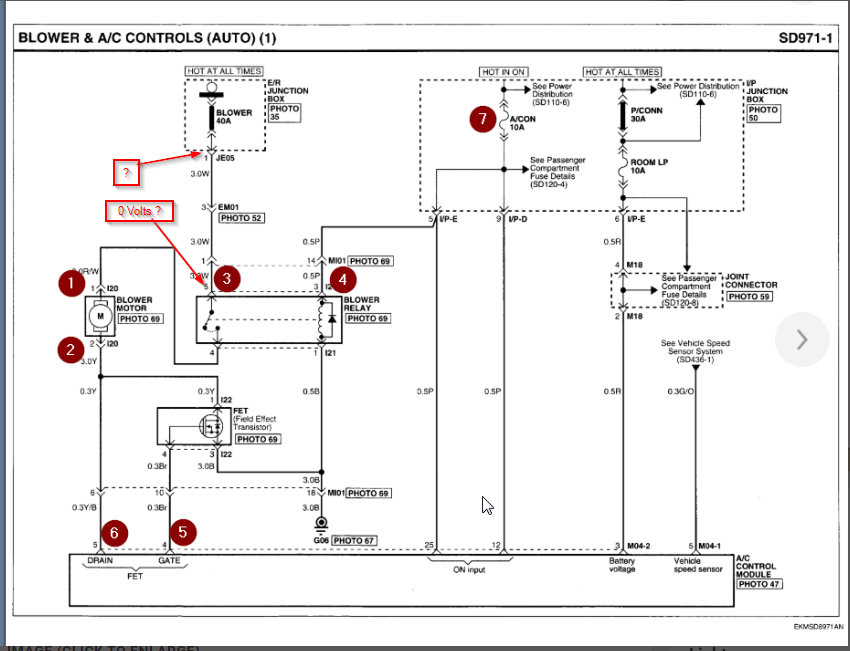

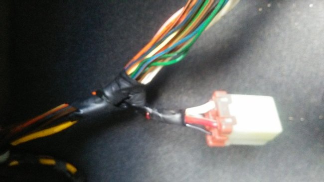

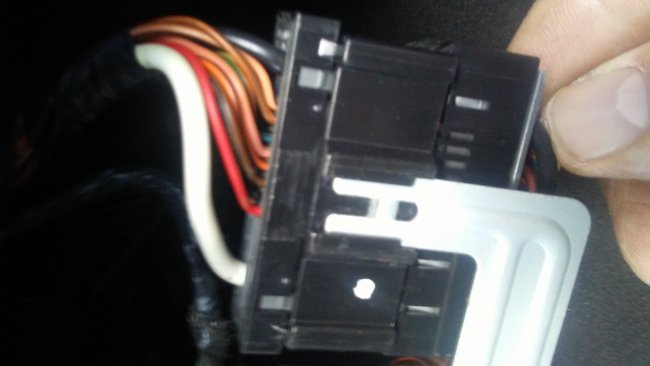

Okay, couple things. 1. I have 12 vdc going to the white wire to the relay. When the ignition is off. 2. I have 13.89 vdc going to the white wire on the relay when the vehicle is running. As soon as I close the circuit the in any way the voltage drops the zero. I open the circuit up and the voltage reappears. Now I noticed the white wire does not run directly from the fuse to the relay plug. It runs through this other module. What module is that? I have not replaced that module. I have enclosed pictures.
Thursday, May 7th, 2020 AT 8:37 AM
I don't know. That is not on any of the wiring diagrams. It only shows some inline connectors not a module. Is there a part number on it?
I just want to confirm you understood what I was asking for. I know you have those voltages at those spots on the white wire but I want you to do a voltage drop test on the white wire with everything hooked up. That means put your black lead at one end of the circuit and the red at the other. Take a look at this diagram. This will tell us what the voltage is on that wire.

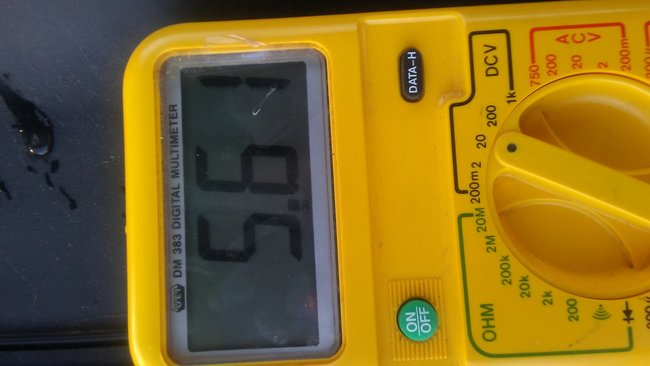

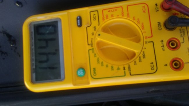

I took voltages as you asked. The higher voltage is with the car running the lower voltage is with the car off. I also sent a better picture of that module that I found online. There is not a part number on the module. It's labeled MI01, MI03.
Friday, May 8th, 2020 AT 5:18 AM
So I found that as well and that is the inline connector. I am not sure why it looks like a module but it appears that is all it is, is just a connector. It was hard to tell from your picture but does it have wires coming out of both sides? If it does then that is an inline connector.
If so, I want you to unhook the other inline connector and run a wire from the fuse to the relay. You should not have 5.5 volts on that circuit. That is just a wire from the fuse to the relay so I would expect there to only be less then a volt. That indicates there is resistance in that circuit. If you run a wire from the fuse to the relay see if the fan turns on. If so you need to run a new wire and you can just bypass those two inline connectors. We can talk more about that after we find out. Thanks
