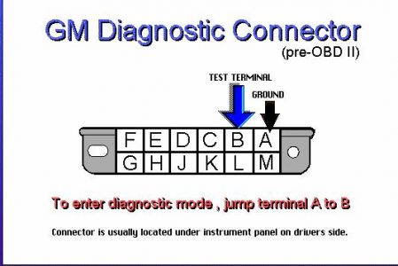

Is the service engine light on? Read the codes like this, post the results. It sounds like either the ECT(enine coolant temp) sensor, or an O2 sensor, too rich...
Cross these two terminals as shown, then turn the key on. Count the flashes, a 22 will flash as 2 flashes then a short pause, then 2 flashes, if more than one code is stored, the pause will be longer. The codes will display three times and end with 12. Write them down and post here. This connector is right under the middle of the dash...
https://www.2carpros.com/forum/automotive_pictures/62217_Pre95GM1_8.jpg

MAGICCAR1
Code 12 &15
Thank You for the help
Rick
Monday, May 29th, 2017 AT 10:33 PM (Merged)
MERLIN2021
  • 17,250 POSTS
12 is nothing and 15 is the coolant temp sensor reading too low. Change the sensor.
