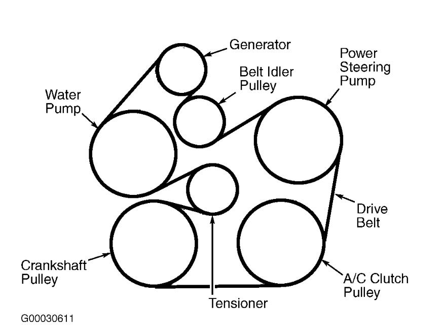

https://www.2carpros.com/forum/automotive_pictures/62217_Untitled1_1.jpg

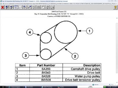

https://www.2carpros.com/forum/automotive_pictures/62217_30S_1.jpg
Top is engine code U bottom is S

How do I find the correct belt for my car? There are so many out there that would 'Fit' my car when I searched internet. Does number of ribs important? My car is 2000 Taurus SE gas sedan. Is there a fix measurement that I can use to compare various brand, type or size? What would the best in the market? Good Year, Dayco.

When you replace the tendsioner the pulley normally comes on it. As long as you give correct engine size and vin which in your case is U the tensioner is what holds the belt tight so replace that. Stick with goodyear, dayco or Gates belts. Dont' buy any tensioner that is made in CHINA. I'm also sending blet routing so you can install it correctly. If you don't have the routing diagram

Thanks for quick reply and the routing diagram. So. Is Goodyear 4060855 the correct belt for my car? Sometime when it rain, I hear the constant screeching noise. So. Do I need to change the idle pulley? Or most likely the sound just came from bad (a bit torn) belt?

If you have a 2valve 3.0l v6 it will. I told you there are two vin u and vin s you have vin u check with a parts store. One is flex fuel the other isn't but belt fits both it says. Make sure to replace tensioner as well other wise you are wasting your money
