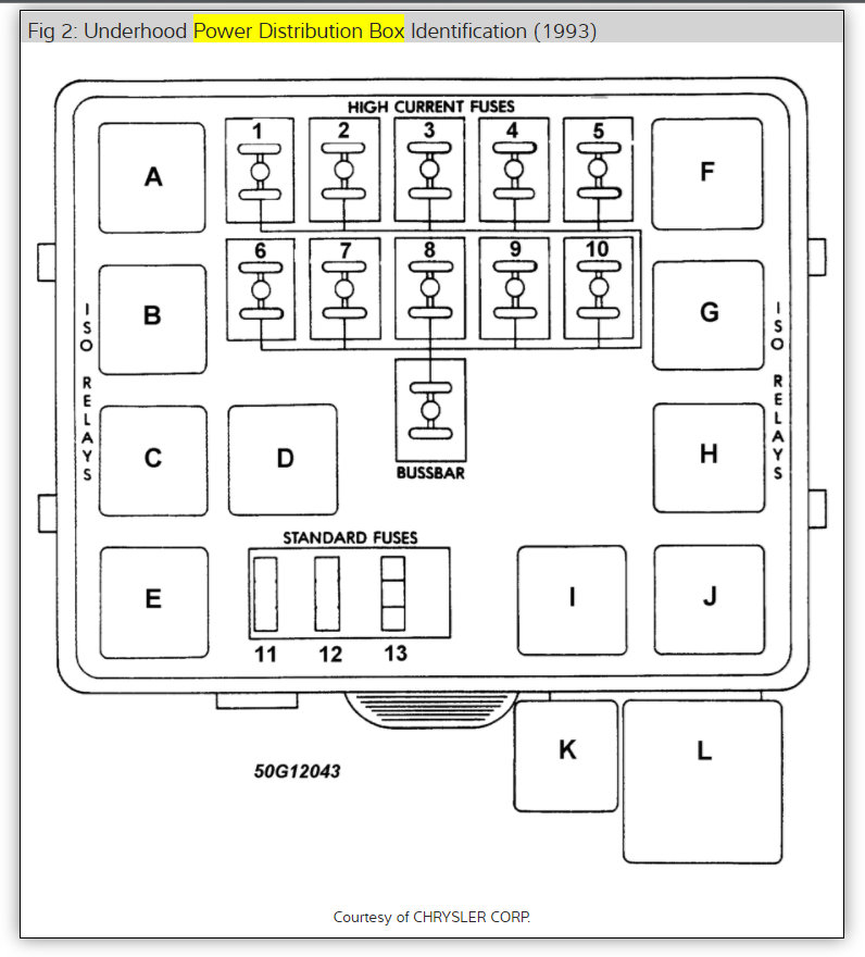

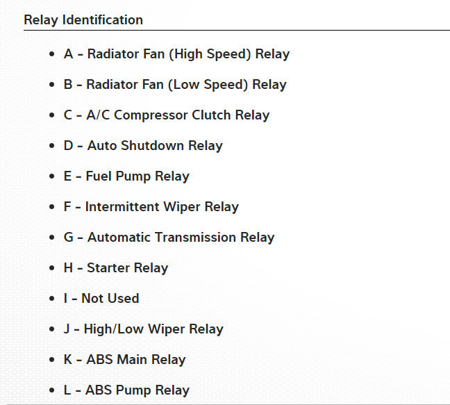

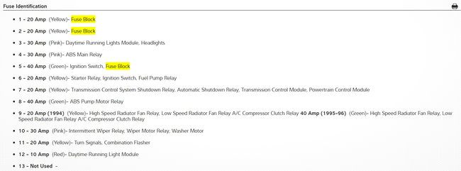

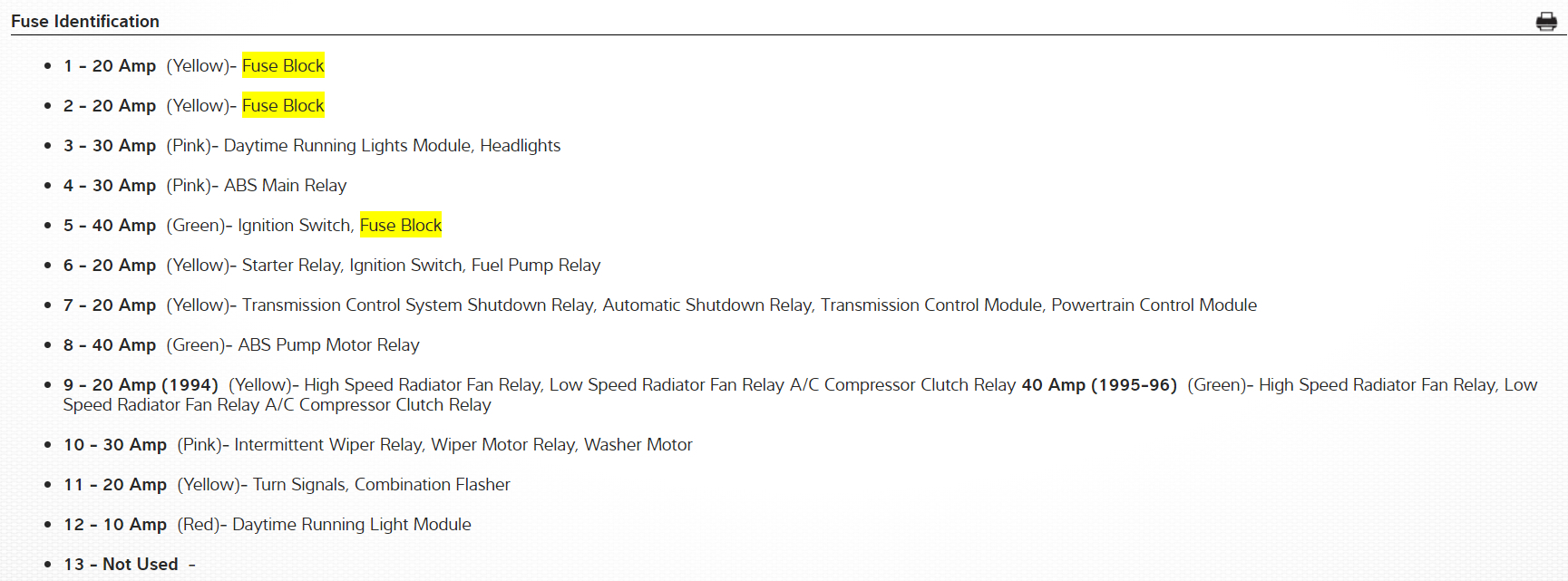

It appears the ASD fuse (20 amp) is causing at least 120 mA of the draw. What does this fuse control? Should it be providing any current when parked?
-1
Wednesday, July 29th, 2020 AT 7:28 PM (Merged)

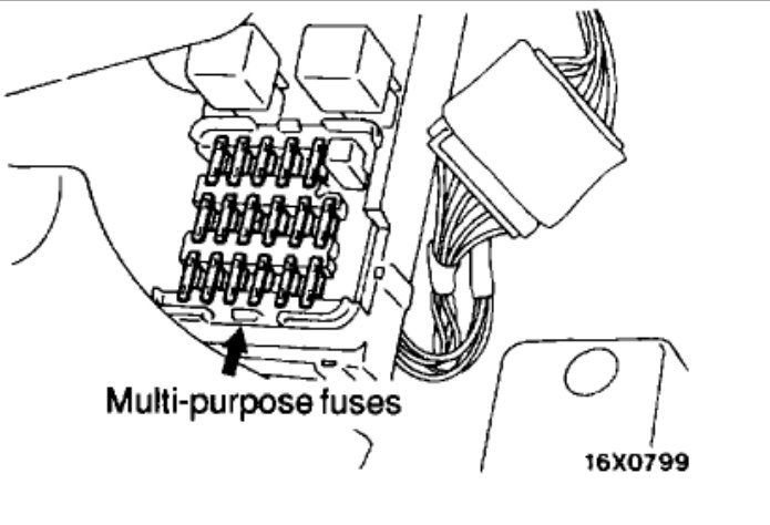

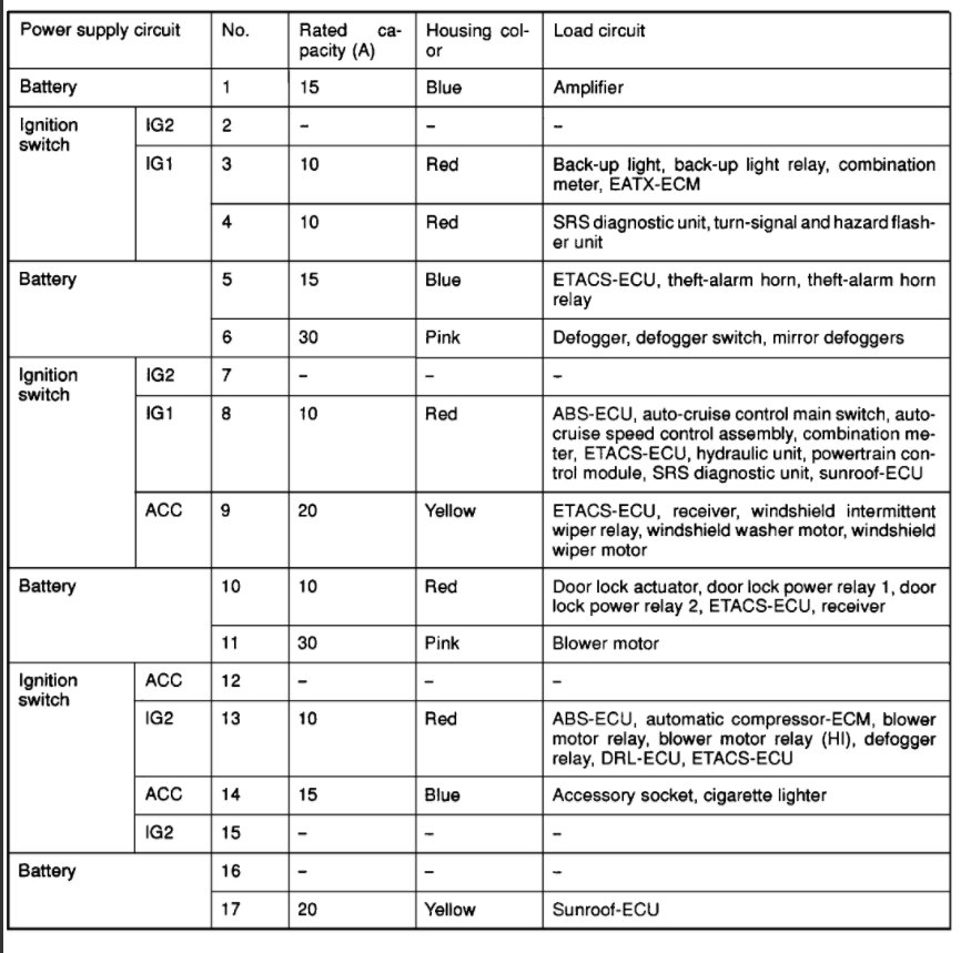

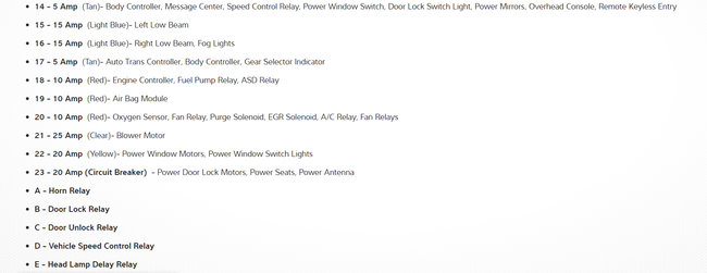

There is battery drainage after the door is locked either by a fob or with a key. The fuse has been identified that controls the security system, etc. Of all the things affected by this fuse, the obvious thing is the arming of the security system by locking the driver door.
Is there a way to disarm the security system and leave in tack the door lock by key or fob?

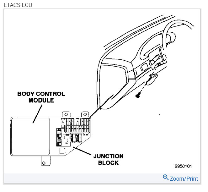

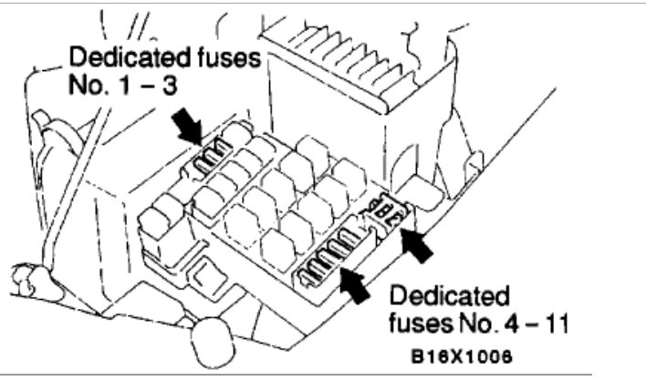

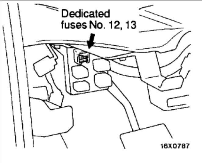

It sounds like the BCM is having an issue which acts as the security system as well probably holding the locks down until the battery is dead.
I would try removing the electrical connectors from the BCM to see if the battery drains down. here is the location.
This guide can help as well.
https://www.2carpros.com/articles/car-battery-dead-overnight
I would remove it and look for water damage.
Check out the diagrams (below). Please let us know what you find.
Wednesday, July 29th, 2020 AT 7:29 PM (Merged)

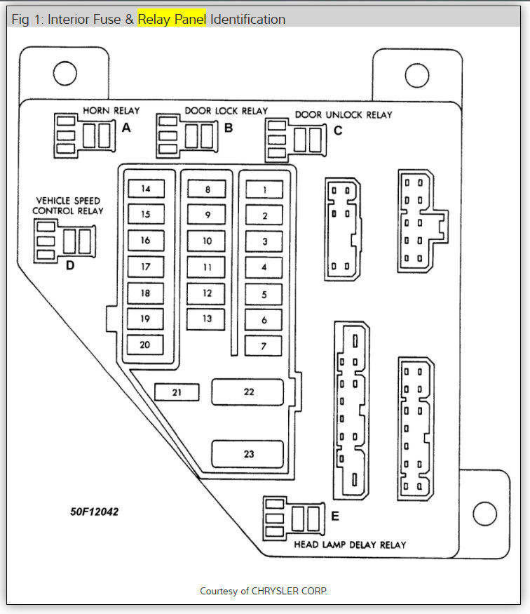

By removing the BCM will I still be able to use my key to lock/unlock and my fob to do the same? Will its removal affect any other functions like horn, lights, etc. Which seem to work with the door lock now? Do I need to replace or permanently remove it?
I like the diagram and know where the fuses are at the left end of the dashboard. Do not understand the position of the BCM in relation to the panel of fuses. And what does the plug that is shown pulled out from steering column do and is it necessary to remove it? Is it relevant here at all?

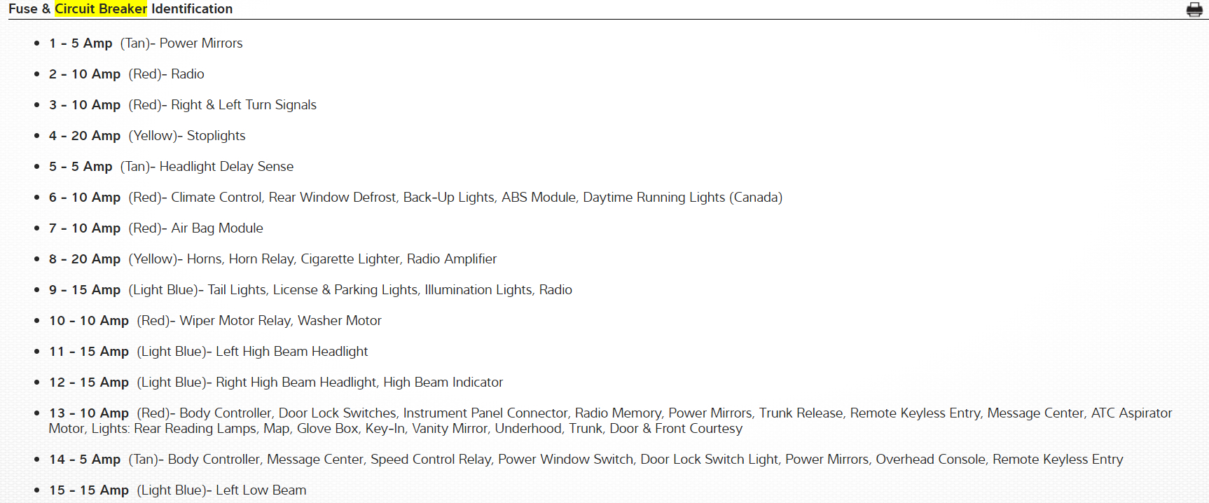

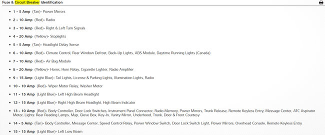

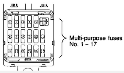

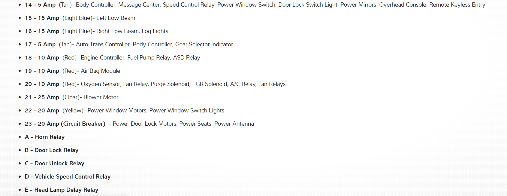

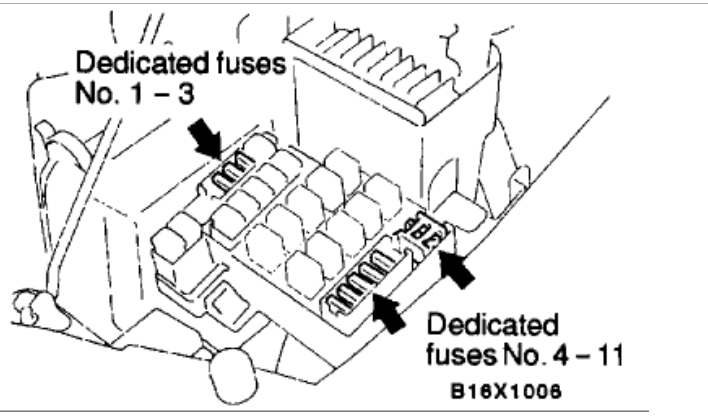

Hi Pamela
You can remove the BCM, this is just to test if the battery is not draining down. You cannot drive it or do anything accept let it sit to check the battery.
Here are the fuse panel diagrams you requested and a guide to help check them:
