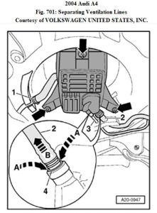

My fuel tank appears to not be venting properly. Whenever I attempt to put gas into the tank, the hose clicks off repeatedly and i hear a hissing from the tank. I am only able to put in about .3 gallons at a time before it shuts off. very frustatrating.
anyway, i am attempting to track down the vent for the tank and having a difficult time finding it. i am not sure this is the exact problem, but through trial and error, it seams to be the best guess.
thanks!
Apr 13, 2009 at 1:40 PM
KHLOW2008
  • CAR REPAIR CONTRIBUTOR
  • 41,814 POSTS
Hi sonic242, Thank you for the donation. You should be on the right track. There is a service hole under the spare wheel well under which you would find the EVAP canister. Check for clogged or kinked lines.
