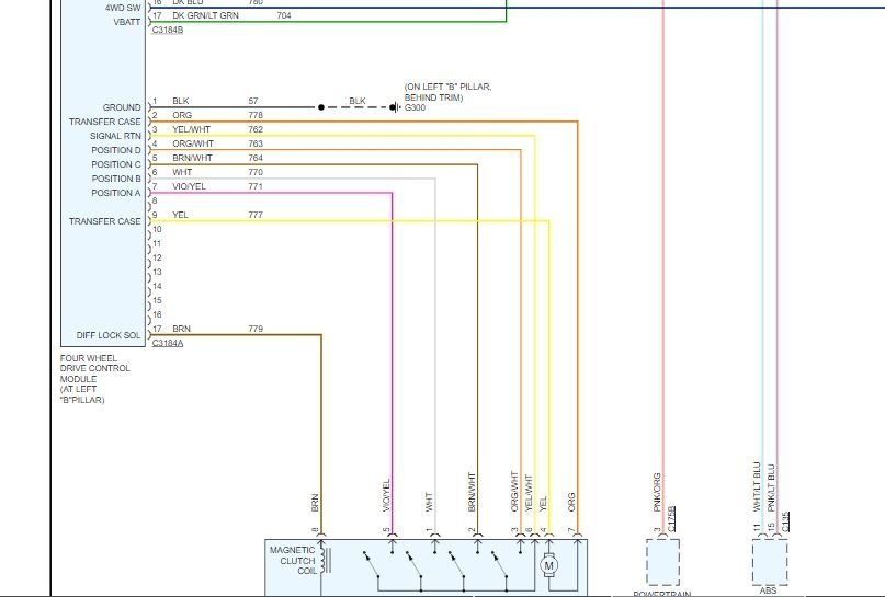

The yellow wire comes from the module in the truck. Diagram attached.

Sorry for the slow response. Been doing a lot of reading on this topic, that is to say, as much as I can find. First of all the wire going to my transfer case housing is white not yellow. Interesting first observation but not sure what impact that has on our diagnosis. Second, the function of that clutch coil is to spin up that side of the transition to speed when shifting into 4WD while driving and my personal thought is that this really has no impact on the problem I'm having which I believe is a shift fork not disengaging from 4AWD back to 2WD. So as not to blow up the transfer case, now on the car, I did not apply voltage (worried that 12 volts direct from the battery may not be the correct voltage application of electrical power) to that clutch/coil pack in the transfer case.
Starting reading about earlier model of transfer cases and apparently 1999 (not sure of the scope of this style of transfer case set up) had a vacuum trigger to pull the shift fork back out of the 4AWD engaged position to the 2WD position. There is a large hose on top of the transfer case that I did not trace when I put the new (used) transfer case in. I assumed it was for moisture evaporation the way the IWE actuators have a small 1/8"ish version of hose that does this. Anyway, in the older models, the 4AWD to 2WD motion of the shift fork was vacuum triggered (I read that if there is a leak, the amount of vacuum applied would not overcome the force needed to pull the shift for out of the 4AWD position into the 2WD position) come to find out and thought I would trace this with some help on the top side to see if it was vacuum hose and evaluate that possible diagnosis. I reconfirmed, in my reading that the shift motor only have three positions of alignment, 2H/4AWD, (however it is labeled 2H) 4H and 4L.
Do you know if that lonely, single 3/8"ish port on top of the transfer case is evaporation or vacuum? We are running out of options. It is becoming a matter of pride and drive. I almost gave up last week.
Jim

Here is my plan but not sure how it can help: I am going to go through all fuses and relays in the passenger kick panel fuse box on Sunday if time permits and test every one for continuity.
My concern is, that with only one wire going into the transfer case (powering the coil/clutch), and no vacuum lines, how can this be an electrical problem? The TCSM is in the correct 2H/4AWD position with only 4H and 4L options both of which would be wrong. I would give my left pinky to figure this out.

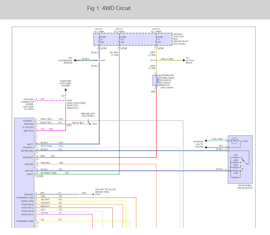

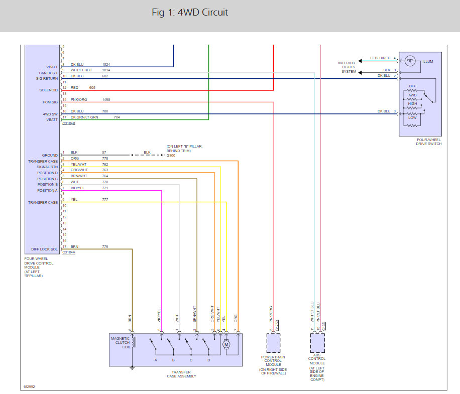

Here is the complete 4wd wiring diagrams with a guide to help you test the connection:

Sorry, I have to the splined gear on the front axle side gets pulled into a neutral position when the white wire to the magnetic clutch coil receives power. That's the prob Bob. Now I have to find out why it is not getting power. Is there a simple relay you know about that I can locate and change? I don't think it is the TCCM because I tried three others and they didn't help. Any ideas?
Monday, March 25th, 2019 AT 6:31 PM
I sent you the same diagram Ken sent you as well. There is no simple relay in the circuit.
