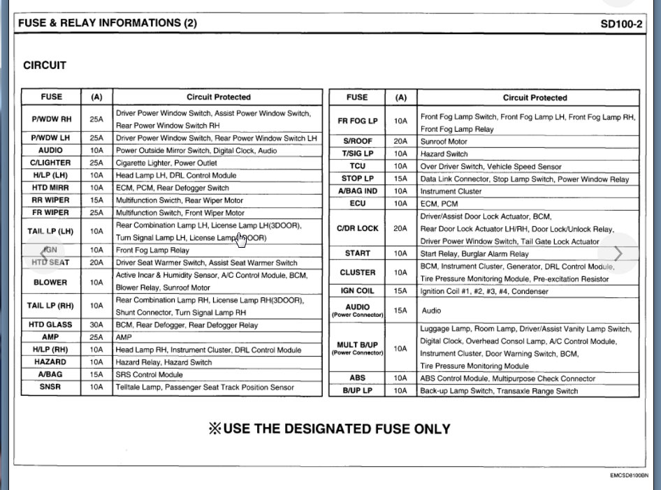

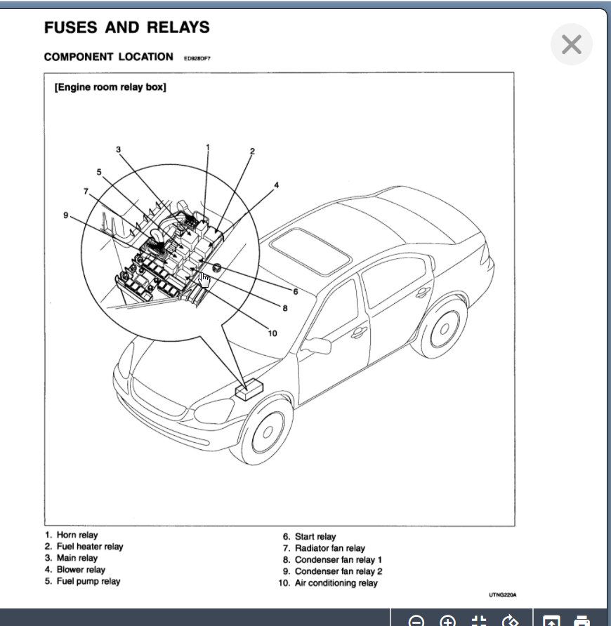

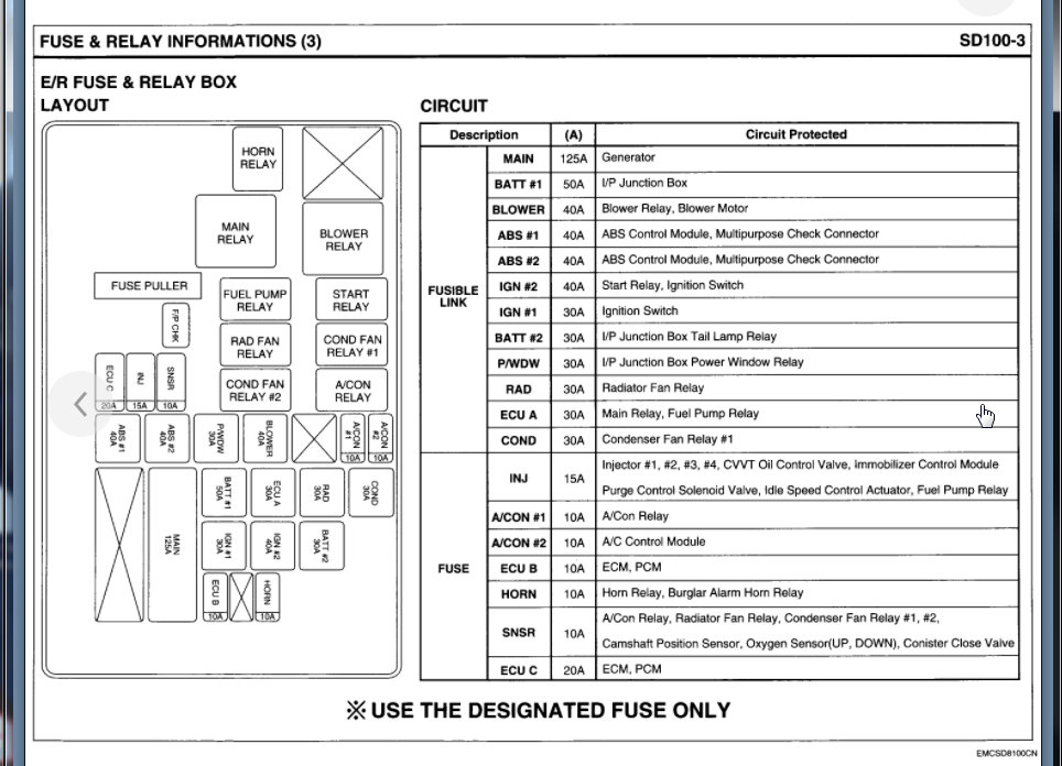

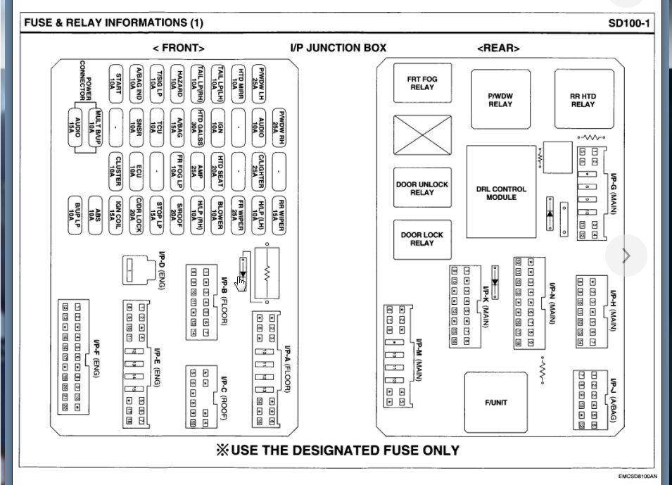

I accidently cross battery terminals and then replaced alternator. Alternator wont charge still. I cannot find any fuses?

Below is the info you are looking for.
However, here are a couple guides that will help with testing fuses and relays:
Please see below for the fuse info. Let us know if you have other questions.
Thanks
