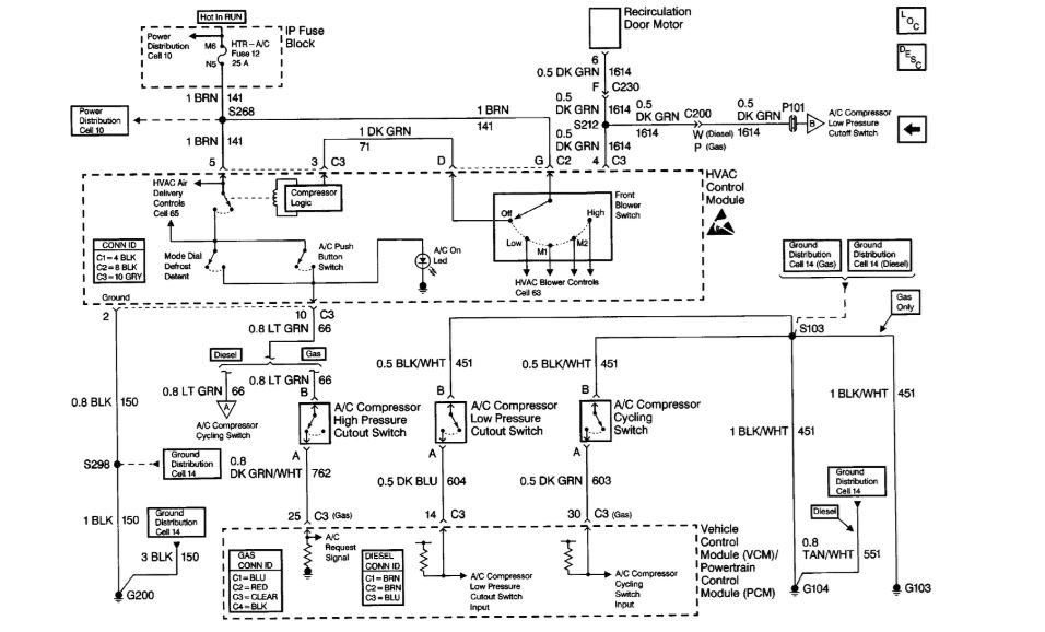

My old AC unit was leaking so I had to replace the compressor with a new one. Once I have the new compressor installed and charged it work but it blew the valve or the sensor out of the back of the compressor. I Replaced that snap ring that holds a sensor in. Recharge the system and the in cab control unit quit working the AC light would not turn on nor would the compressor kick in I put a different control unit in and it worked for about thirty seconds then quit. I am not sure where to go from there The compressor will run if it is bypassed or jumped by the relay.

The control head sends a signal to the high pressure switch which is the one that popped out. The Freon may have damaged either the wiring or the switch itself causing the control head to fail.
Check the switch for voltage with the key on. It should have voltage. I attached a wiring diagram for you to view.

I do have power on dark brown wire that connects to head unit, but not on the sensor side.

Dark brown and dark green are the powers to the control head.
Do you have power at the high pressure switch?
The light green wire is the output for the high pressure switch.

I do not not have power at the light green white but too the dark brown wire at the head unit, and 1.35 volt or wire in switch.
Sunday, June 17th, 2018 AT 12:58 PM
What about the dark green wire? That is main power and must have power?
If you have power then the control head is the issue but may have been burned out from the light green wire shorting to ground.

The dark green wire has no power.

I jumped the dark brown wire to the dark green wire and then there was power to the switch on compressor, when then two are jumped the blend actuator under dash works. Think I am going to have to take to a shop.
Sunday, June 17th, 2018 AT 1:14 PM
Yep, you have a wiring issue. Both of those wires come from the same fuse.
It is a harness issue.
Good job doing the testing. At least you found the exact cause.
Sunday, June 17th, 2018 AT 1:28 PM

Roy, I think the cause of this issue is the blend door actuator. I have it unplugged and it works great. I plug it in and takes out the head unit! What does that have to do with the AC if I may ask! Thanks
Thursday, June 21st, 2018 AT 4:19 PM
All the commands for the blend door actuator come from the control head.
Get another actuator and just plug it in before installing it and see if it all works.
It may be pulling down the voltage.
Thursday, June 21st, 2018 AT 4:33 PM

What is cell 63? Or schematic of it?
Thursday, June 21st, 2018 AT 6:44 PM
Cell 63? Please explain.
Friday, June 22nd, 2018 AT 3:56 AM
TOM81
  • 12 POSTS
Inside the control head. There is a compressor logic, what is that for is that a relay or a resistor?
Friday, June 22nd, 2018 AT 4:01 AM
I do not have a break down of the control head. I never mess with that. If it is bad, then I replace it.
