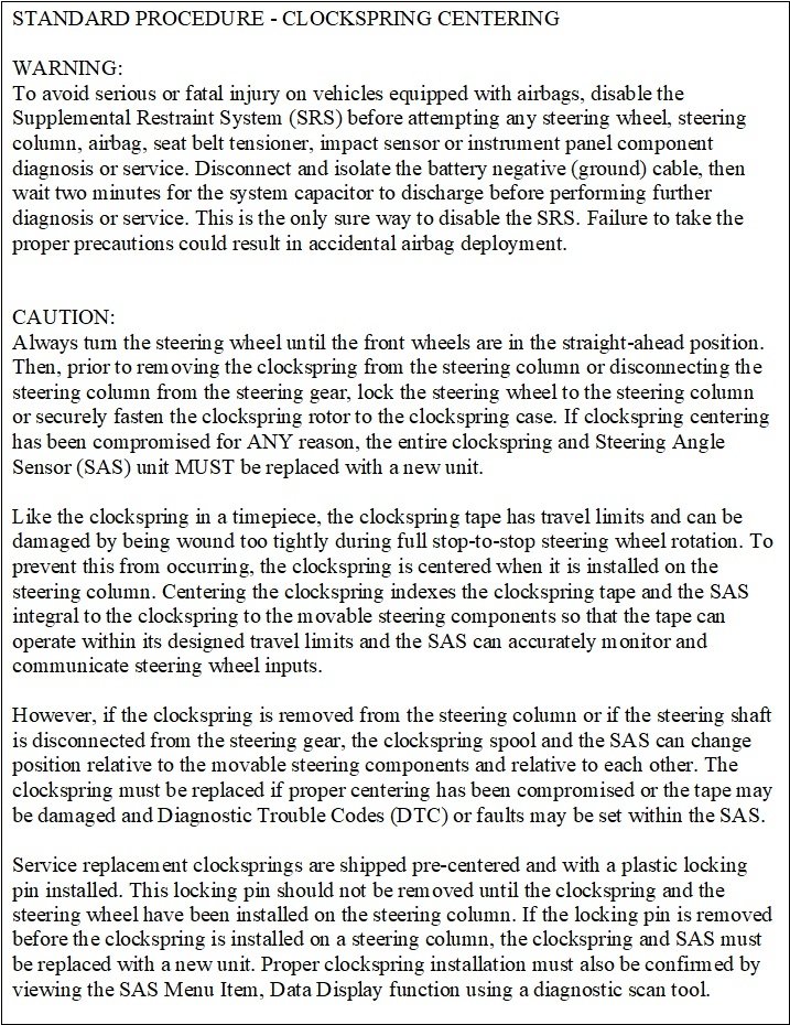

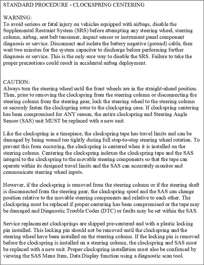

Possibly. Every clock spring has a ribbon cable that is just the right length to wind up and unwind enough to handle turning the steering system from full-left to full-right, and little more. That is why the wheels / tires, and steering system must be straight ahead when the new clock spring is installed. By having the steering shaft disconnected, the steering wheel can be rotated endlessly in either direction, and doing so rotates the clock spring. All it takes is one revolution to make the assembly not centered, then there's a fifty percent chance it's going to wind up too tight and tear off on one end, and a fifty percent chance it will unwind too far and fold over on itself. It's that folding over that has to occur a lot of times before the ribbon cable breaks from fatigue, and that is the time one system will fail at a time. Sounds like that is not how yours failed. If it was caused by the recent service, you wouldn't notice a problem for some time.
When the cable winds up too tight, it gets torn off the first time the steering wheel is turned all the way to its stop, (not sure if that's left or right, but that's immaterial at this point). With this type of failure, the end of the cable will be ragged and have a jagged end. Some have tiny rivets attaching the copper circuits and the cable will be torn out of those rivets. If this was a failure due to normal age and wear, you'd likely see a smooth, clean break on one end of the cable, and as I mentioned, one system will fail at a time. There can be over a half dozen separate copper circuits or wires running through that ribbon cable. Two are for the "initiator", aka "squib" that fires the air bag. Two or more are for the cruise control switches, if you have them in the steering wheel. One or two are for the horn, and there can be more if you have a heated steering wheel. It is very uncommon to see all the systems fail at the same time from normal age-related fatigue of the cable. That almost always leads to one system failing today, a different system failing last week, and another one might still work for a few more weeks. It's those kinds of clues we look for when trying to diagnose why something failed.
As you described it, the ribbon cable would have wound up too tight, then got ripped off one end. That will always lead to every system failing at that instant. You'll have no horn, the cruise control won't turn on, and the Air Bag Computer will detect the break in the squib. Knowing there's that defect, the computer will set a diagnostic fault code related to "open squib or initiator in driver's air bag circuit", it will turn on the red warning light to tell you, and it will turn the air bag system off so it will not deploy in a crash. I don't know if a passenger air bag could still be operational. I think once a fault code is set, the entire system is turned off by the computer.

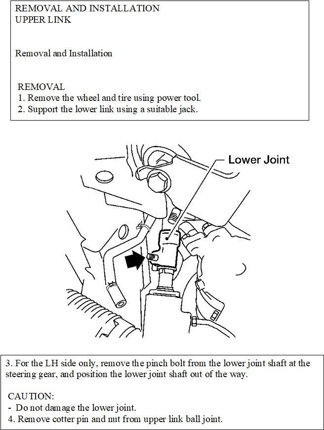

It does indeed sound like you're right. The only information that's missing is why they needed to disconnect the steering shaft. Tie rod ends, (inners and outers), ball joints, struts, and anti-sway bar links and bushings can all be replaced individually or in groups. You did mention control arms. There are some car models that require the entire cross member to be lowered to perform some services, and that can include control arm replacement. Many models have the rack and pinion steering gear mounted on the cross member, so the steering shaft would have to be disconnected for that service or to replace that steering gear. That would be legitimate reasons for taking the shaft apart, and that is when the steering wheel could be accidentally rotated one or more turns.

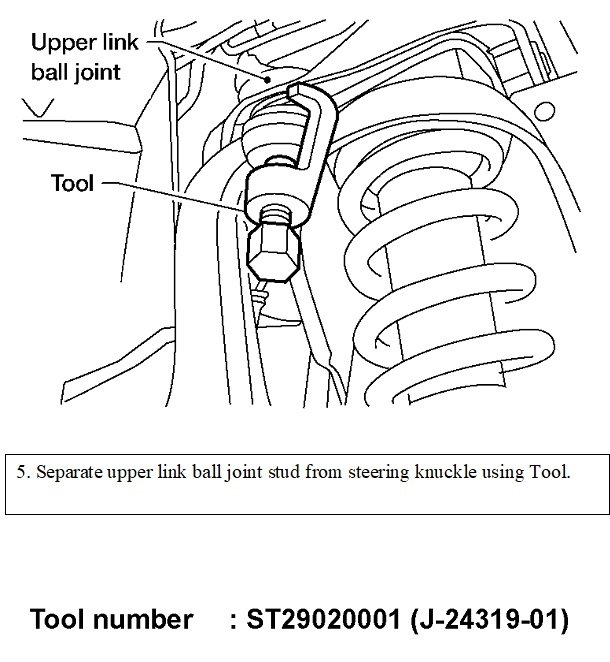

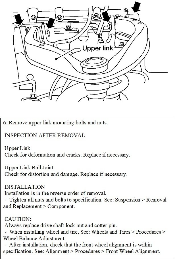

I found the procedure for replacing the driver's side upper control arm. That's shown in these three drawings. Note that in step 3 they do say to disconnect the steering shaft. The black arrow is pointing to the pinch bolt.
Back in the '90s I was the suspension and alignment specialist at a very nice family-owned dealership. At one point we had a minor recall that required disconnecting the steering shaft to gain access to a point that needed lubrication. Standard practice was to run a rubber bungee strap through the steering wheel so it wouldn't rotate in case it got bumped. Then it was just a matter of reconnecting it with no need to observe if the wheels were straight or not. Well, eventually I became complacent. The job only took a few minutes, and I could save some time by overlooking that bungee strap. One day I got called away right after I disconnected the steering shaft. Lunch hour arrived. When I returned, I found the new kid grinning as he was spinning the steering wheel around and around. I sent him straight to the parts department to get a new clock spring, then showed him what damage he had caused by playing in a customer's car. The service manager never yelled at him because they knew he hadn't had the related training or warning, but the point is, . . . we took responsibility for our mistake and took care of it right away. Reputable shop owners are not afraid to admit their mistakes and take care of them.
From everything you've provided, I'm pretty sure the mechanic caused the broken clock spring, either accidentally, or something happened that he wasn't aware of. The price you were quoted from the dealer seems kind of high compared to what I'm used to seeing, but some clock springs are relatively expensive. You may get a better quote from an independent repair shop, but the part is still likely to come from the dealer.
