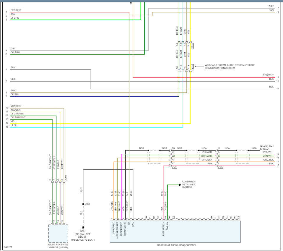

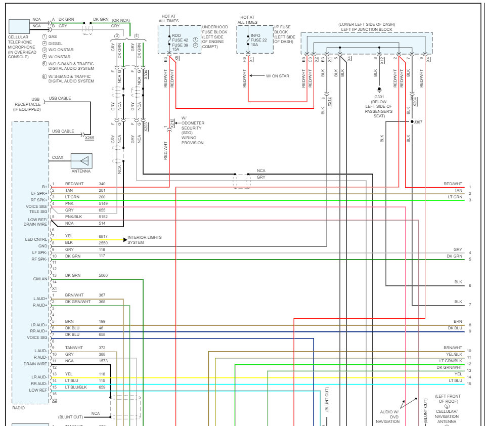

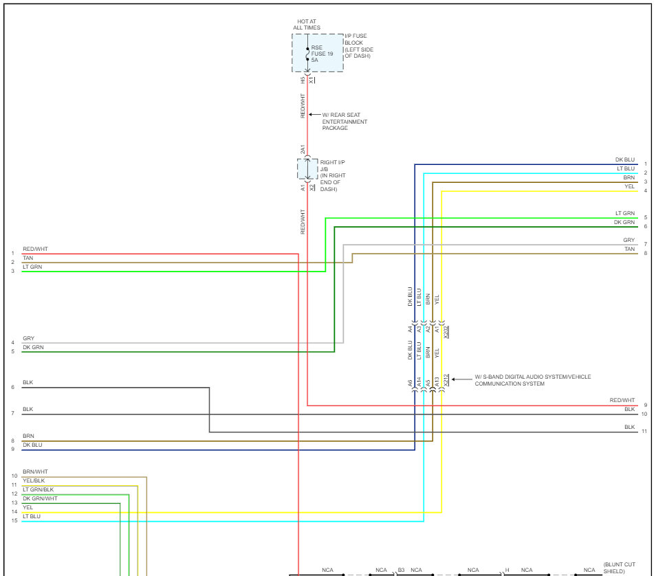

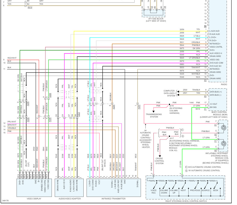

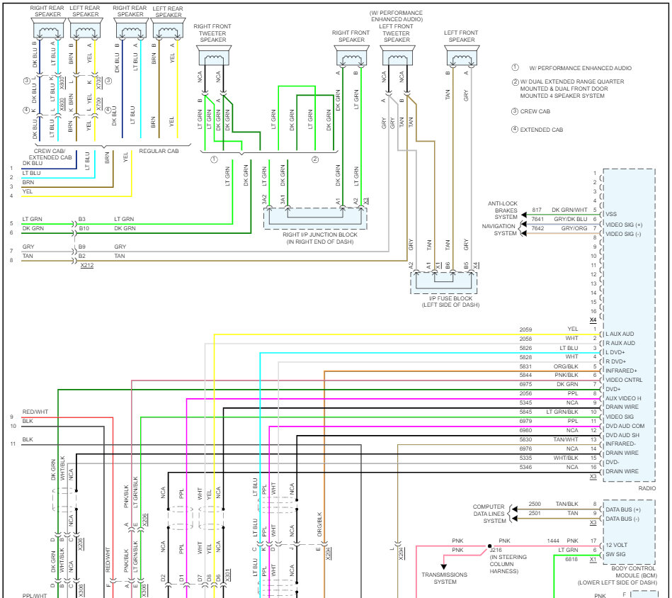

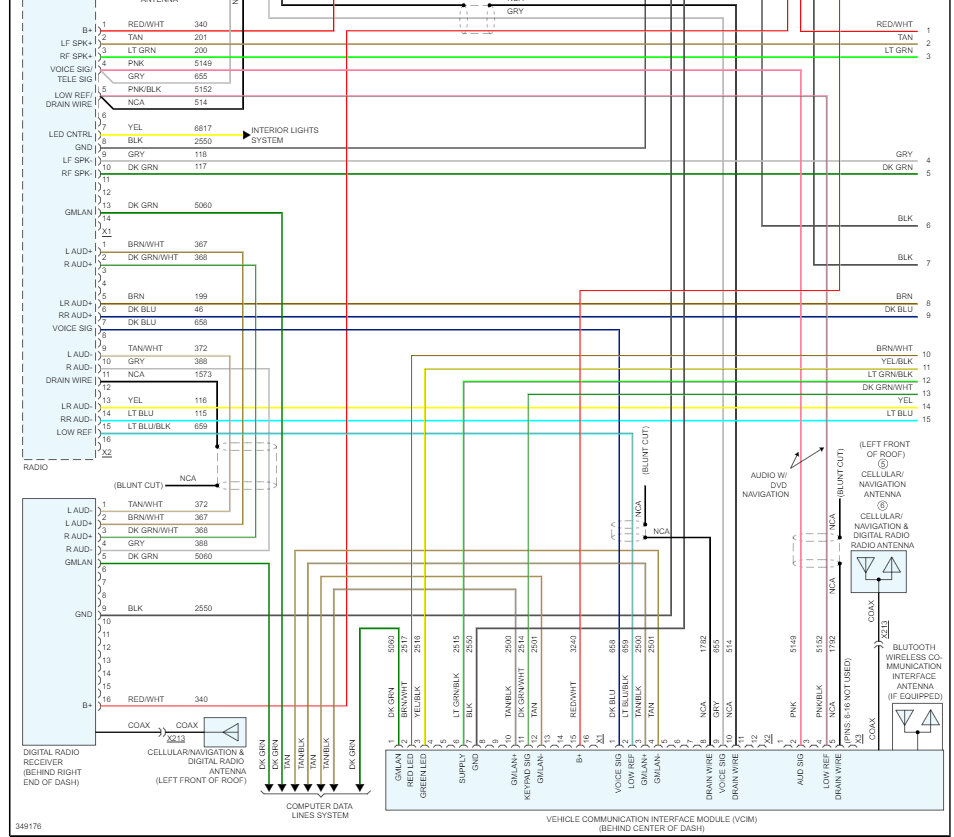

Need a factory stereo wiring diagram non-Bose system 2011 GMC SL 1500 Sierra color coded please.
Monday, July 31st, 2023 AT 10:25 AM
3 Replies
KEN L
MASTER CERTIFIED MECHANIC
55,538 POSTS

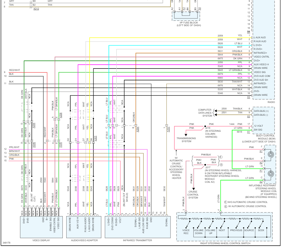

Sure, here are the stereo wiring diagrams and a guide to help you test the connections.
Check out the images (below). Please let us know if you need anything else to get the problem fixed.

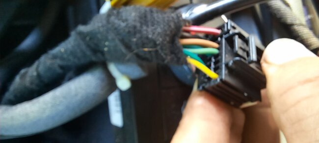

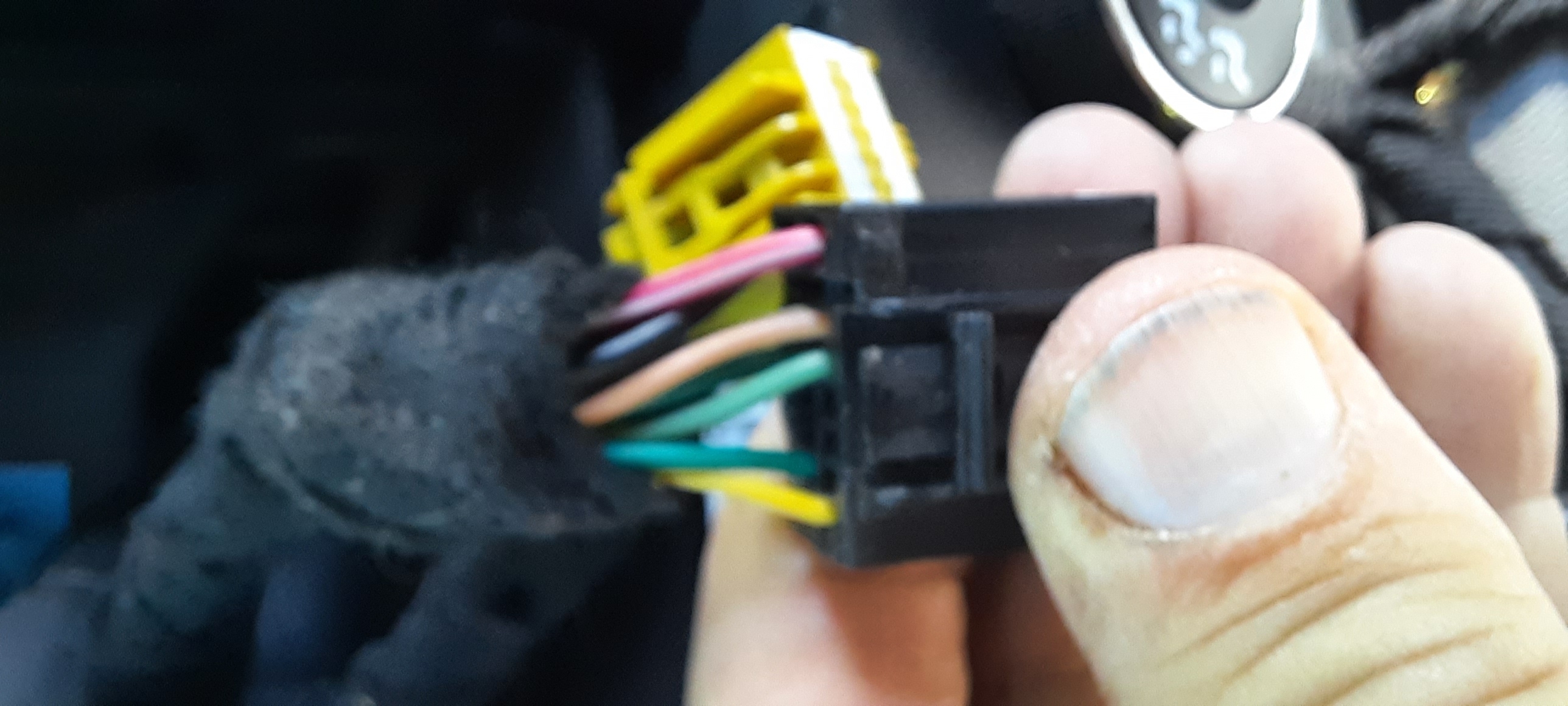

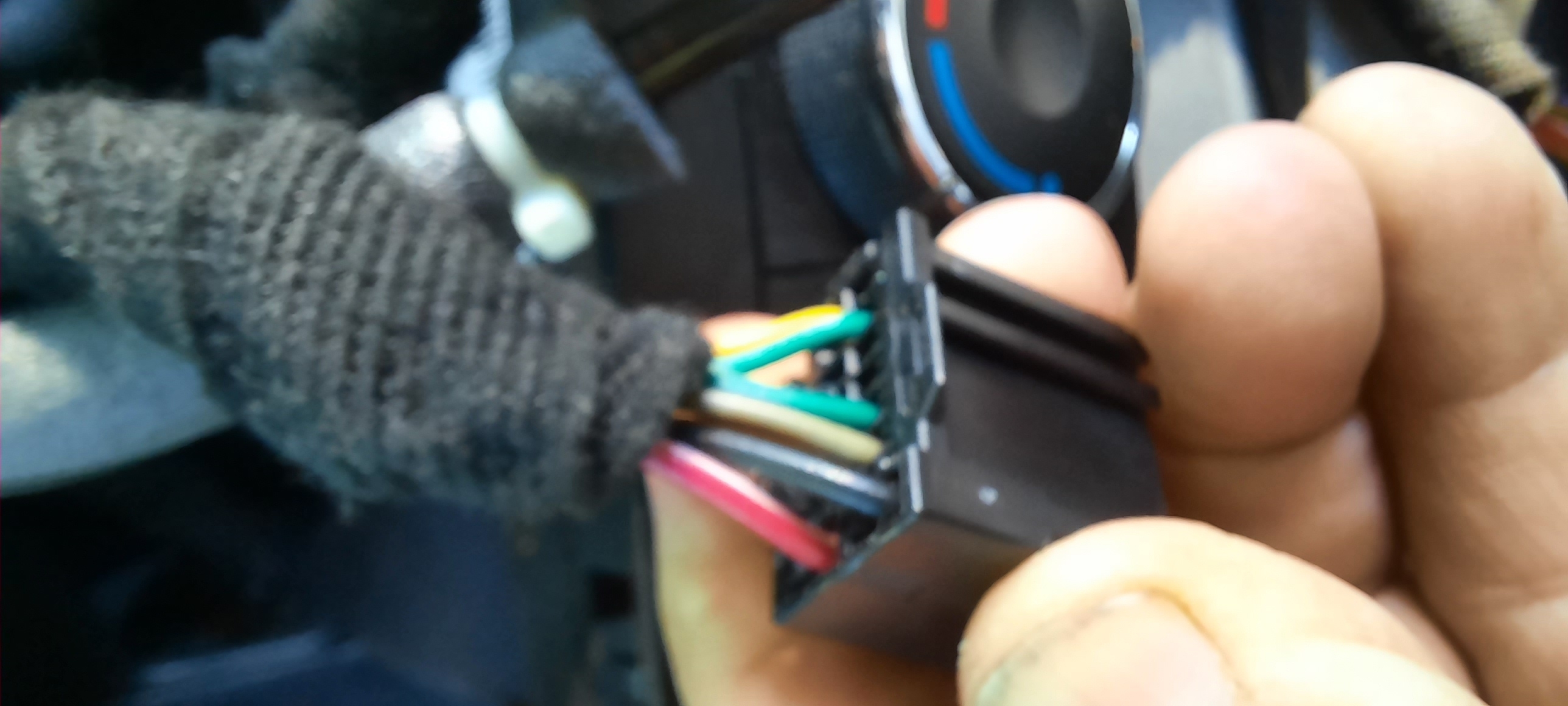

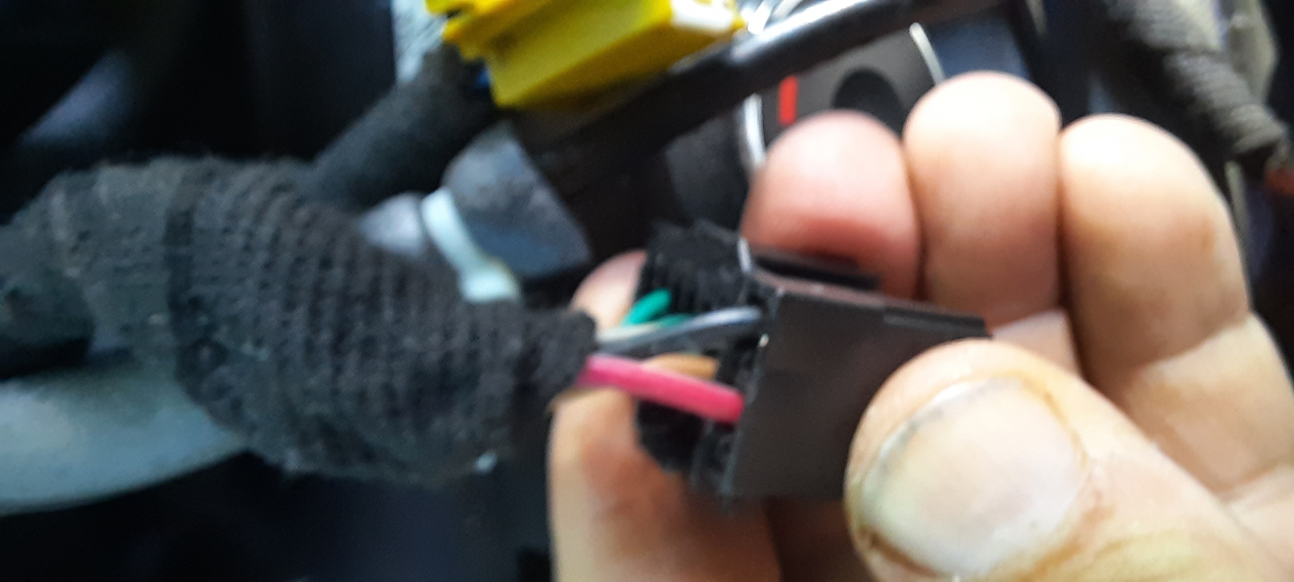

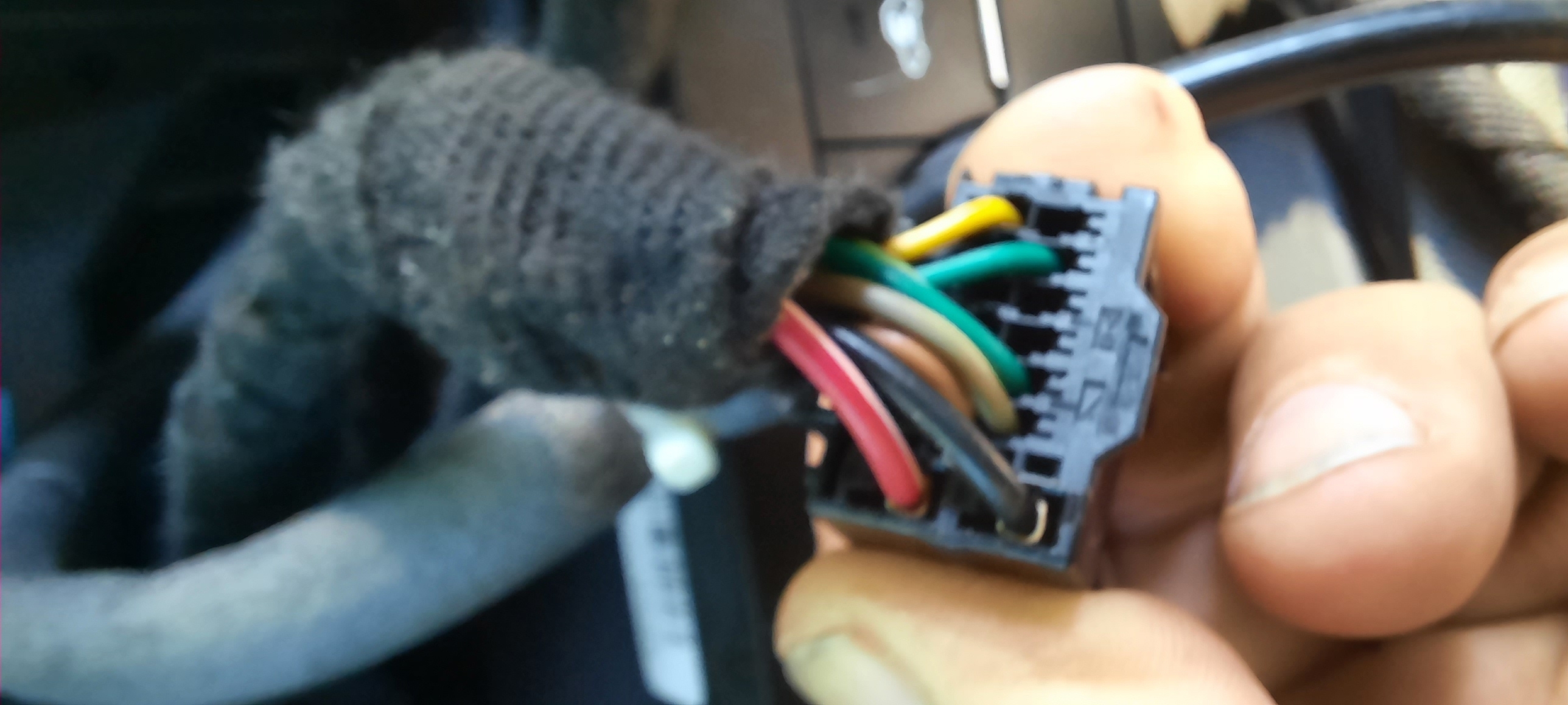

Could you tell me what these wires represent? Thank you again. 2011 GMC Sierra 1500 sl 4.8 lt flex fuel they are from back of radio.

These are out of the back of the radio, correct? You can use the wiring diagrams to see where each wire goes and what it does.
