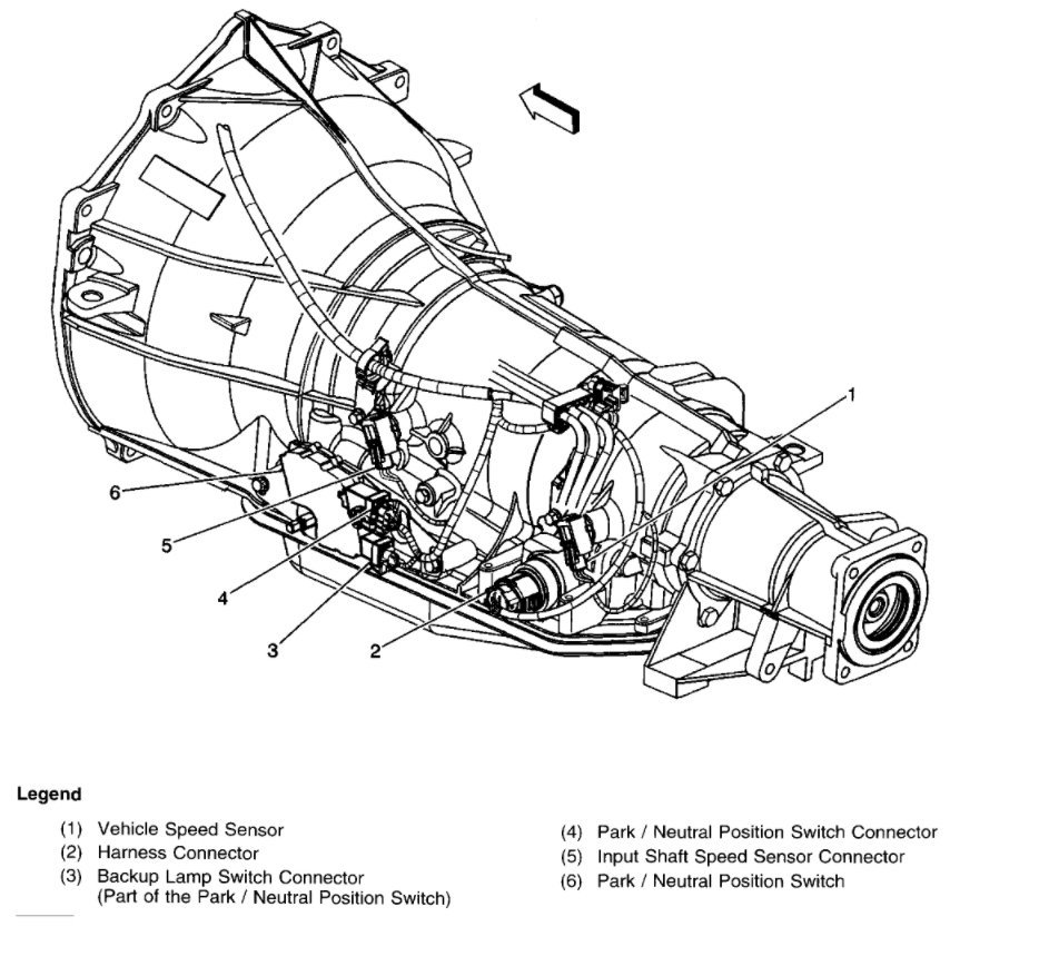

Serria will not move after replacing transmission. It will not go into any gear and the pump is pumping good. It will not move in any gear torque converter is working. I cracked a transmission line and it is pumping good.

Did you replace the gear range selector switch with the new transmission? Here is its location
These switches go out all the time.
You should also check the fuses and for trouble codes.
and
Please run some tests and get back to us so we can continue helping you.

I put a 1998 4L60E into my truck. I had to change my torque converter and bell housing and still not going anywhere. I am no mechanic and do not know what else to do. Please help me. It is the only ride. I am stumped.

You may have broken the oil pump. If torque converter was not in all the way this happens all the time. The converter is not in all the way and then transmission is put in and bolted up converter pushes against pump and breaks it. That is what is more than likely wrong. Unless low on fluid.

Put a pressure gauge where picture shows and start truck and see if you have any pressure or not. If not then drop pan and see if filter is in all the way if it is not then check for two o-rings where it goes in if no pressure then it is a bad transmission to begin with. By the way this should only take eleven quarts to fill completely so you may have too much oil in it. And actually if it was already used then it may take less.
