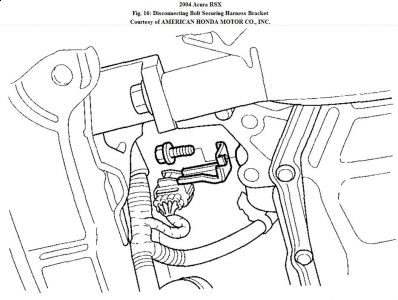

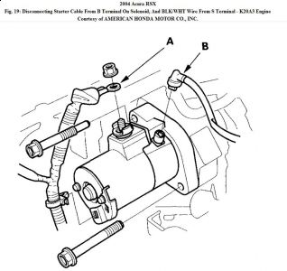

How do you replace a starter on an 04 RSX(not S type)? I can't even see it looking under the hood.

Hi jwp2000,
The starter is located at top section of transmission.
https://www.2carpros.com/forum/automotive_pictures/192750_Starter04RSXFig16_1.jpg
https://www.2carpros.com/forum/automotive_pictures/192750_Starter04RSXFig19_1.jpg
Disconnect battery negative terminal, then positive terminal.
Disconnect knock sensor connector.
Remove the bracket.
Disconnect the wires and remove the mounting bolts and starter can be removed.
