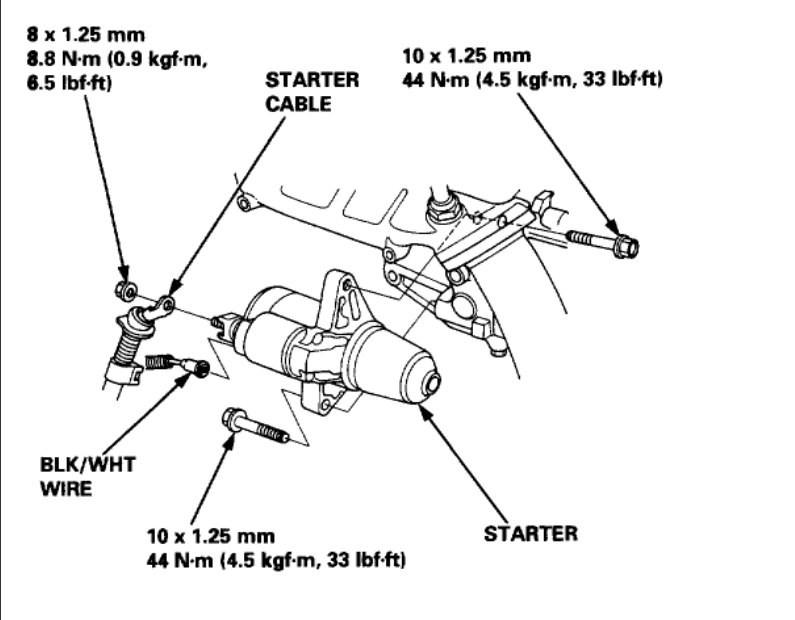

You can do it yourself, its only nuts and bolts. Here are some guides and diagrams (below) that will help you get the job done.
This is what you are in for when doing the job.

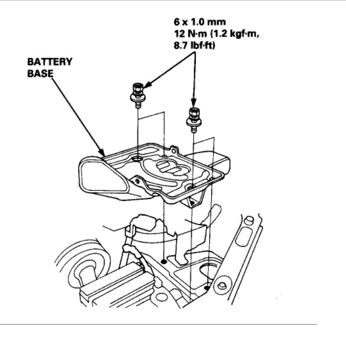

3. Raise the coolant reservoir. Remove the battery and battery base.

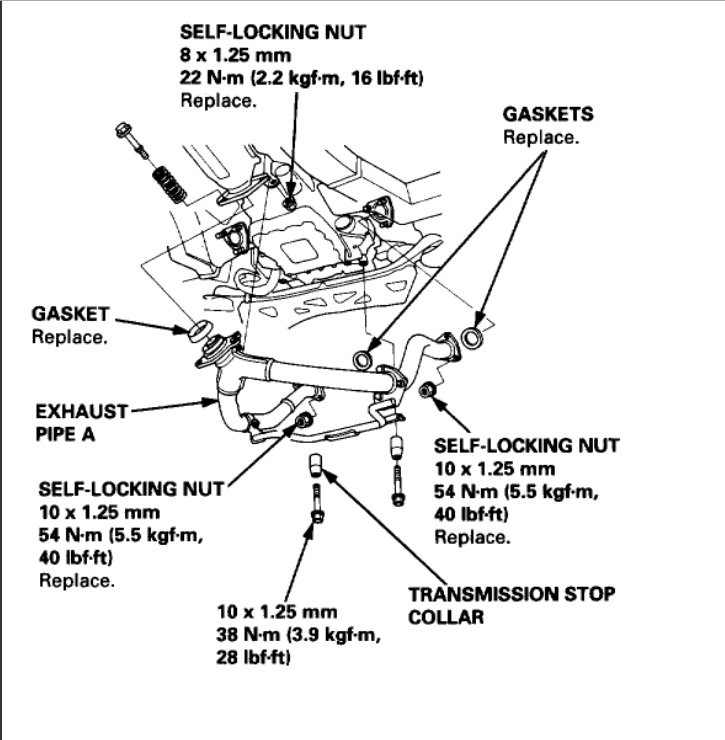

9. Remove the transmission stop collar, and remove the exhaust pipe.

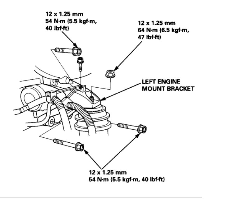

10. Remove the front mount mounting bolts.
11. Attach the chain hoist to the engine.
12. Remove the left engine mount bracket.

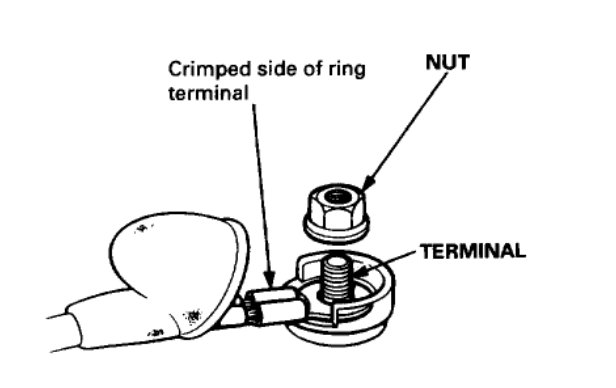

13. Disconnect the starter cable and black/white wire, remove the starter.

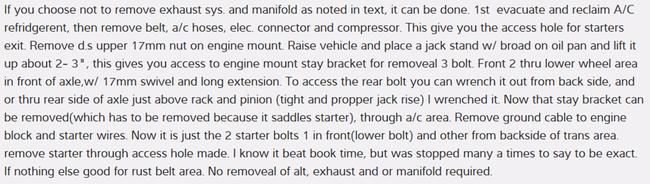

This is pretty involved replacing starter. I am sending a tip to make it easier but the a/C will have to be blown and recharged by doing it this way. You might think of having it done.
