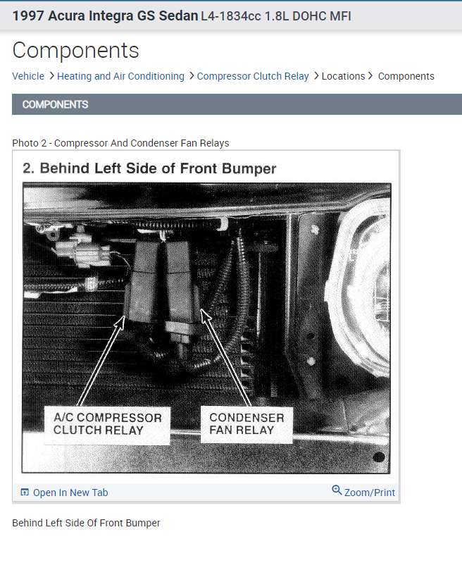

Air conditioner is not putting out cold air?

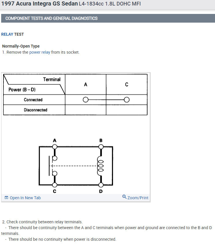

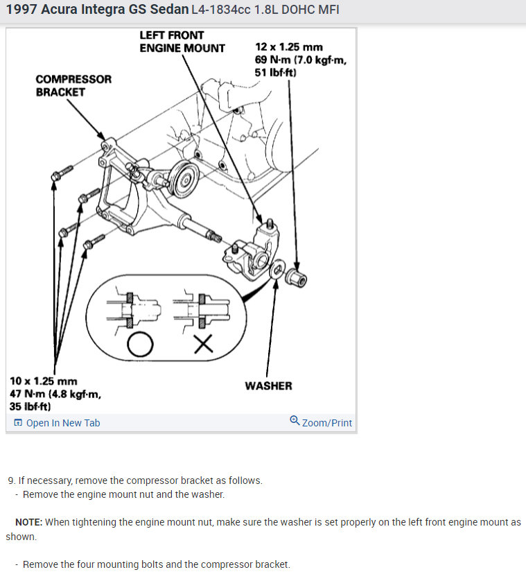

It can also be a bad relay for the compressor. The compressor relay is located under the hood just in front of the radiator (see diagram). Check the relay for corrosion or burn pins.

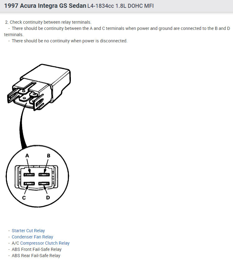

You can also test the relay:

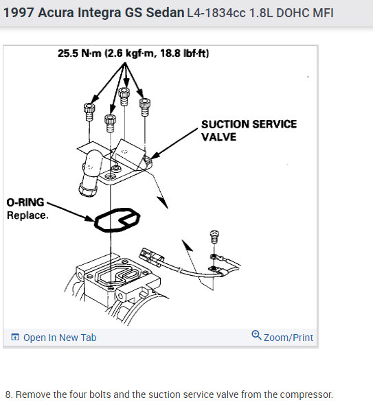

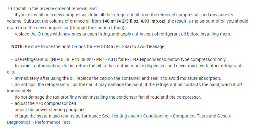

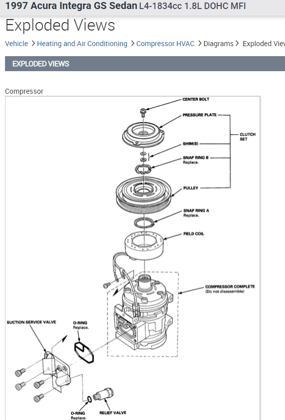

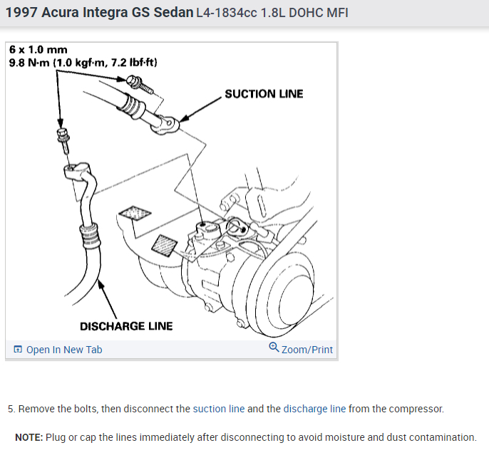

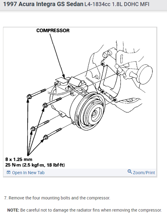

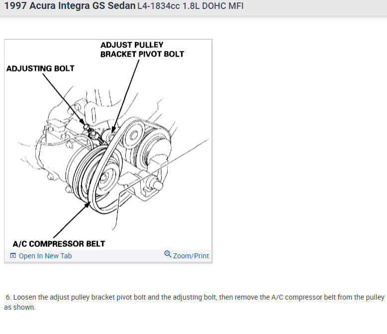

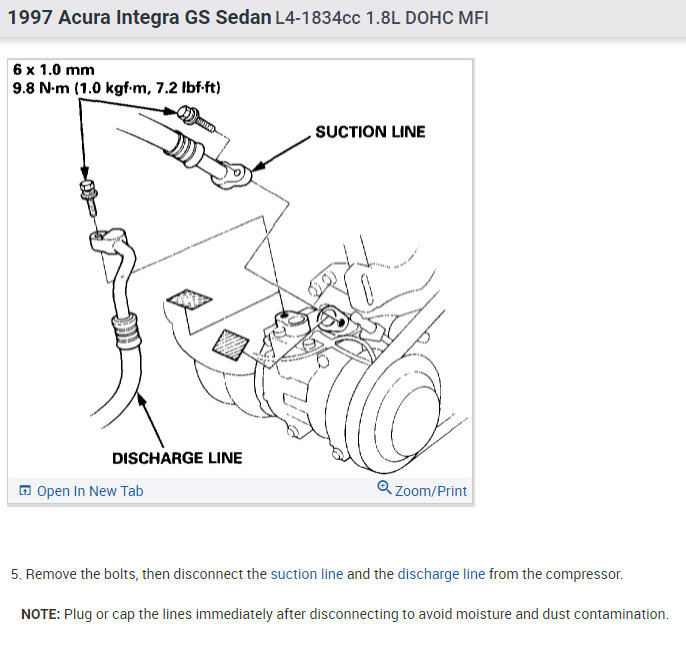

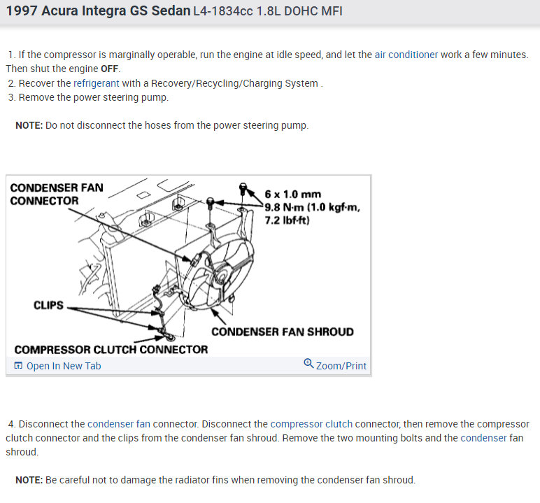

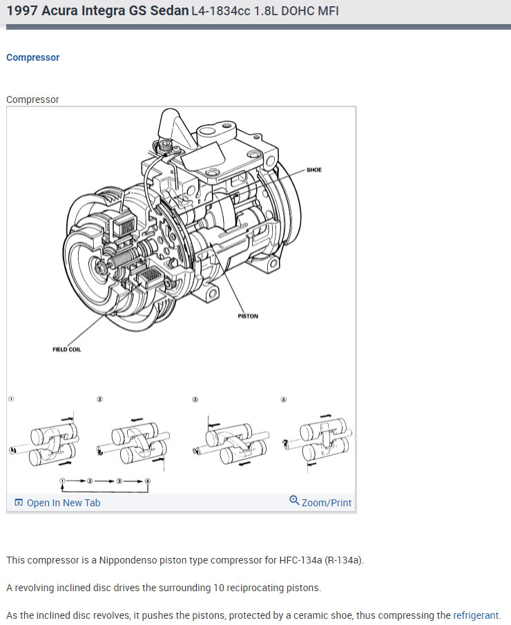

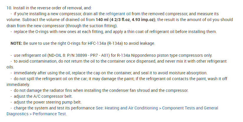

You could also have a bad A/C compressor.
https://www.2carpros.com/articles/replace-air-conditioner-compressor
