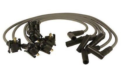

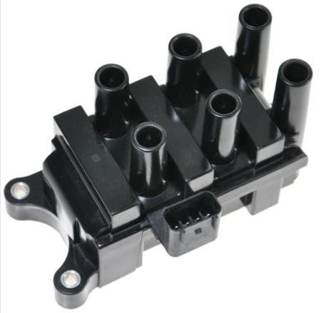

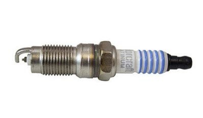

The instrument cluster codes have no bearing on engine performance. I can tell you that the most common failure on these trucks with this engine is the 1. coil 2. spark plug wires 3. spark plugs. I see it over and over again, but the best thing to start is a code retrieval from the powertrain control module (PCM). Here is a guide that can help understand the system:
https://www.2carpros.com/articles/how-to-change-spark-plugs
Thursday, December 24th, 2020 AT 8:56 AM
DONN-1
  • 24 POSTS
Hi from Donn1,
I went by AutoZone to have my codes read. They said they are not allowed into anybody's car, but I can use their code reader. I tried to use it, nothing. They said unless the check engine light is on, their code reader won't work. So I bought plug wires, plugs, and a coil. After replacing all these. The truck still drove as before, like it had water in the gas. Any other parts to try? Thanks, Donn1

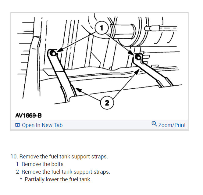

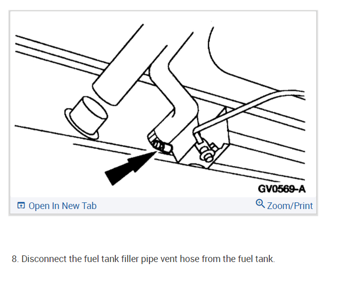

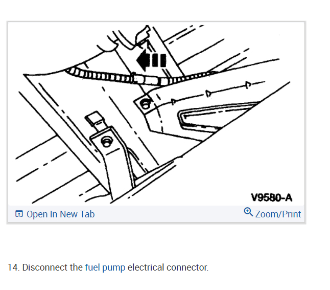

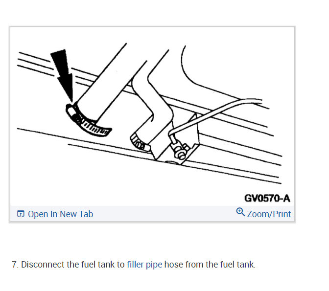

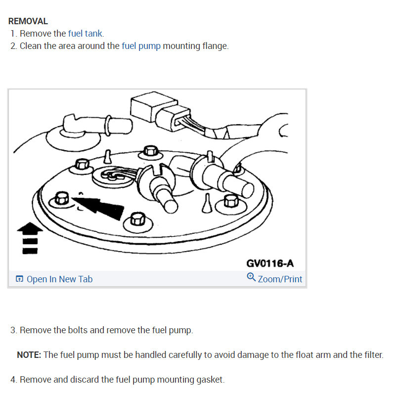

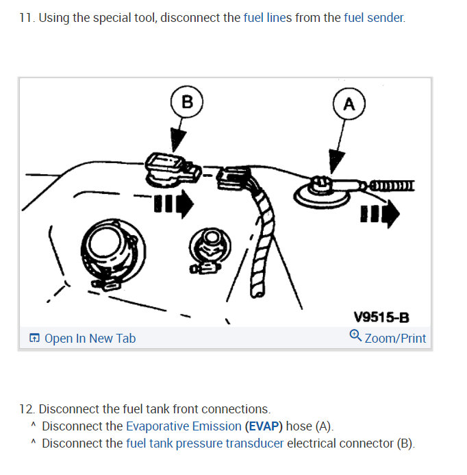

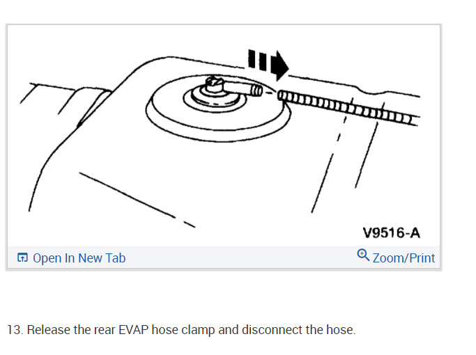

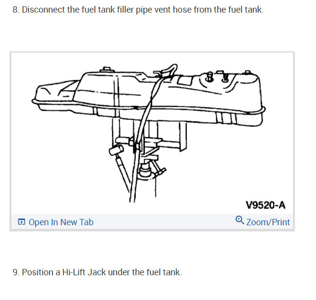

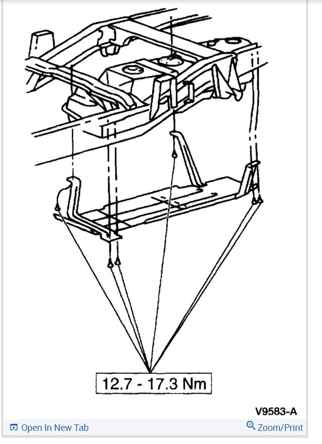

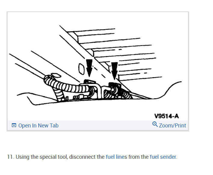

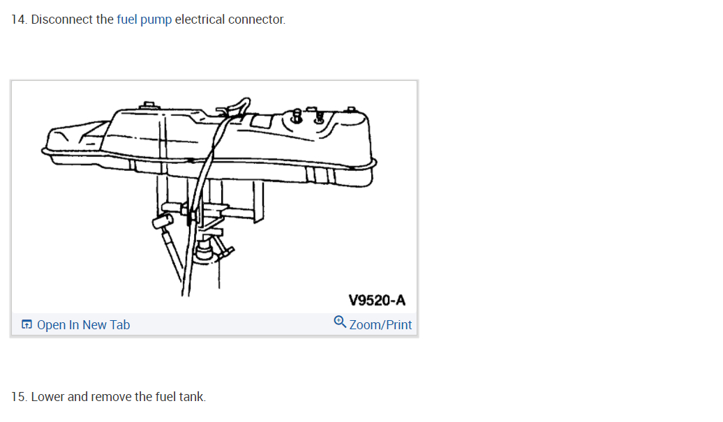

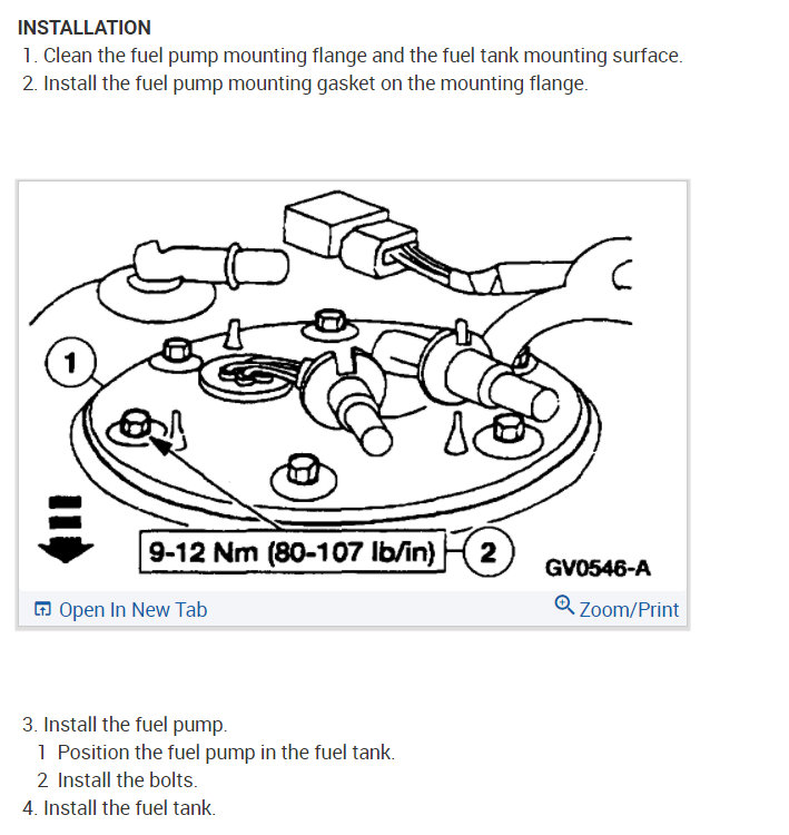

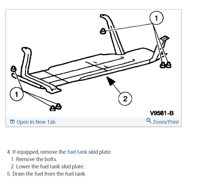

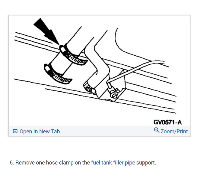

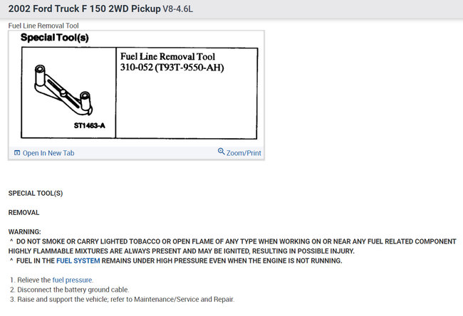

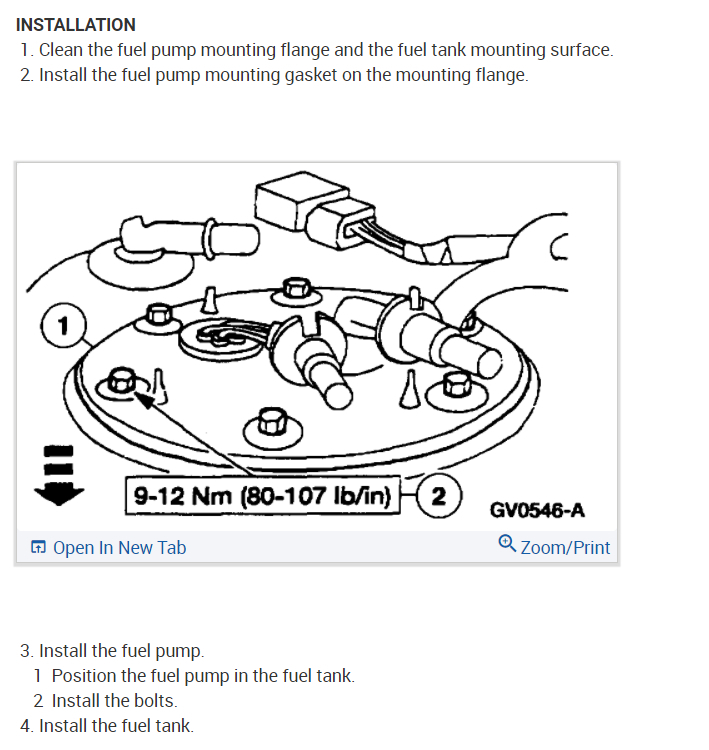

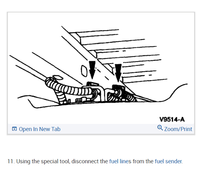

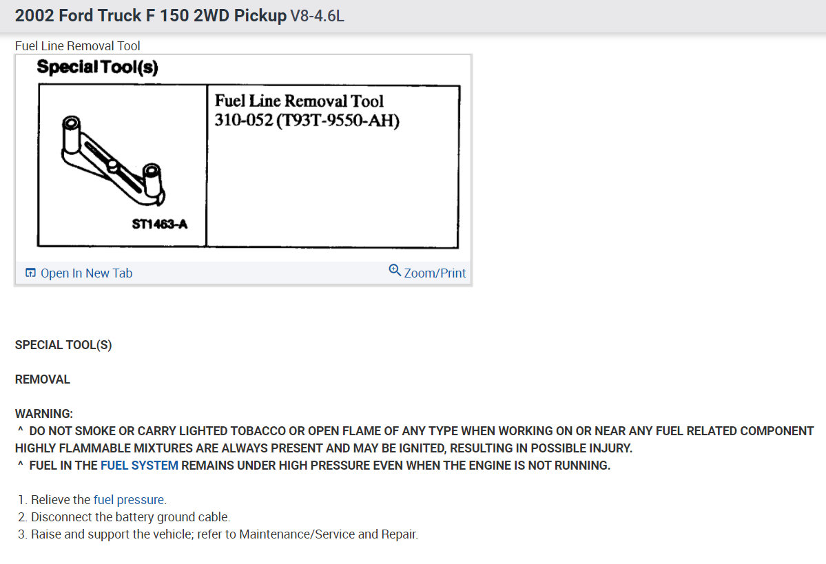

It sounds like the fuel pump is going out. here is a guide to help you step by step with instructions in the diagrams below to show you how on your car:
https://www.2carpros.com/articles/how-to-replace-an-electric-fuel-pump
Thursday, December 31st, 2020 AT 10:01 AM
DONN-1
  • 24 POSTS
Thanks for the info. I ordered a new fuel pump, I am still waiting for it to come in. Since this is my only way to go, I still drive it. There is a certain way to drive it, gas has got to be given gently. When I start it in the morning, when it is cold, it runs good but about a mile it starts to miss, after going down an incline. It doesn't miss going up a hill or incline. I rigged a fuel pump gauge up to read it while driving, it would increase slightly to 35 to 37 PSI on the pump gauge as I drove. Thanks for the help, Donn1

No problem, when the tank is out please look inside with a flashlight to make sure it is clean and without water.

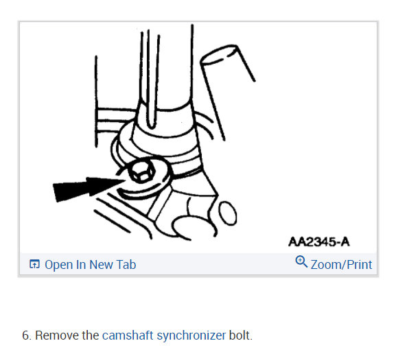

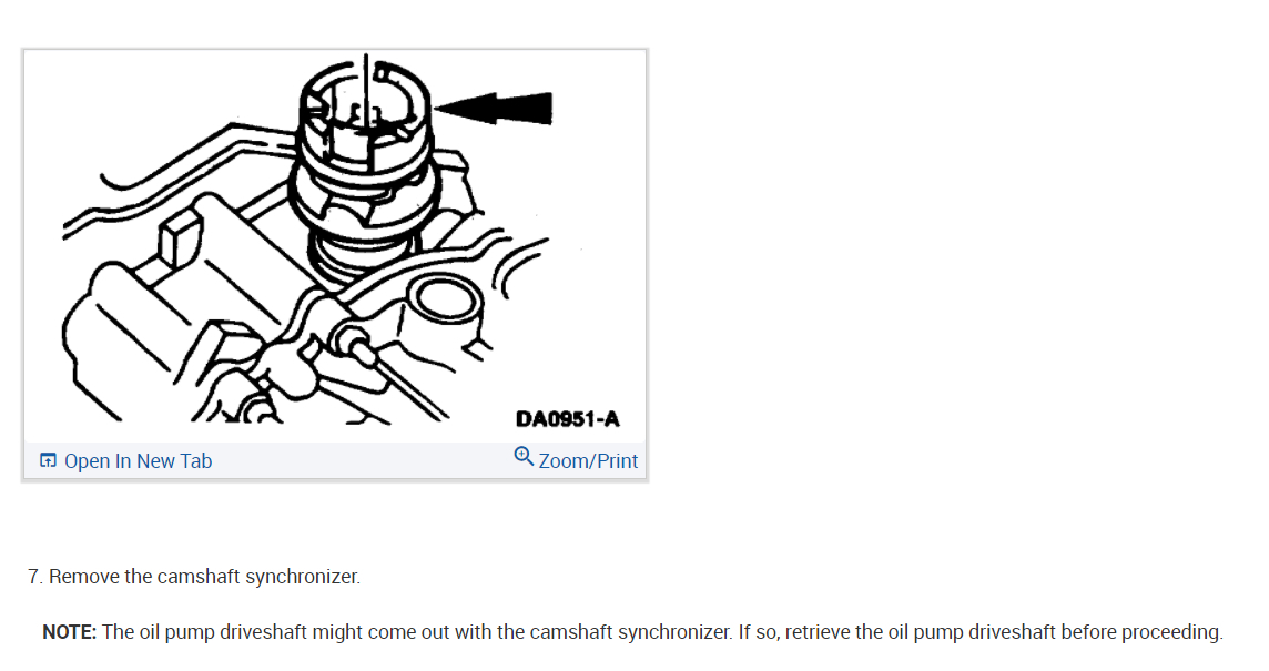

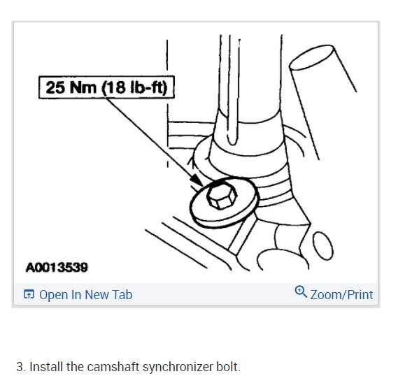

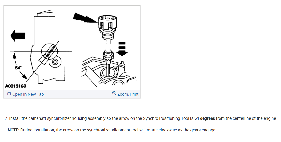

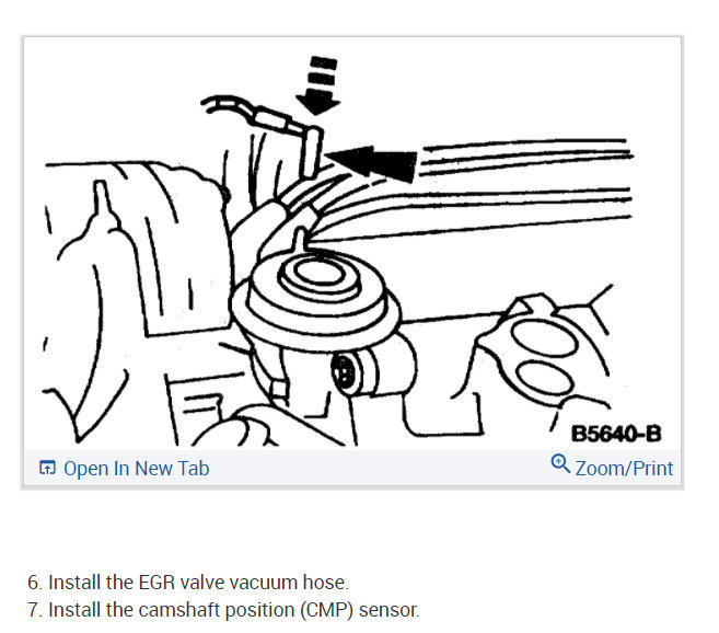

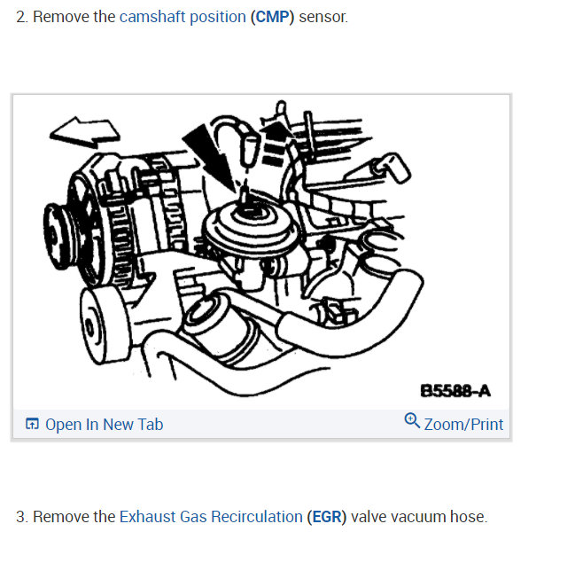

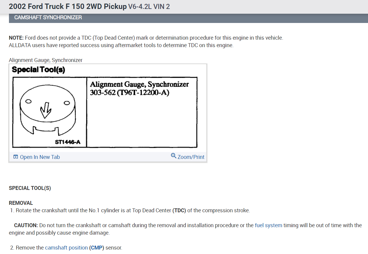

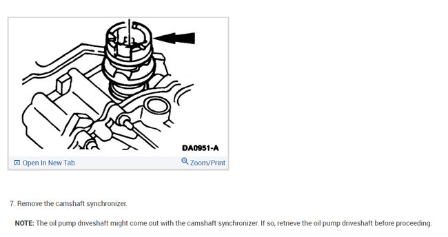

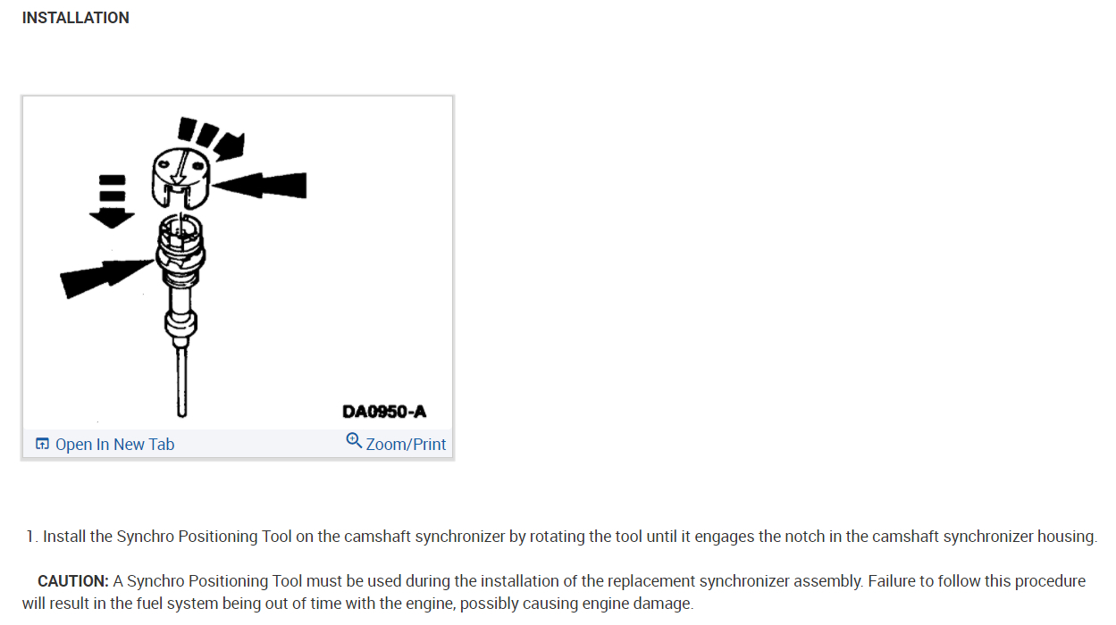

Hey Ken. Help, a family member of my wife, scanned my truck and read a bad cam sensor, well he took the sensor out and the synchronizer came out too. He didn't bring #1 up and he didn't mark the position. With it out, can I bring up #1 piston to TDC, and using an alignment tool re-install the sensor? Or can I just drop it back in without bringing up #1 TDC?
Thanks, Donn1
Tuesday, January 26th, 2021 AT 8:45 PM
KEN L
  • MASTER CERTIFIED MECHANIC
  • 55,371 POSTS
Did you mark the synchronizer before you removed it? If not then you will need to put the engine on TDC and then align the synchronizer. Here are the instructions. Check out the diagrams (below). Please let us know what happens.
Wednesday, January 27th, 2021 AT 10:21 AM
DONN-1
  • 24 POSTS
I followed the advice, and the truck runs good, if it is off, would it set a code? How would it run, if set wrong?
Thanks, Donn1
Wednesday, January 27th, 2021 AT 5:58 PM
KEN L
  • 55,371 POSTS
It would set a code and the the engine will ping or have low power if the synchronizer was off.
Friday, January 29th, 2021 AT 10:20 AM
DONN-1
  • 24 POSTS
Thanks for the reply. Also the problem with my truck that acted like water was in the fuel tank, actually, it was the cam sensor that caused this. Thanks, Donn1
