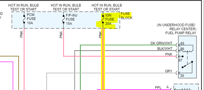

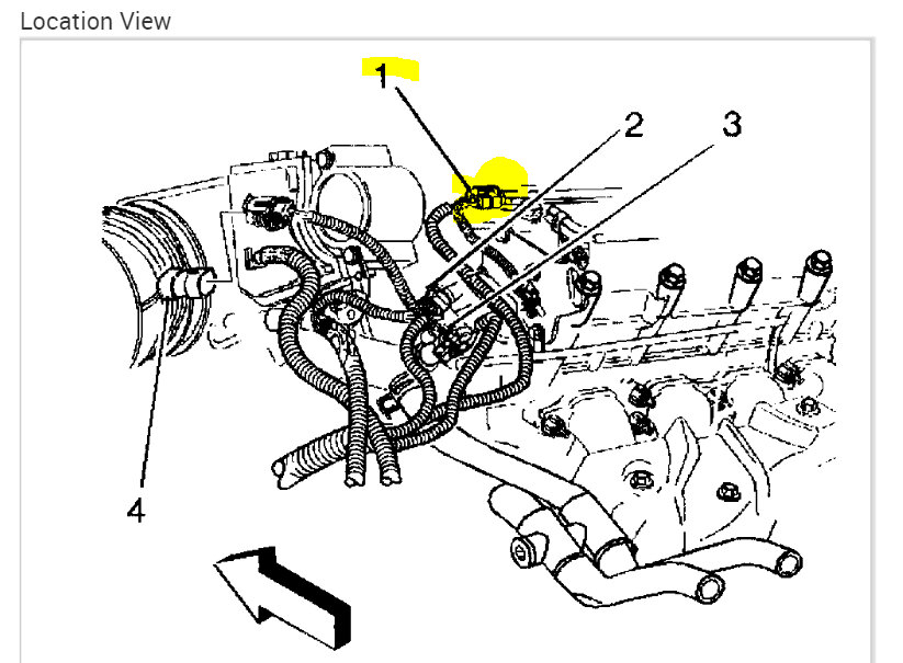

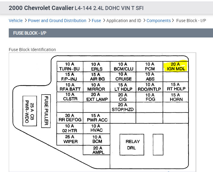

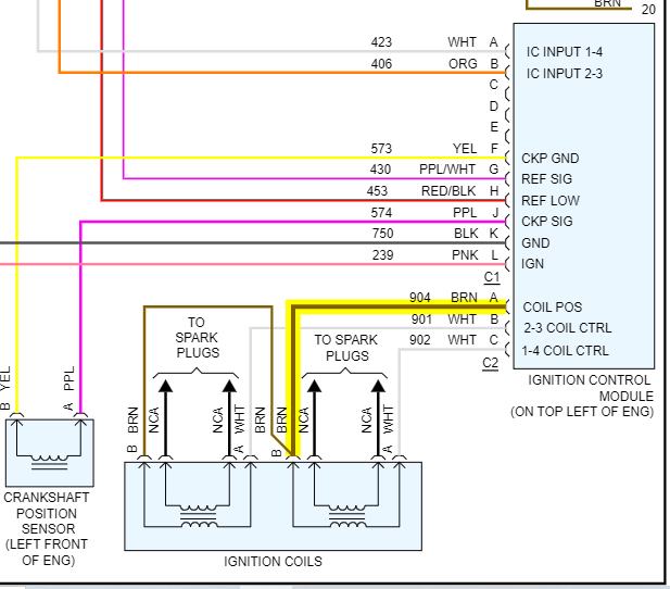

  • 110,192 POSTS
Keven,
Do you have access to a live data scan tool? If possible, check to see if there is an RPM signal when cranking the engine.
If you don't, first check the ignition fuse in the fuse block. Make sure if the fuses are good, you also confirm there is power to and from it.
If that is good, then with the key on, check the brown wire that goes to the coils. It should have 12v with the key on.
Let me know what you find.
See pics below. Pic 3 shows the wiring for the ignition control module and pic 4 is the fuse to check under the dash.
Sunday, October 30th, 2022 AT 6:58 PM
