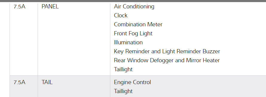

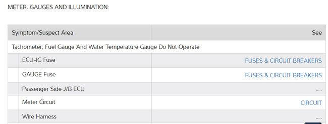

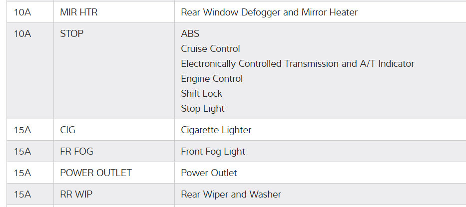

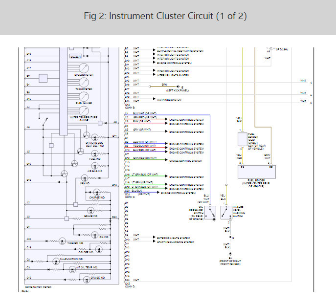

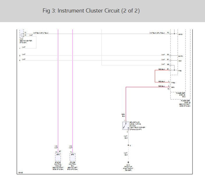

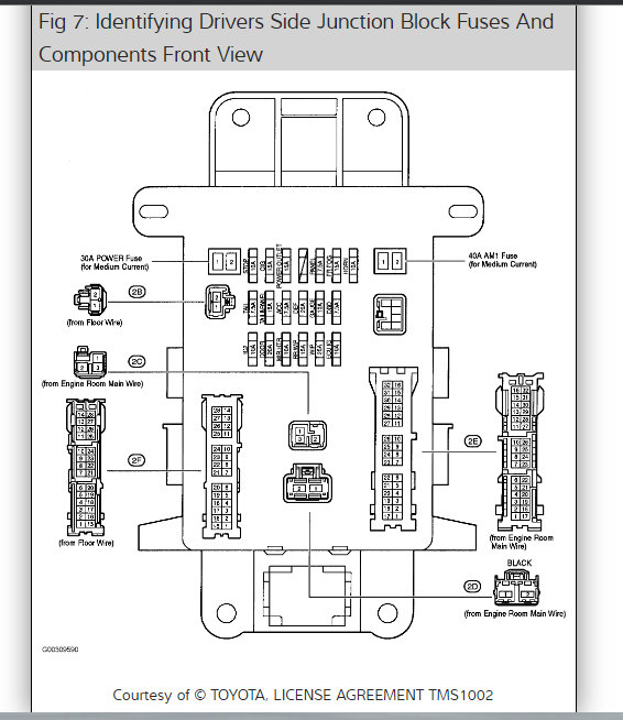

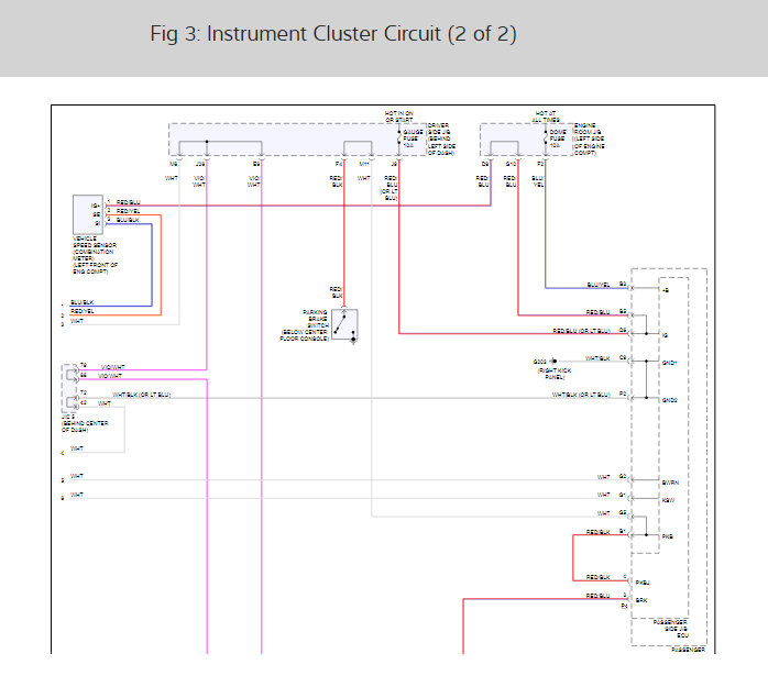

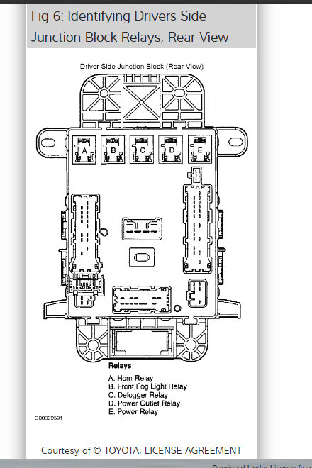

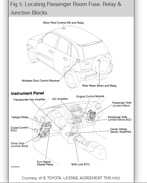

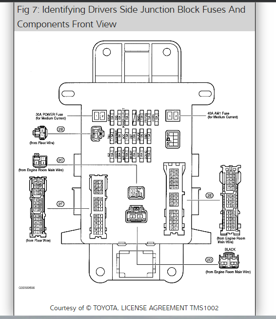

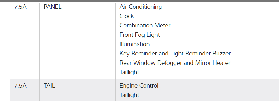

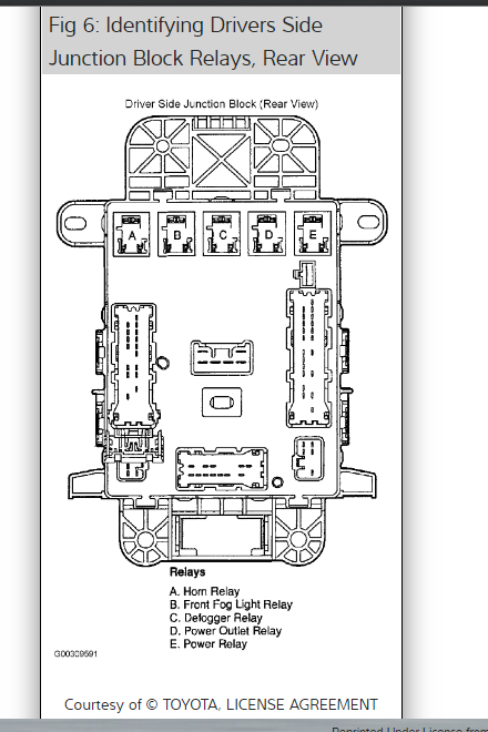

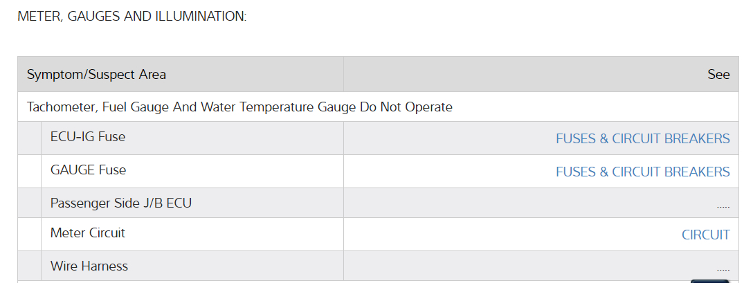

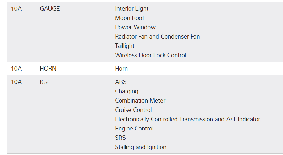

While jump starting my car I briefly crossed cables. Corrected the cables, car starts and runs but have no power to the dash gauges and the lights. checked fuses and replaced two bad ones but still nothing.. is there a main fuse and where would that be located? thank you
Aug 19, 2019 at 4:03 AM
SCGRANTURISMO
  • CAR REPAIR CONTRIBUTOR
  • 4,897 POSTS

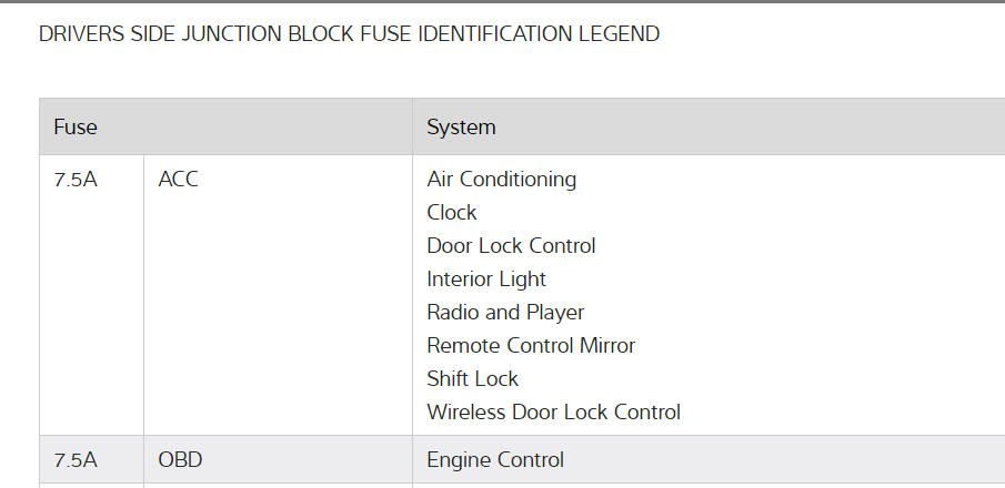

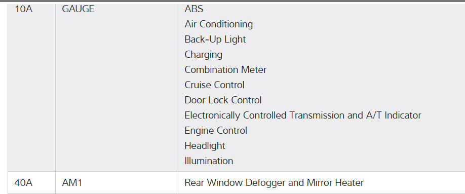

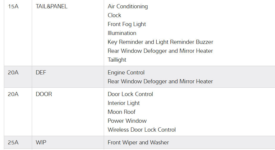

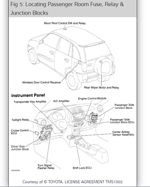

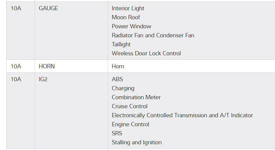

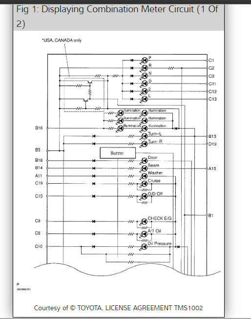

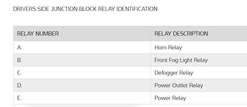

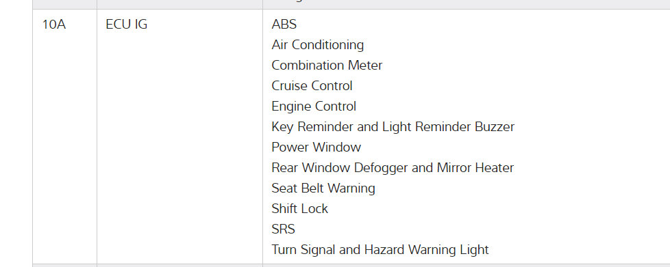

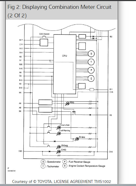

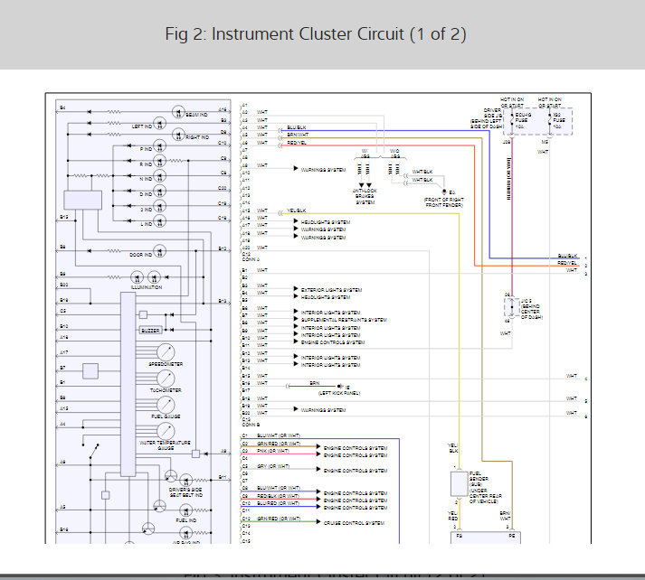

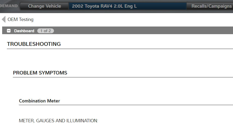

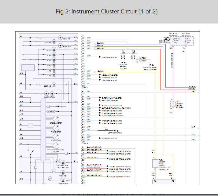

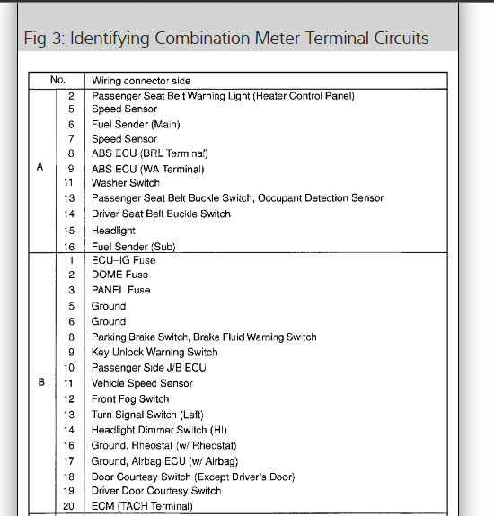

Okay, in the diagrams down below I have included wiring diagrams for the instrument cluster, Fuse Box diagrams and callouts, and factory diagnostic troubleshooting guides for the instrument panel in your vehicle. Please go through these guides and get back to us with what you are able to find out. You will need to do a couple of things to do these tests, so I have included links for each of these down below for you.
Thanks,
Alex
2CarPros
