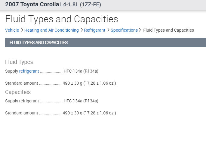

Hello
can you tell me the AC refrigerant capacity for my car.
Sunday, October 2nd, 2022 AT 4:16 PM
SQM
MECHANIC
6,383 POSTS
The complete refrigerant capacity is 17 ounces (+/_ 1 ounce), see attached.
