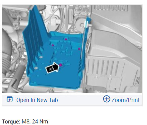

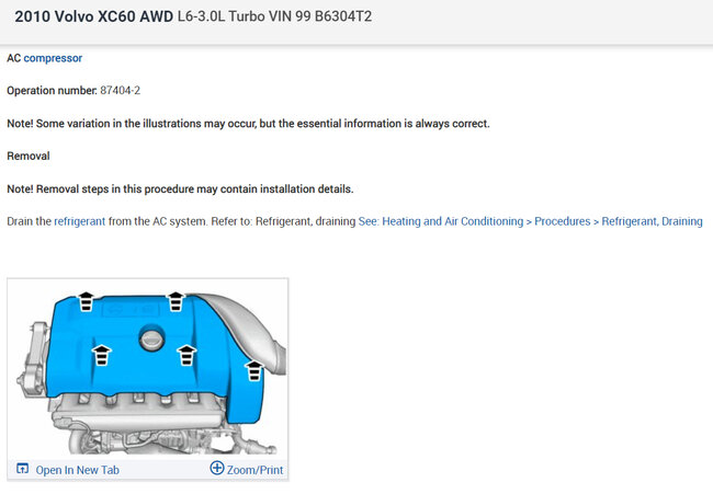

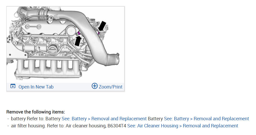

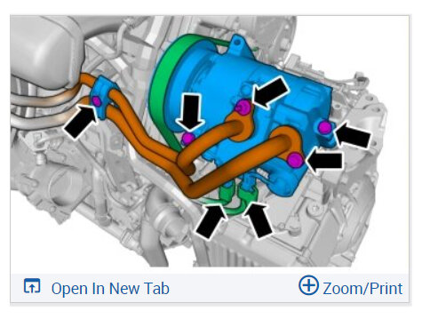

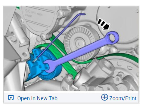

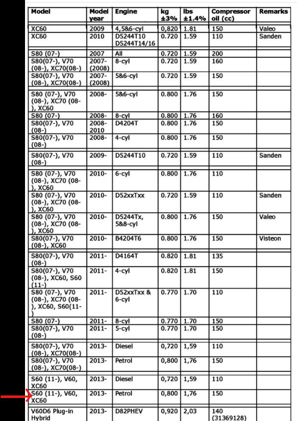

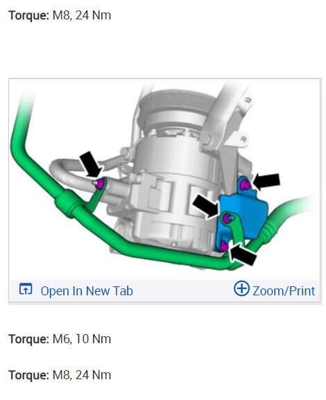

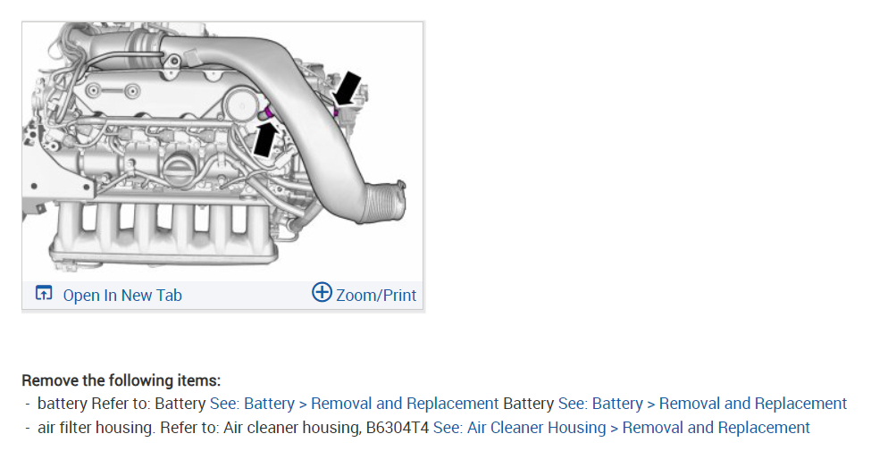

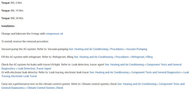

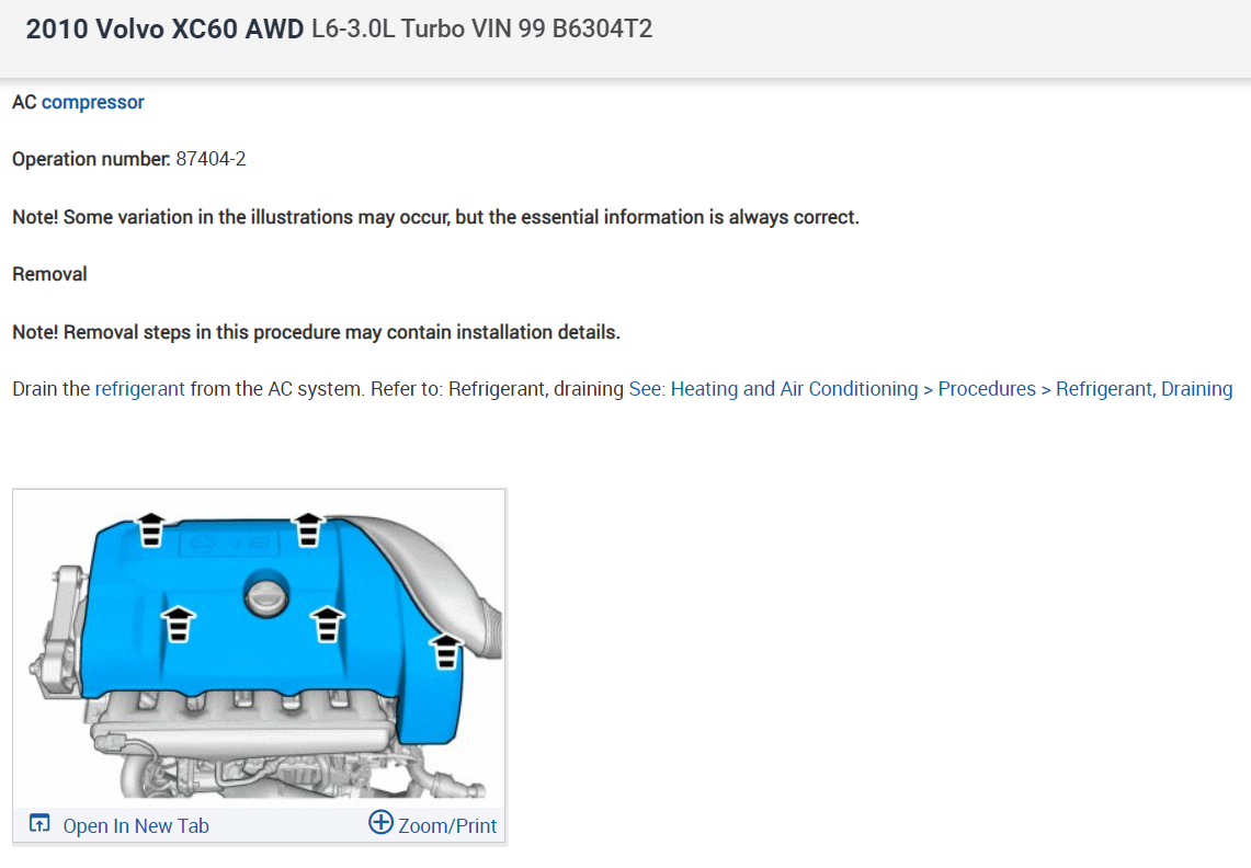

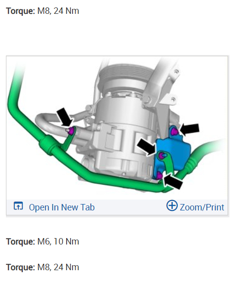

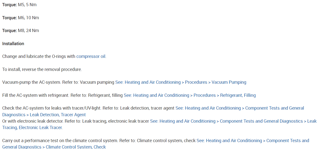

Yep, it looks like the A/C compressor is going out, the high side is too low. How much refrigerant is in the system? There should be 1.7 pounds.
Here is how to change the compressor out with instructions below for your car:
https://www.2carpros.com/articles/replace-air-conditioner-compressor
Check out the images (below). Let us know how it goes.

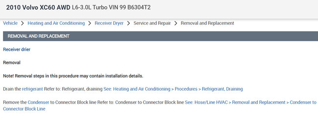

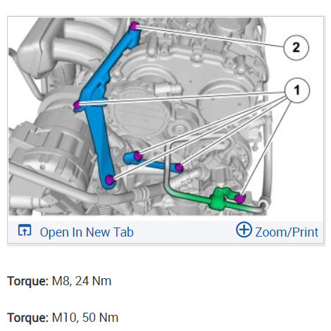

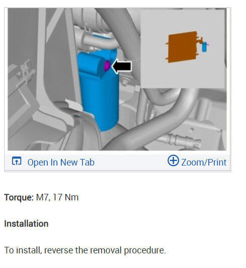

Thanks! Is it important to change the drier of any other components when installing the new compressor?
Monday, June 24th, 2024 AT 9:41 AM
KEN L
  • MASTER CERTIFIED MECHANIC
  • 55,488 POSTS

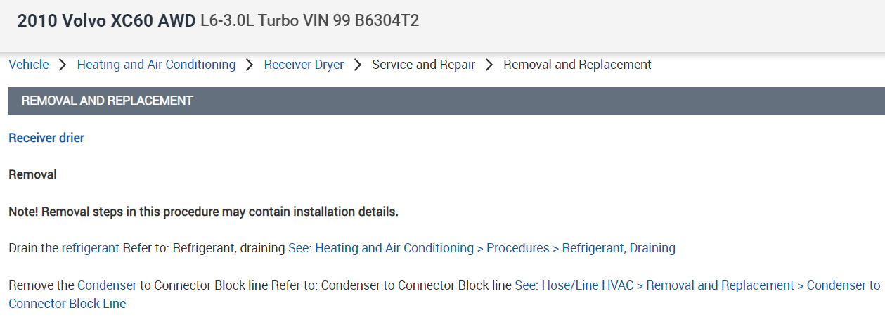

Yes, it is, sorry I should have mentioned that. Here is the location, check out the images (below). Let us know how it goes.
Monday, June 24th, 2024 AT 10:19 AM
YK16
  • 40 POSTS
Any idea how I get to that?
Monday, June 24th, 2024 AT 10:21 AM
YK16
  • 40 POSTS
Replace expansion valve as well?
Monday, June 24th, 2024 AT 10:23 AM
KEN L
  • 55,488 POSTS
Yep, the receiver dryer can be tough to get to, I would open the system after the refrigerant has been removed and see what it looks like, there are two ways a compressor with stop working, messy and not. I other words are the compressor seals spread throughout he system or is the system clean inside, this will determine if you need the expansion block or not. You can upload an image or video of the inside tubes once apart so I can tell.
