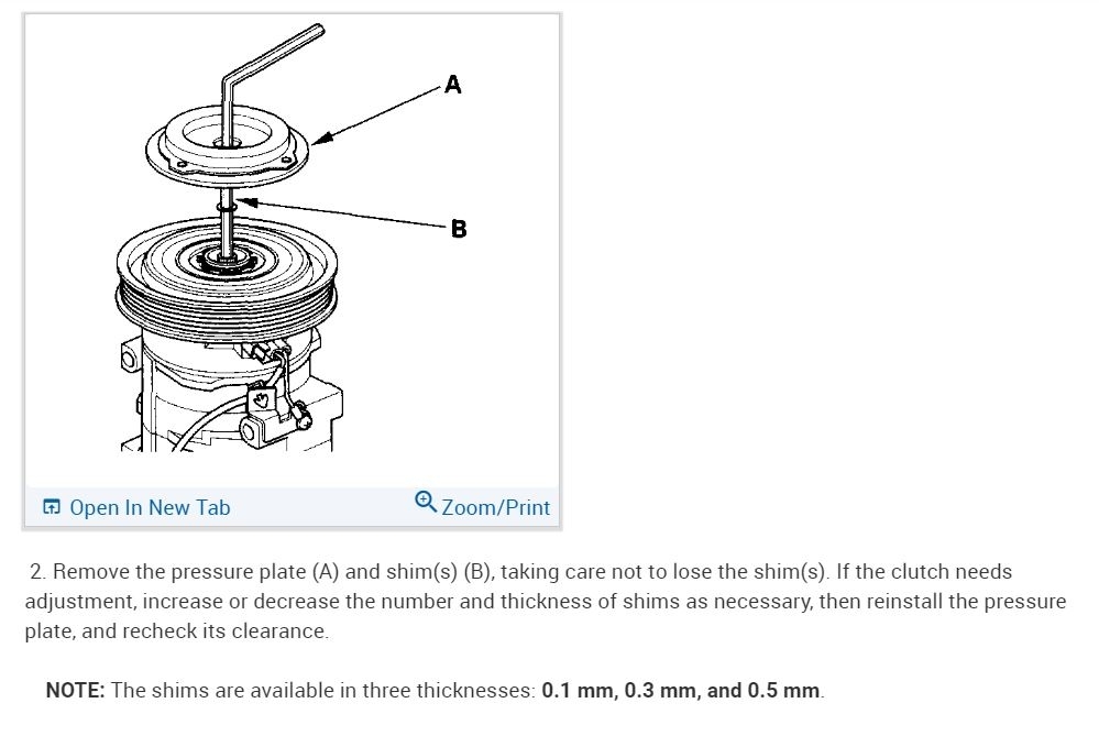

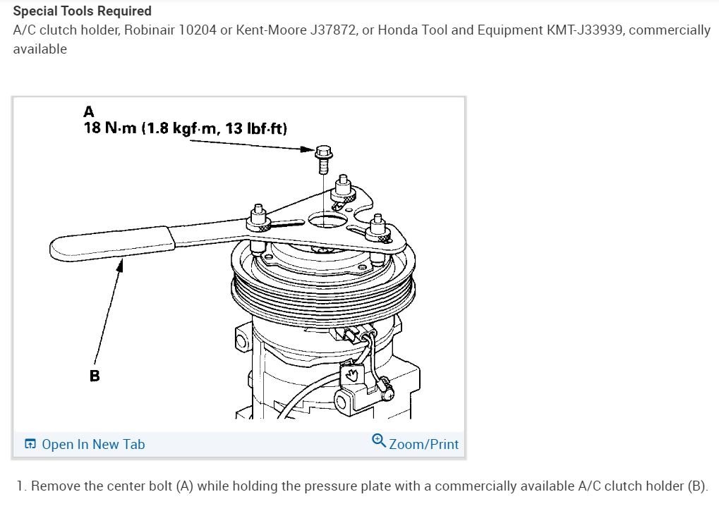

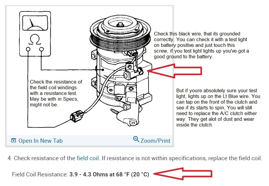

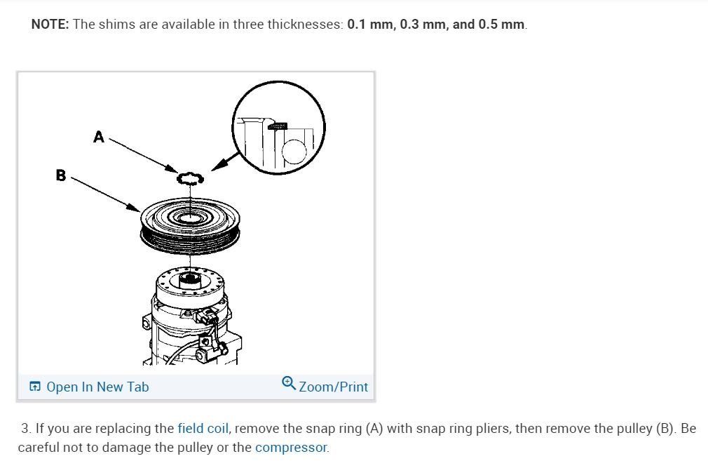

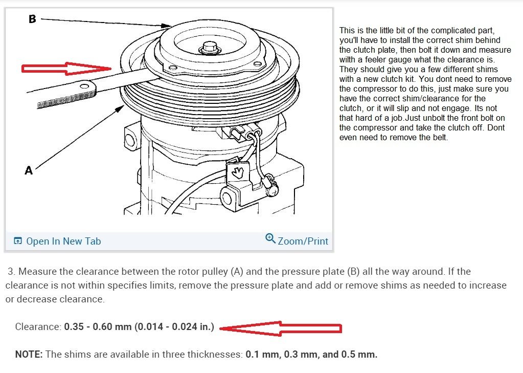

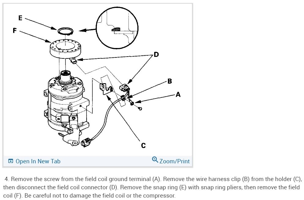

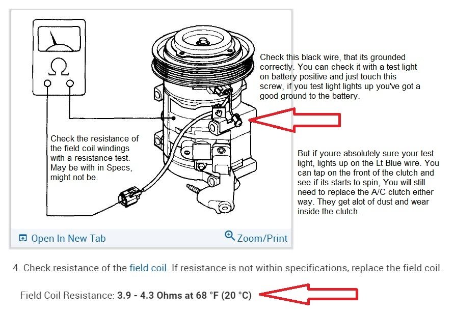

Replaced it with an Acura sensor and the harness connector. The display now reading okay, but compressor not kicking on. Tested the blue light while disconnected and it has power. So pretty much the compressor clutch? I seen people replacing just the clutch while compressor is still on the car, have you done that before?
Wednesday, August 5th, 2020 AT 2:14 PM
AL514
  • 5,584 POSTS
Yes, you can replace the clutch without even taking the belt off. Here are some diagrams with instructions on the proper shim and clearance. Try tapping on the clutch and see if it will free up, you will still need a new one though. As long as your powers and grounds are good, it should turn.
Wednesday, August 5th, 2020 AT 3:04 PM
NASER NASER
  • 836 POSTS
Yes, tried tapping then and nothing worked, but I think belt needs to come off as the clutch is behind the pulley. The one with the electrical connector.
Wednesday, August 5th, 2020 AT 3:09 PM
AL514
  • 5,584 POSTS
Yup you're correct, the belt does need to come off. Here's the instructions from All Data for A/C clutch replacement procedure.
