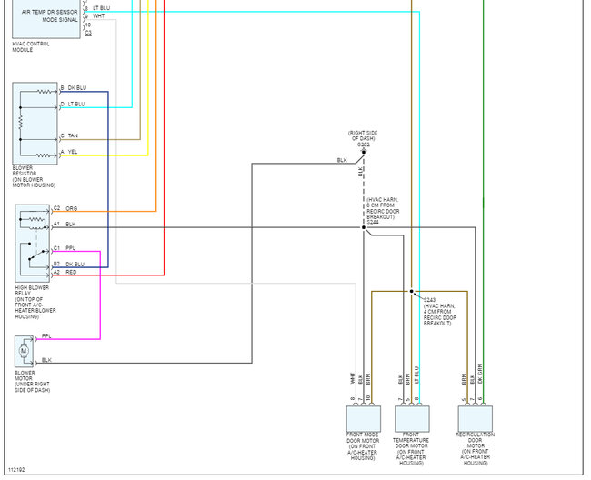

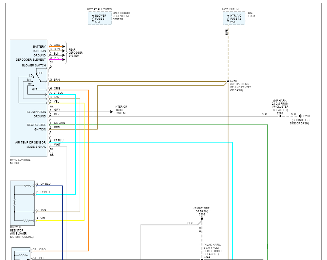

Changed the control module and the actuator and still no heat. Took actuator off and manually moved the blend door and it blew very hot. Checked actuator for movement and it moves but not much. Also, I can't get the actuator opening to match the angle of the blend door mount. Shouldn't one turn to match the other so it can be slid on?

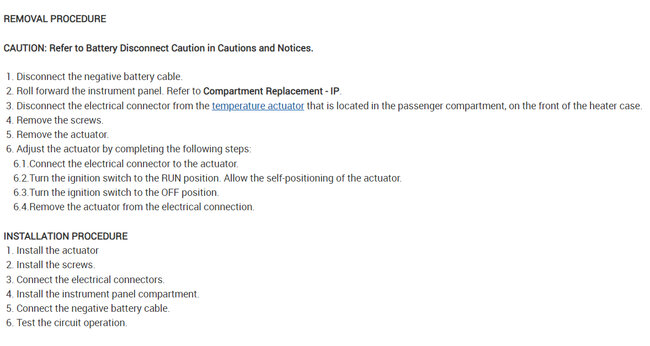

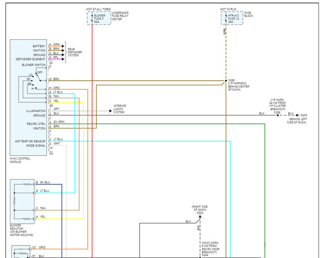

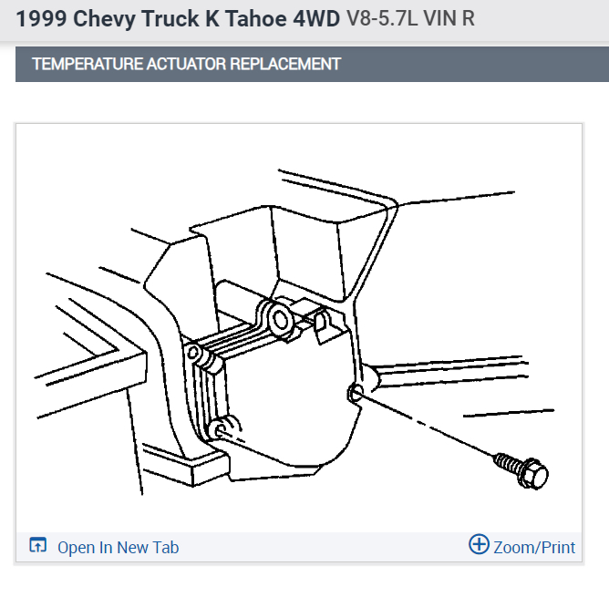

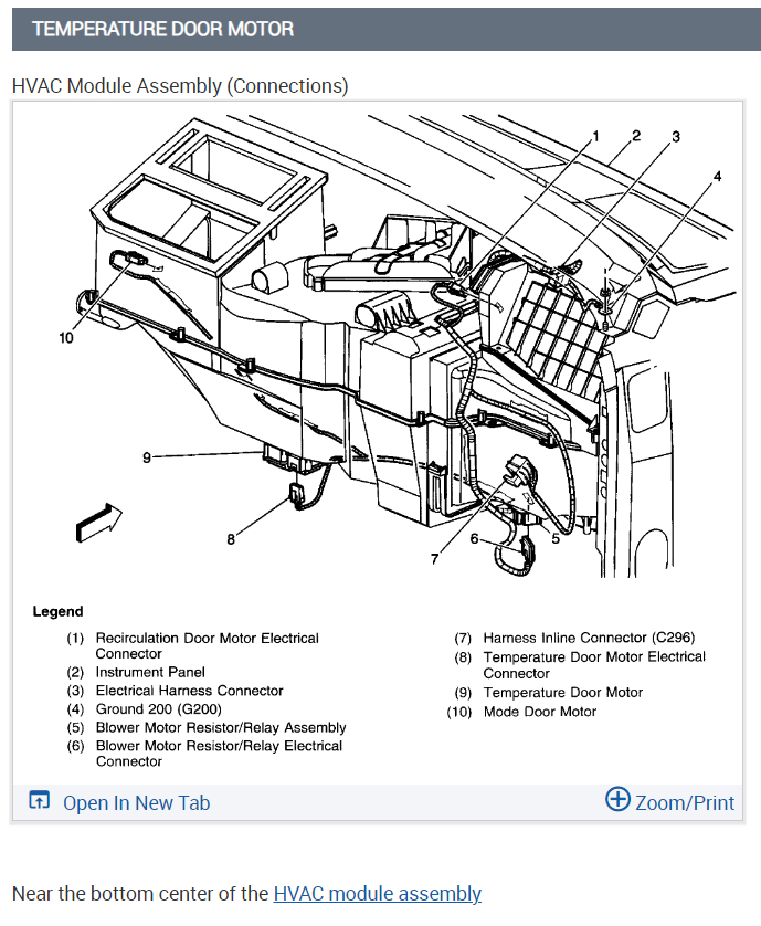

Thank you for that but we don't have anyone close to TX. Can I ask how you got the actuator installed if it does not line up? Here are the instructions on how to replace it. Also, did you check the HTR- AC fuse in the fuse panel? Here is a wiring diagram for the actuator so you can test the connection between the actuator and the HVAC controller.
Check out the images (below). Let us know how it goes.

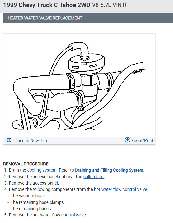

Changed out the blend door actuator under the dash through the cigarette lighter and changed the heater valve and solenoid under the hood and now works fine.

I am glad you got it fixed, so the blend door actuator has bad again? Here is the heater valve he replaced to fix the problem.

I had the correct actuator. I just didn't know the proper sequence to align the actuator with the blend door shaft so it would properly align and then calibrate.
