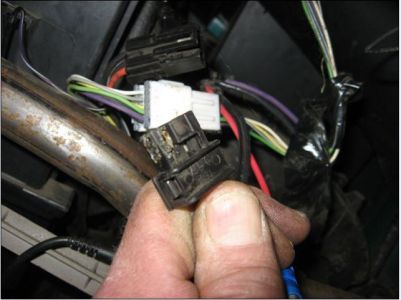

ADIOS2U
  • 1996 CHEVROLET SILVERADO
There are four settings on the fan all work except high side. Replaced switch and relay. But five minutes into running on high it started to cut out like there might be a short in the system. Can you tell me if this is a common fault in this series of trucks?
Friday, April 30th, 2021 AT 3:25 PM (Merged)
BLUELIGHTNIN6
  • 16,542 POSTS
Hello and thanks for the donation!
There is a common issue with this year's HVAC fan only working on the Low & Medium speeds. There should be a 2 or 3 wire cannon plug in-line between the blower relay and the 50-Amp fused circuit from the underhood fuse / relay box. This plug and another share a niche rolled up in adhesive foam in the vicinity (top of airbox, right of the relay) . This plug commonly burns up and fails.
(SNAPSHOT OF FAILED PLUG)
https://www.2carpros.com/forum/automotive_pictures/261618_Noname_726.jpg
-1
