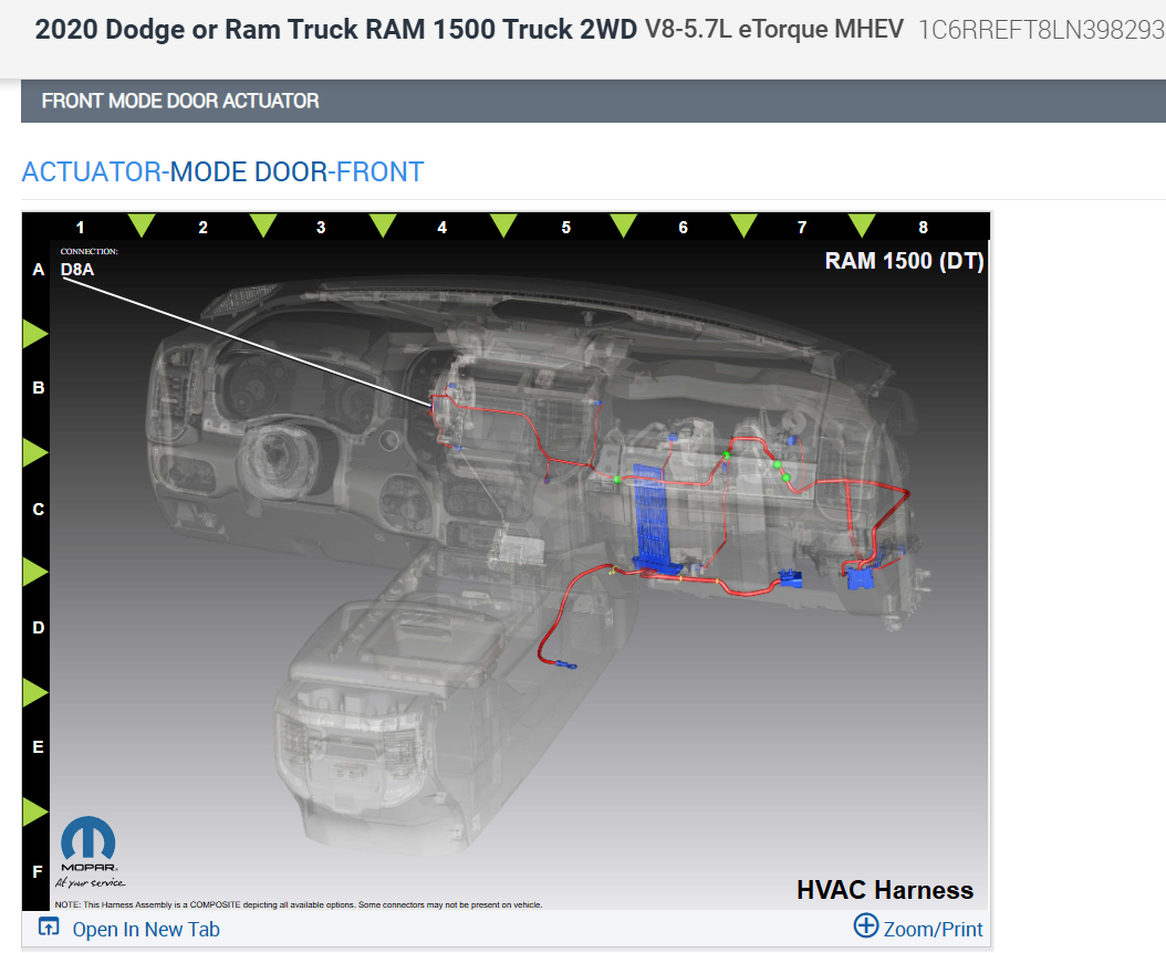

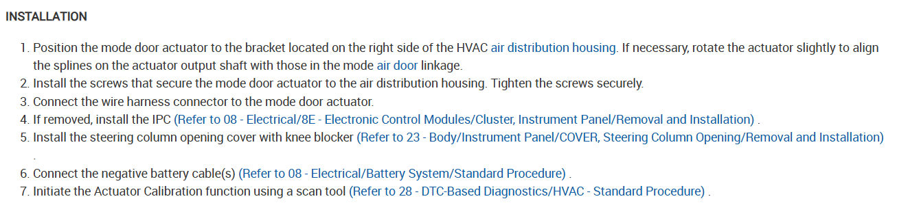

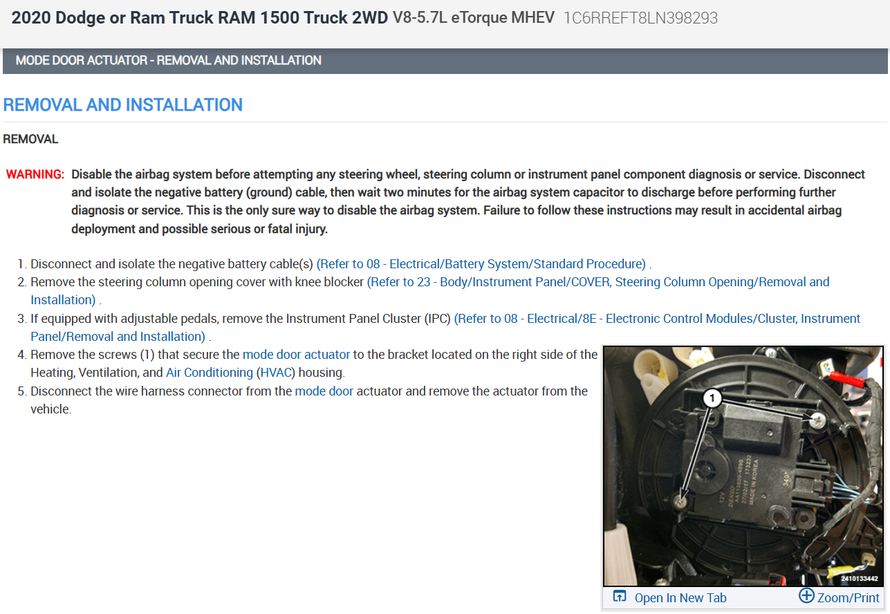

After replacing the blend door, the A/C controls do not turn off the front vents?

I see the truck is a hybrid. Here are the instructions for the blend door and the linkage, this should help. Check out the images (below). Please let us know what happens.
