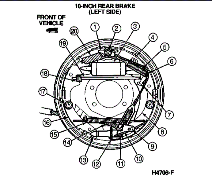

There is no ABS light on. Replaced rear speed sensor still the same.
Tuesday, October 6th, 2020 AT 11:05 PM
MECHANIC
52,796 POSTS
Good morning,
Did you check the basics first? I would check the shoes and the drum and make sure the E brake cable is not partially applying the brake.
https://www.2carpros.com/articles/how-to-replace-rear-brake-shoes-and-drums
This does not sound like an ABS issue at all. If it was, the light would come on.
https://www.2carpros.com/articles/abs-warning-light-on-easy-repair-guide
