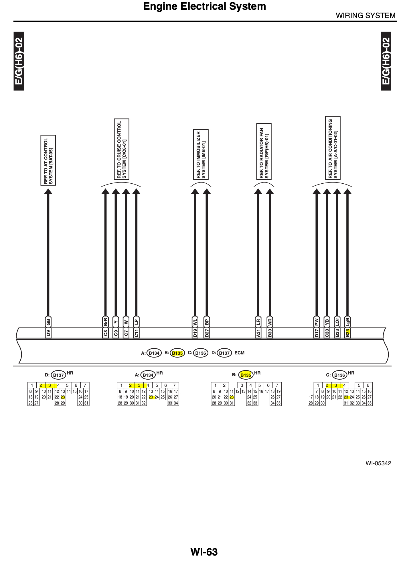

Are two of the A/C relay terminals supposed to be hot when car is in off position, or one terminal hot (battery voltage) and one cold?

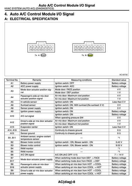

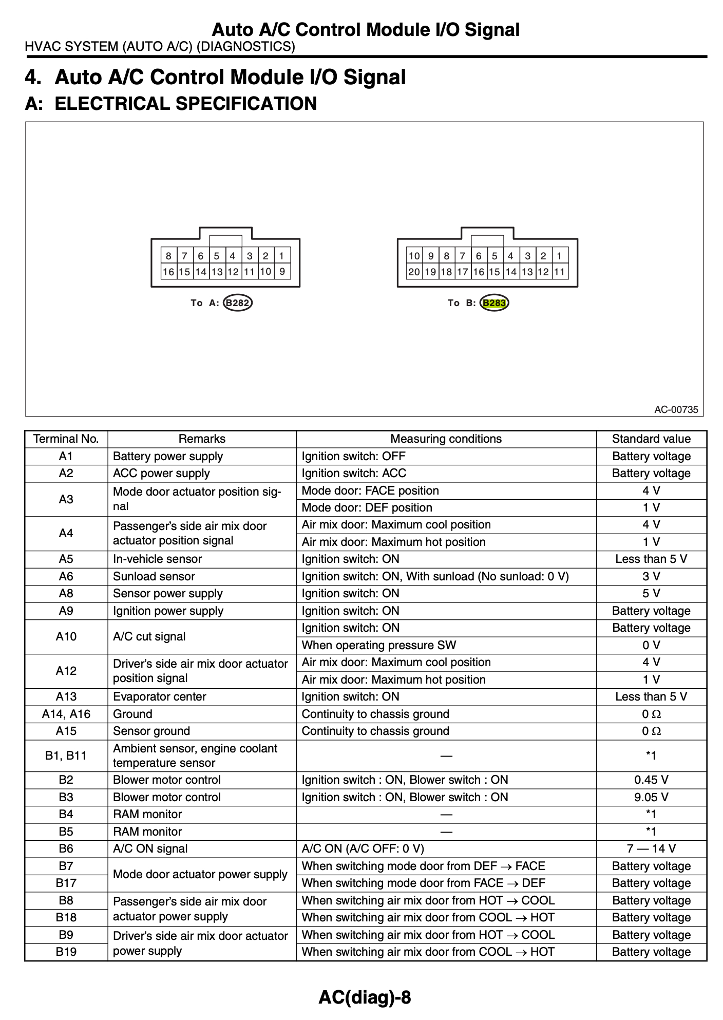

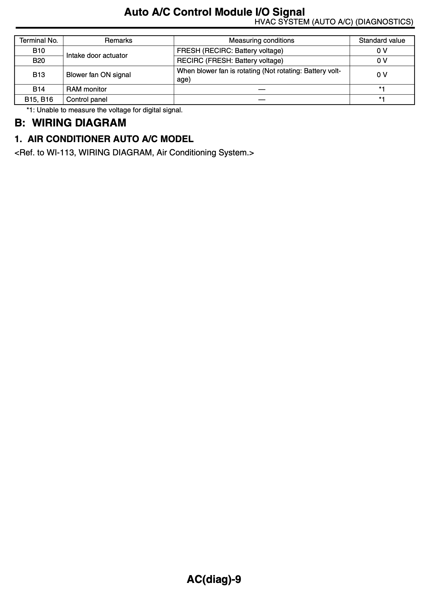

I've attached the terminal assignments for the AC Control Module
A few items I'm noticing after previous tests:
1. Interior Temp Sensor power supply shows 3.5v (should be approx. 5v) - (B282) 5 to 15
2. Evap Sensor power supply shows 3.5v (should be approx. 5v) - (B282) 13 to 15
*Could this be an issue?
**Is it worth looking at the (i3/B38) 11 connector for a short?
Versus:
3. Mode Door and Air Mix actuators showing 5v (B282) 8 to 15
4. Mode Door actuator power supply cuts out: 10v down to 0.5v
(B283) 7 to Chassis GND & (B283) 17 to Chassis GND
5. Air Mix actuators power supply cuts out: 10v down to 0.5v
(B283) 8 to Chassis GND & (B283) 18 to Chassis GND - Passenger Side
(B283) 9 to Chassis GND & (B283) 19 to Chassis GND - Driver's Side
*Is this normal operation?
Wednesday, May 10th, 2023 AT 6:47 AM

The actuators are somewhat a unique item. They use a pulsed signal back to the control head. Basically, an optical encoder that recalibrates at every start. So, 3.5 on the power to them is okay. They also won't stop the system from working. The 12 volts is a polarity reversal drive, it also will change voltage somewhat depending on actuator position and as soon as an actuator hits a travel stop the current spike causes the control head to cut power, until either the key on reset or you request a change in the door position.

One Correction from previous post on ECM.
ECM Terminals:
A/C On connector terminal (B137) 17 [from the A/C Control Module (B283) 6] - normal operation
*A/C Relay Control (B135) 33 - Battery voltage is present when A/C Power Switch is off (good), and when it is on (bad)
A/C Middle Pressure Switch (B137) 30 - Battery voltage is present when A/C Power Switch is off (good), and when it is on (bad)
When the A/C is switched on from the Control Panel/Head Unit, via the A/C Control Module, both ECM terminals [(B135) 33 and (B137) 30] should cut to 0v, they do not.
If the A/C power signal coming from the Control Panel to the A/C Control Module (B283) 6, to ECM (B137) 17 [battery voltage when ac is on, zero voltage when it is turned off] is functioning normally, would that mean the issue is not in the AC Control Module (or anything preceding the signal from (B283) 6? Isolating the problem to the ECM?
Wednesday, May 10th, 2023 AT 3:58 PM
STEVE W.
  • 15,697 POSTS

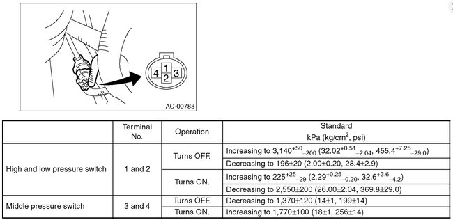

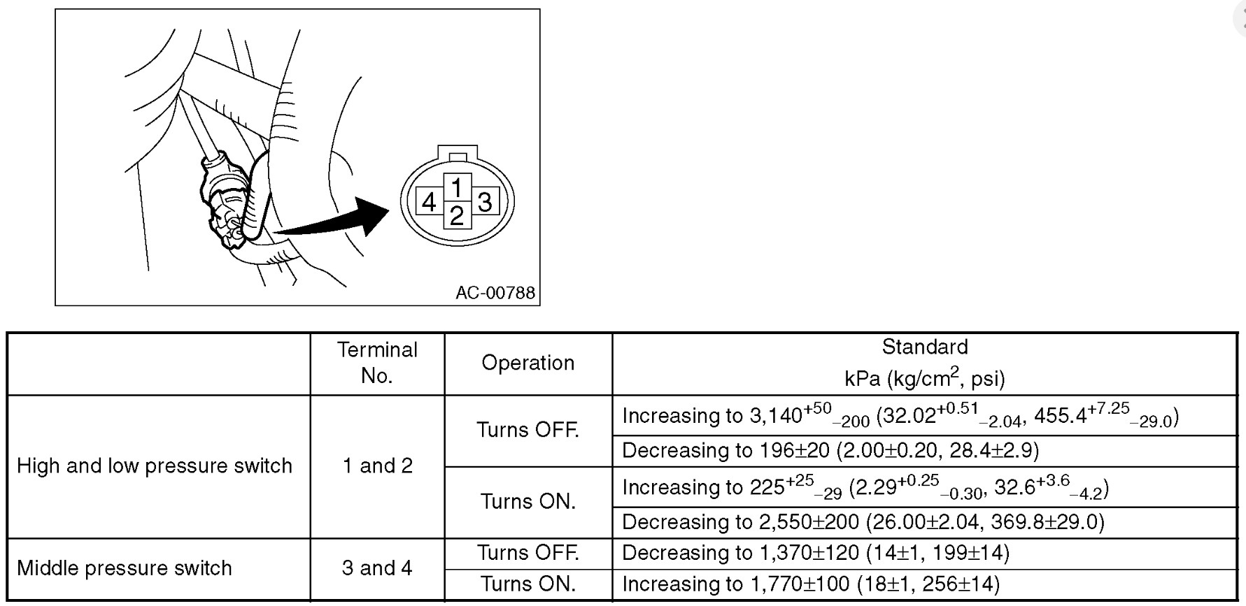

That would be the control side of the relay which should get pulled to ground to activate the A/C, as you tested earlier it doesn't switch. Your other testing shows that the remainder of the system seems to function. So, an easy test, connect a meter to the medium pressure switch and jump pin 33 to ground. Does the A/C work? Does the pressure signals change as it builds pressure? If the pressure signals operate properly then you know that it's the driver in the ECM that is bad.
Wednesday, May 10th, 2023 AT 6:02 PM
NJMCLAIN
  • 23 POSTS
Please correct me where I'm misinterpreting:
Step 1: Back probe (B135) 33 and jump to Chassis GND.
Step 2: Unplug pressure sensor connector and use the multimeter to test continuity across (B10) 3 and 4?
Step 3: Plug in the Pressure Sensor and test the A/C operation with a manifold gauge?
Thursday, May 11th, 2023 AT 4:24 AM
STEVE W.
  • 15,697 POSTS
Step one- correct. Step 2 would be to simply observe the system, if you can back probe the pins on the pressure switch you can verify its operation as well. If it functions and the A/C is cold you already eliminated other areas and have narrowed it into the ECM. You could test with a gauge but simply measuring the temperature drop at the center vent on high would work.

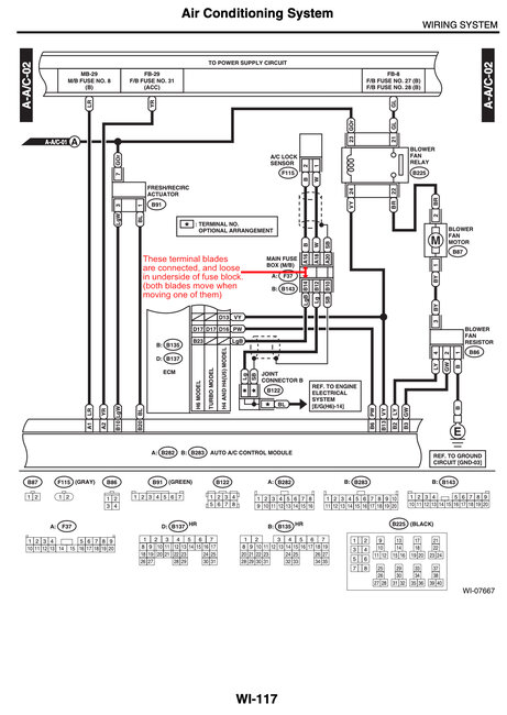

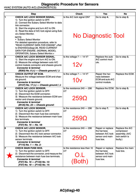

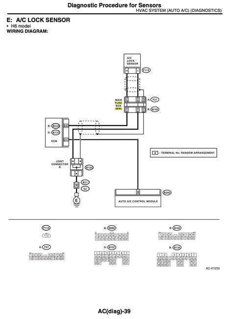

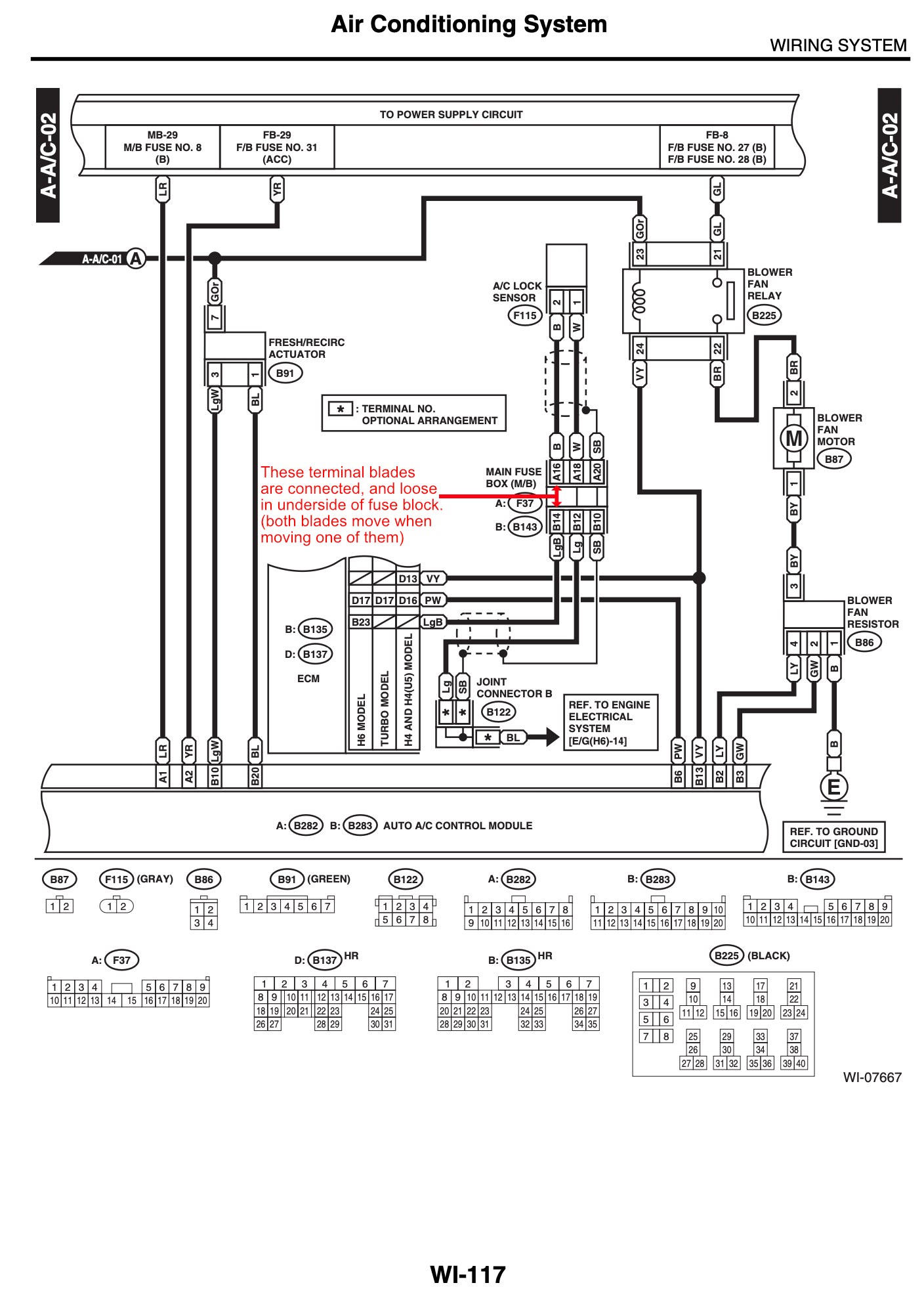

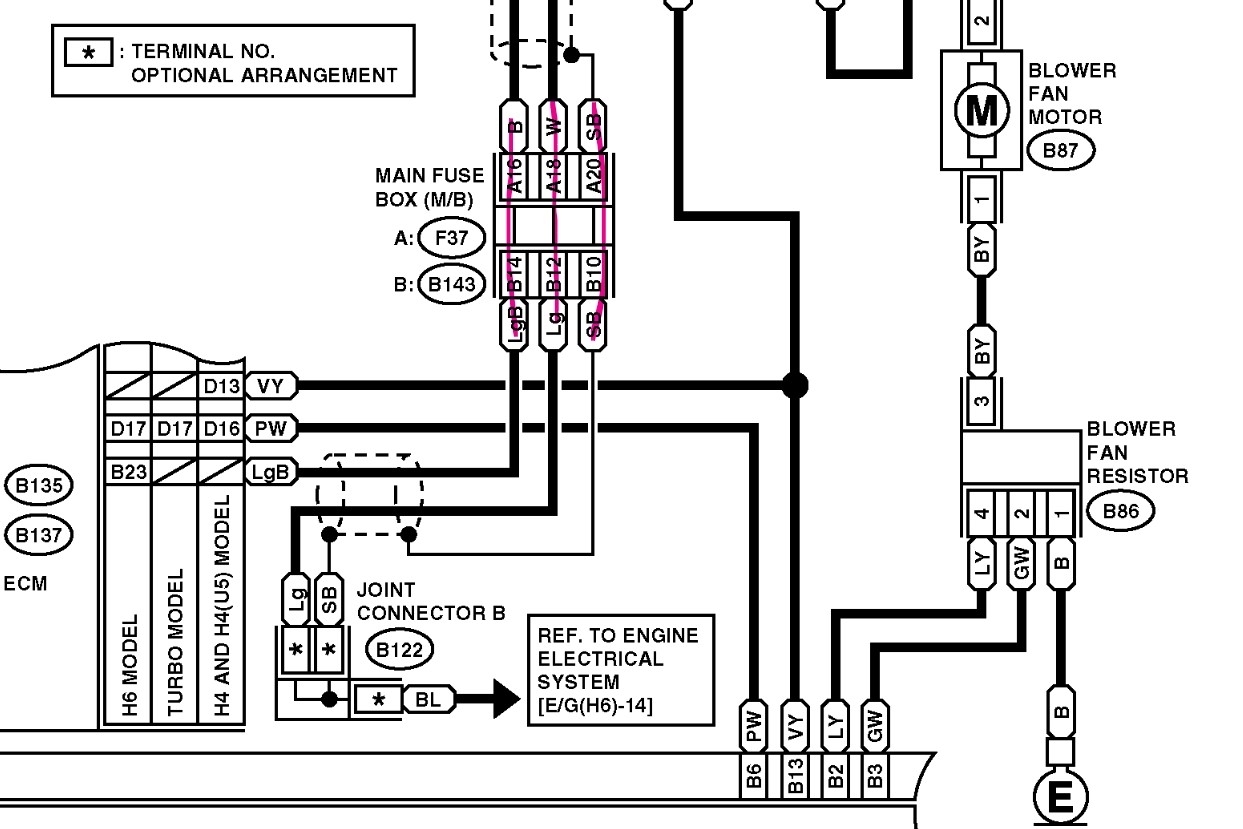

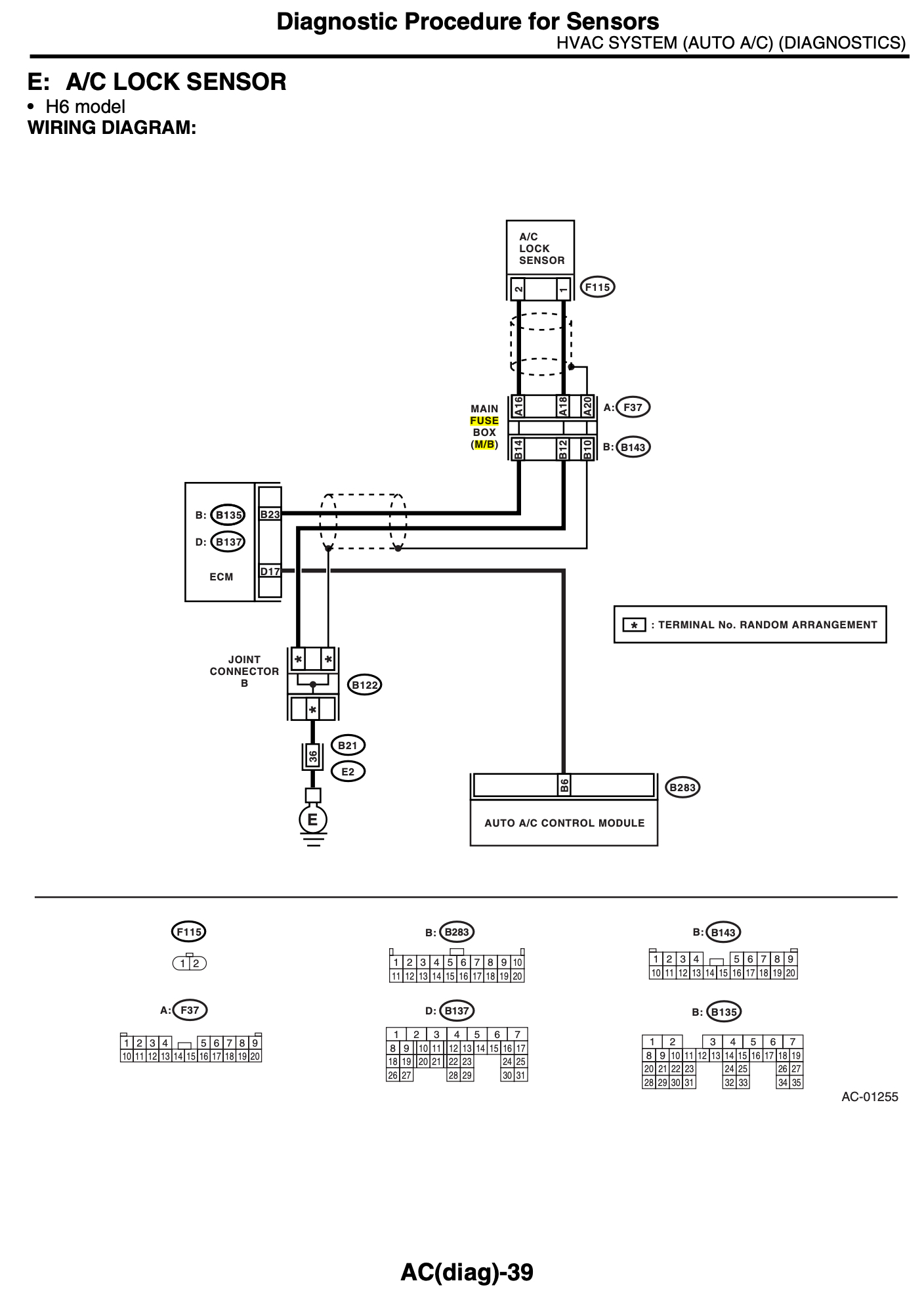

Even though it's a brand-new compressor in the car, I decided to run the Lock Sensor diagnostic flow today. Got some puzzling (to me) results in Step 7 (attached pics). Anything to dig into here?
I found two loose terminal blades (F37) 16 and (B143) 14 in my Main Fuse Box (they appear to be physically connected/one unit) - pushing one blade will directly move the other (the blades are inline across two connectors).
In Step 7 of the attached A/C Lock Sensor diagnostic flow I measured the resistance between two sets of terminal blades as well as the corresponding connector terminals on the fuse box and kept getting O.L. For everything.
1. Are the loose terminal blades a factor in not getting a continuity reading?
2. If yes, are they affecting the signal to/from the A/C Lock Sensor?
3. Is the O.L reading in Step 7 related to the ECM?

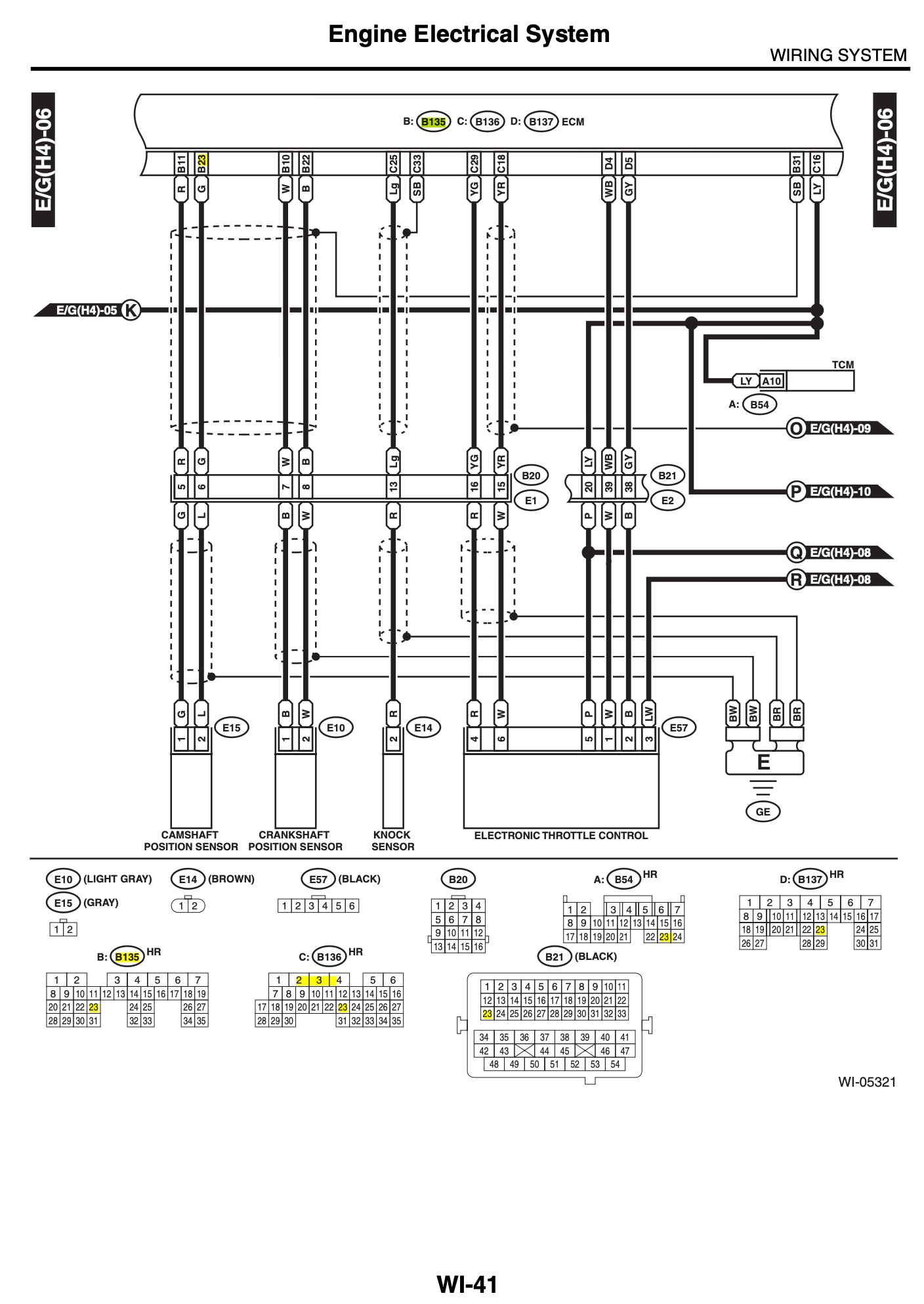

4. In the attached A/Csystem wiring diagram the fuse box terminal [from the Lock Sensor] (B143) 14 connects to the ECM via (B135) 23 which looks to be the Camshaft Position Sensor GND - anything here? - I'm guessing that the lock sensor is syncing with the camshaft position sensor.
5. Could the Camshaft Position Sensor(s) be affecting the A/C system via the Lock Sensor?
Thank you!
Thursday, May 11th, 2023 AT 8:10 PM
STEVE W.
  • 15,697 POSTS
It is not uncommon to find mated contacts. If you look at the various wiring diagrams you can see many instances where they use terminals like that simply as connection points without them connecting to power or ground inside the block, they are in. That is because they tend to reuse things like fuse blocks and harnesses, plus when your car was built the harness will have all the wires in it for all options that were available. Saves money by having just a single harness and saves errors on the line.
As long as there is continuity between the adjacent terminals it is okay.
I wouldn't worry much about the lock sensor though; its only job is to look at the compressor speed and the engine speed and make sure they match when the compressor engages. Yours doesn't engage and you are not seeing a code for an rpm mismatch so it's not an issue. It uses the RPM signal from the ignition module.
No on the cam sensor causing the A/C to not work. The lock sensor does nothing until the compressor engages.
Thursday, May 11th, 2023 AT 9:17 PM

With ECM AC Relay Control (B135) 33 jumped to Chassis GND, the AC Compressor fires up and blows cold.
Should I order an ECM and get it programmed?
*After some conversations with a local mechanic and another friend, it appears that if you added an iPod 1/8in jack kit to the stereo (which I did back in the day - Jazzy Engineering), it can affect the ECM negatively. I also added a cheap Bluetooth extender to the hack. Maybe this caused the ECM issue?
