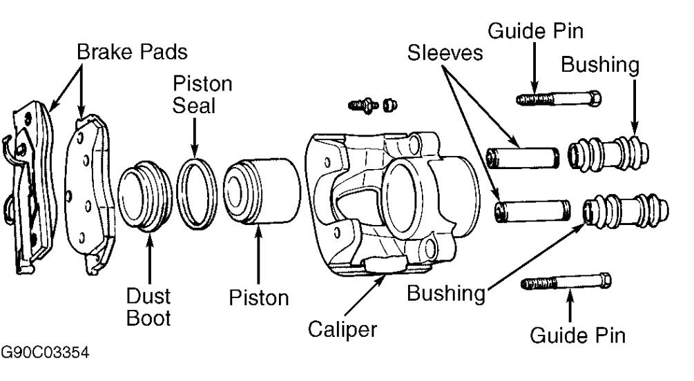

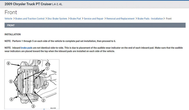

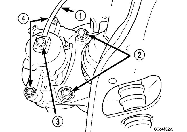

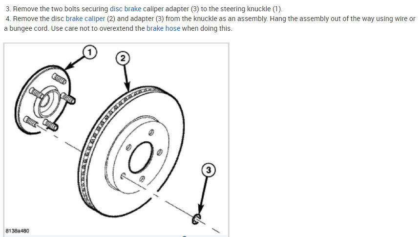

I need to know how to change my brakes? Thank you.
Sunday, May 26th, 2019 AT 6:28 AM
16 Replies
  • 110,194 POSTS
Replacing front brake pads really isn't too hard. When you do it, make sure to get lifetime pads so you never have to pay for them again. This video shows the job being done.
https://youtu.be/9S0im10Z2T0
You can expect front pads to last approximately 25,000 miles. However, that can change based on driving habits and terrain.
To get you started, here is a link that shows how it is done in general. You can use this as a guide.
If you look at the attachments, they include the directions and pictures specific to your vehicle for replacement. Use these directions for the procedure.
I hope this helps. Let me know if you have other questions. See pics below

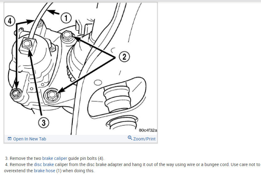

Welcome to 2CarPros.

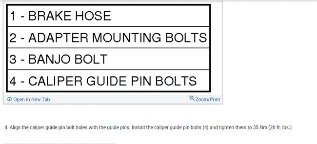

Here are the directions for calipers. Remember to make sure they are the correct ones you are getting. As far as the other questions, I need them each on a separate thread. We are trying to keep the threads to one specific topic so it is more helpful to others. I hope you understand. Check out the diagrams (Below).
First, here is a link that explains in general how it's done. It makes things easier to understand. After the link are the directions for the 2007.
https://www.2carpros.com/articles/brake-caliper-replacement

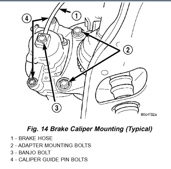

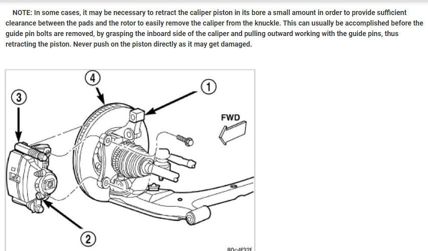

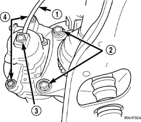

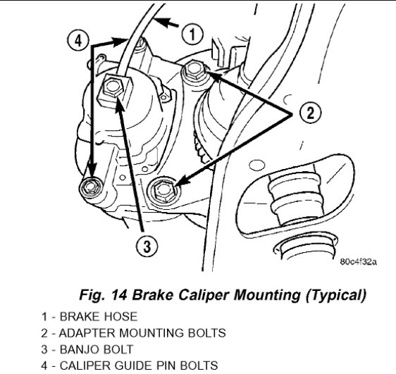

1. Raise and support the vehicle.

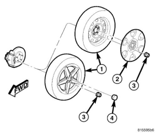

2. Remove the wheel mounting nuts (3), then the tire and wheel assembly.
3. Remove the two brake caliper guide pin bolts (4).

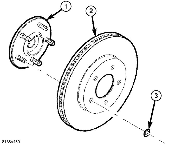

4. Remove the brake caliper from the adapter. Hang the caliper out of the way using wire or a bungee cord. Use care not to overextend the brake hose (1) when doing this.
5. Remove the brake pads (2, 3) from the brake caliper adapter (4).
6. Remove the abutment shims (5) from the adapter (4).
7. Remove the two bolts (2) securing the disc brake caliper adapter to the steering knuckle.
8. Remove the disc brake caliper adapter.
Installation
CAUTION: When installing new brake components, be sure to use correct parts. Parts designed for BR4 Performance Brake System must not be mixed with other brake systems. These parts, similar in appearance, can be easily identified.
1. Install the disc brake caliper adapter on the steering knuckle.
2. Install the two bolts (2) securing the disc brake caliper adapter to the steering knuckle. Tighten the bolts to 104 Nm (77 ft. lbs.).
3. Attach the two abutment shims (5) to the adapter (4) fitting the contour of each shim to the adapter's contour.
4. Place the inboard (2) and outboard (3) brake pads into the abutment shims clipped into the disc brake caliper adapter as shown. The pad with the wear indicator attached is the inboard.
CAUTION: Use care when installing the caliper onto the disc brake adapter to avoid damaging the boots on the caliper guide pins.
5. Install the disc brake caliper over the brake pads on the brake caliper adapter. Make sure the springs on the pads do not get caught in the hole formed into the center of the caliper housing.
6. Align the caliper guide pin bolt holes with the guide pins. Install the caliper guide pin bolts (4). Tighten the bolts to 35 Nm (26 ft. lbs.).
7. Install the tire and wheel assembly (1). Install and tighten the wheel mounting nuts (3) to 135 Nm (100 ft. lbs.).
8. Lower the vehicle.
9. Road test the vehicle and make several stops to wear off any foreign material on the brakes and to seat the brake pads.

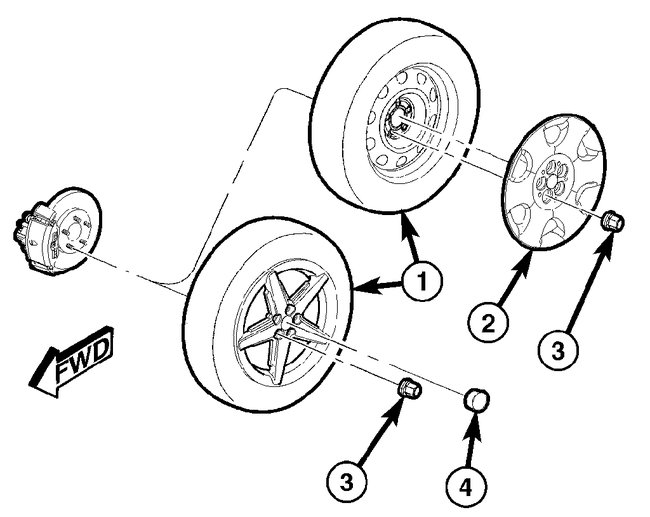

pic 1

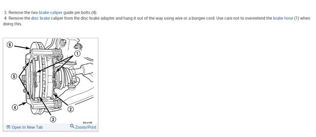

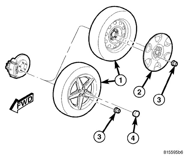

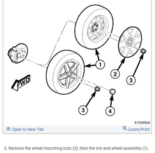

pic 2

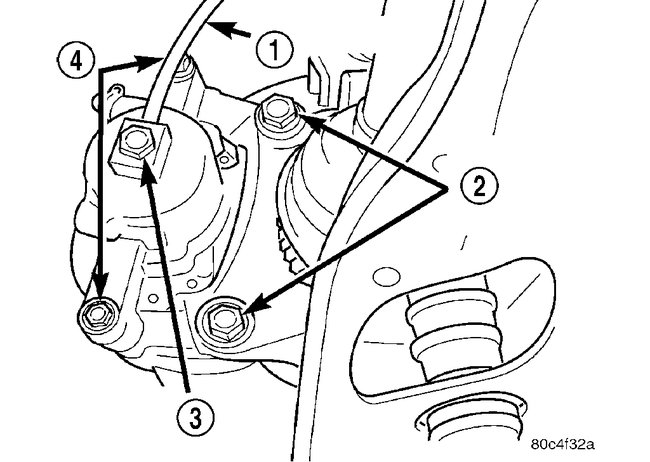

pic 3

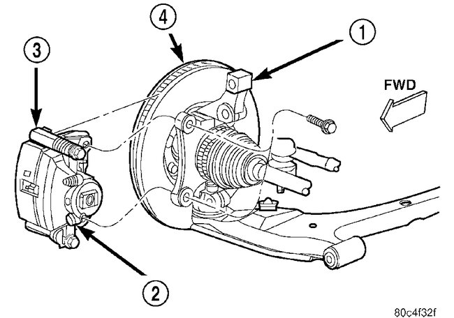

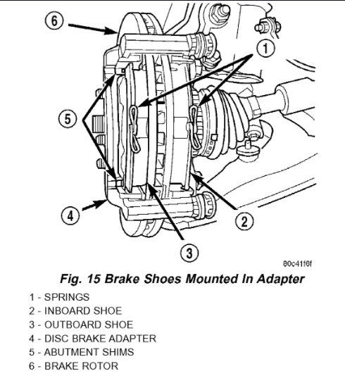

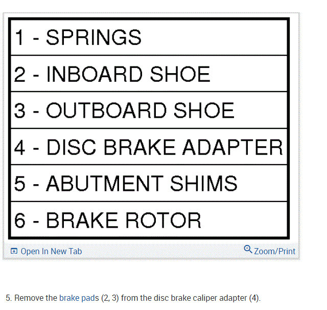

pic 4

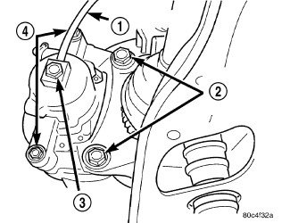

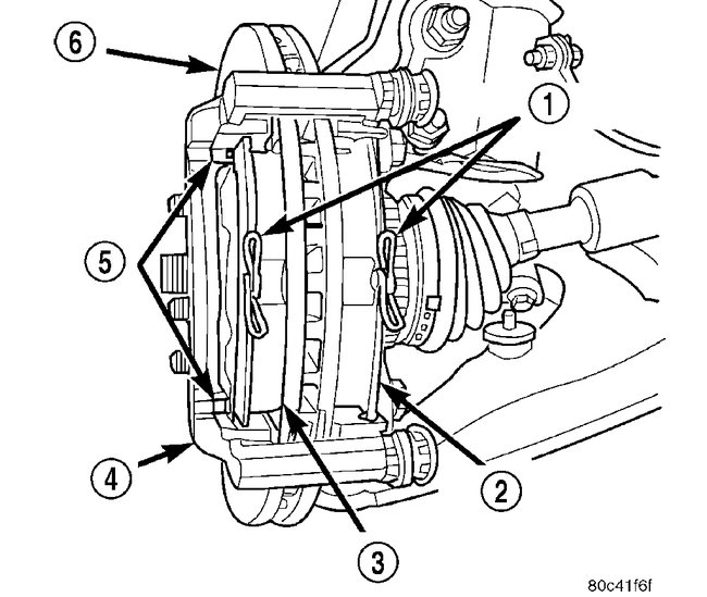

INSTALLATION
INSTALLATION

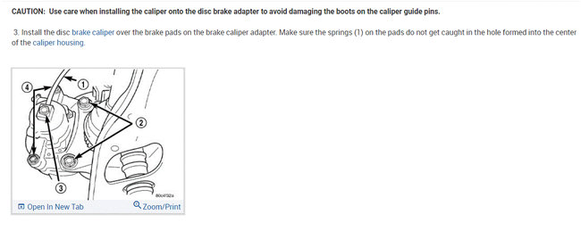

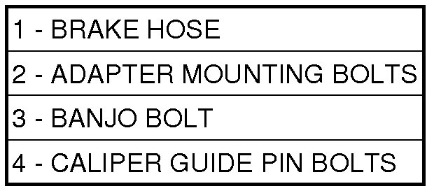

pic 5
pic 6
pic 7
pic 8

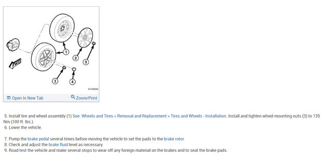

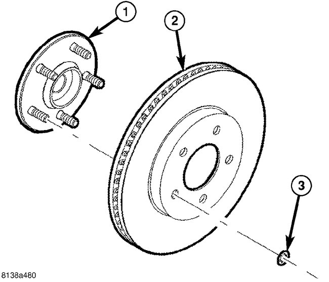

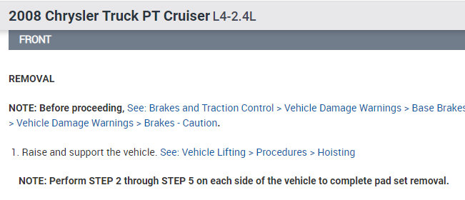

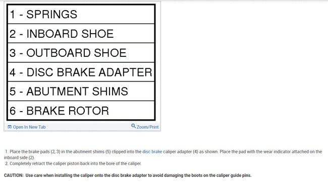

Front brake pads and rotors really aren't too hard to do. If you do it yourself, make sure to purchase lifetime parts so you'll never have to pay for the parts again.You can expect brake pads to last approximately 25,000 miles. However, that can change based on terrain and driving habits. To start, here is a link that shows in general how it's done. You can use this as a guide: Check out the diagrams (Below).

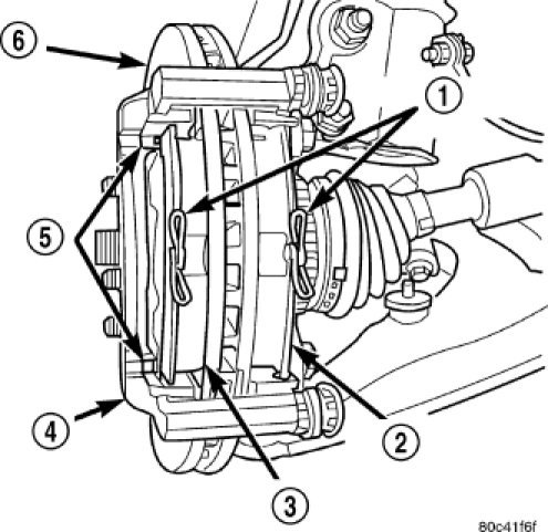

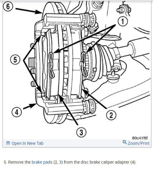

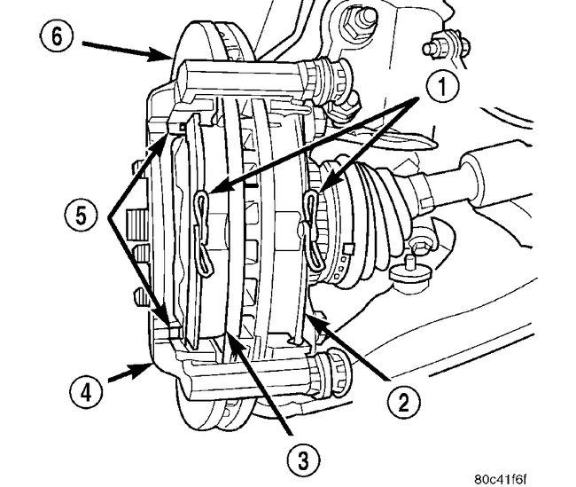

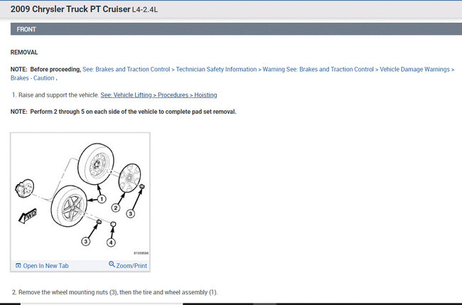

Here are the directions specific to your vehicle. The pics below correlate with the directions.
REMOVAL
NOTE: Before proceeding, Refer to Service Precautions.
NOTE: Perform Step 2 through Step 5 on each side of the vehicle to complete pad set removal.
2. Remove the wheel mounting nuts (3), then the tire and wheel assembly (1).
4. Remove the disc brake caliper from the disc brake adapter and hang it out of the way using wire or a bungee cord. Use care not to overextend the brake hose (1) when doing this.
5. Remove the brake pads (2, 3) from the disc brake caliper adapter (4).

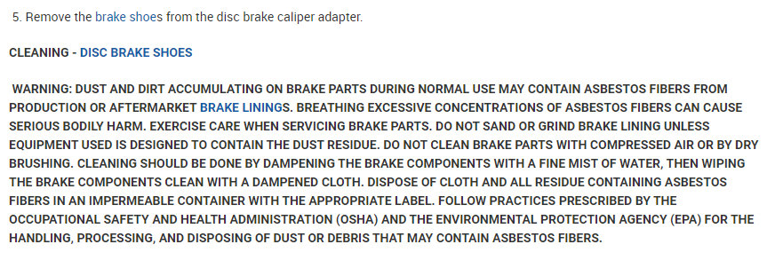

CLEANING
WARNING: Dust and dirt accumulating on brake parts during normal use may contain asbestos fibers from production or aftermarket brake linings. Breathing excessive concentrations of asbestos fibers can cause serious bodily harm. Exercise care when servicing brake parts. Do not sand or grind brake lining unless equipment used is designed to contain the dust residue. Do not clean brake parts with compressed air or by dry brushing. Cleaning should be done by dampening the brake components with a fine mist of water, then wiping the brake components clean with a dampened cloth. Dispose of cloth and all residue containing asbestos fibers in an impermeable container with the appropriate label. Follow practices prescribed by the Occupational Safety And Health Administration (OSHA) and the Environmental Protection Agency (EPA) for the handling, processing, and disposing of dust or debris that may contain asbestos fibers.

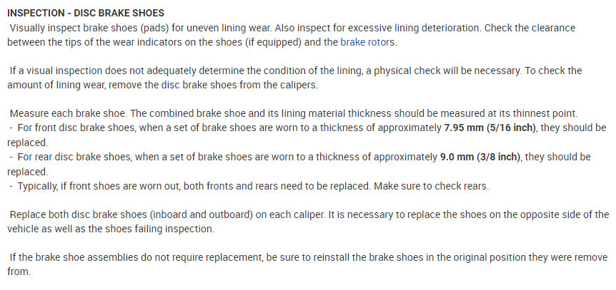

INSPECTION
Visually inspect brake pads for uneven lining wear. Also inspect for excessive lining deterioration. Check the clearance between the tips of the wear indicators (if equipped) on the pads and the brake rotors.
If a visual inspection does not adequately determine the condition of the lining, a physical check will be necessary. To check the amount of lining wear, remove the disc brake pads from the calipers.
Measure each brake pad. The combined brake pad and its lining material thickness should be measured at its thinnest point. For front disc brake pads, when a set of brake pads are worn to a thickness of approximately 7.95 mm (5/16 inch), they should be replaced.
NOTE: It is important to inspect both front and rear brake pads during the same inspection. Typically, front and rear brake pads wear out at the same time.
Replace both disc brake pads (inboard and outboard) on each caliper. It is necessary to replace the pads on the opposite side of the vehicle as well as the pads failing inspection.
If the brake pad assemblies do not require replacement, be sure to reinstall the brake pads in the original position they were remove from.

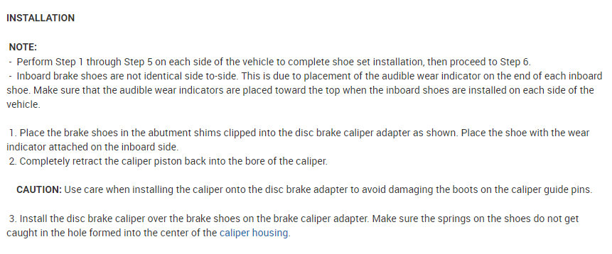

INSTALLATION
NOTE: Perform Step 1 through Step 5 on each side of the vehicle to complete pad set installation, then proceed to Step 6.
NOTE: Inboard brake pads are not identical side-to-side. This is due to placement of the audible wear indicator on the end of each inboard pad. Make sure that the audible wear indicators are placed toward the top when the inboard pads are installed on each side of the vehicle.
1. Place the brake pads (2, 3) in the abutment shims (5) clipped into the disc brake caliper adapter (4) as shown. Place the pad with the wear indicator attached on the inboard side (2).
2. Completely retract the caliper piston back into the bore of the caliper.
3. Install the disc brake caliper over the brake pads on the brake caliper adapter. Make sure the springs (1) on the pads do not get caught in the hole formed into the center of the caliper housing.

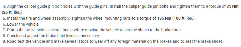

4. Align the caliper guide pin bolt holes with the guide pins. Install the caliper guide pin bolts (4) and tighten them to 35 Nm (26 ft. lbs.).
5. Install tire and wheel assembly (1). Install and tighten wheel mounting nuts (3) to 135 Nm (100 ft. lbs.).
6. Lower the vehicle.
7. Pump the brake pedal several times before moving the vehicle to set the pads to the brake rotor.
8. Check and adjust the brake fluid level as necessary

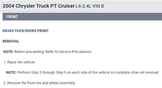

How do I change front brakes?
Wednesday, April 14th, 2021 AT 12:13 PM (Merged)
DANNY L
  • 5,648 POSTS
Hello, I'm Danny.
Here is the information you requested. This is a tutorial showing what is involved on how to change front brake pads and brake rotors:
I've attached picture steps below on how to change the front brake pads and rotors on your car. Hope this helps and thanks for using 2CarPros.
