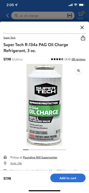

Okay, let me know if there is anything I can do to help once you get it. Note there will be o-rings when disconnecting and reconnecting the lines. Make sure to lubricate them before you put it together. Additionally, note the need to add oil in the directions above.

Can I just add this to the low side charging port for the condenser?
Friday, April 15th, 2022 AT 11:07 AM
  • 110,194 POSTS
That should be fine. It will work its way throughout the system.
Let me know how things turn out for you.
Friday, April 15th, 2022 AT 7:46 PM
ZHILL93
  • 20 POSTS
It’s working good, there’s no Freon blowing on the lower radiator hose anymore.
