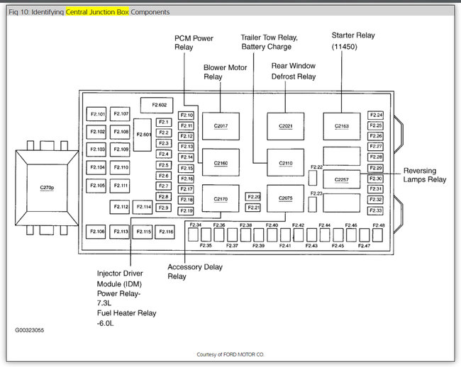

(6.0 power-stroke) My truck will not start. I have code for low ICP, EOT sensor high input, and ECT circuit high. I have ruled my ICP is bad by the oil leaking, but it will not start when I unplugged it, and it should start. The ficm Voltage is at 48 cranking and not cranking. The batteries are good to go, the fuses are goods. Have any idea what is wrong and what I could do to test?

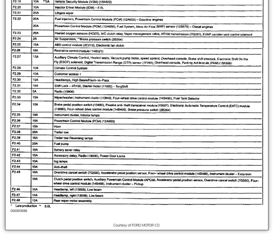

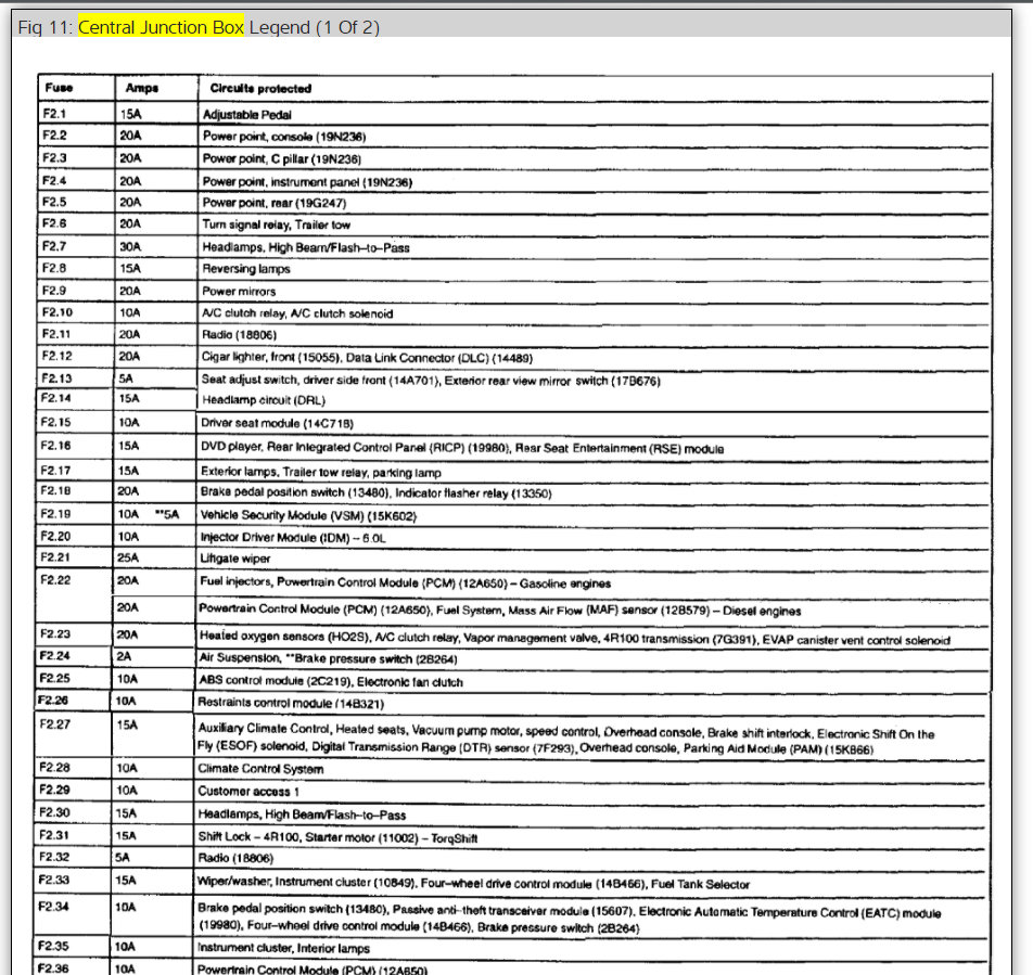

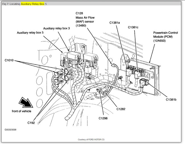

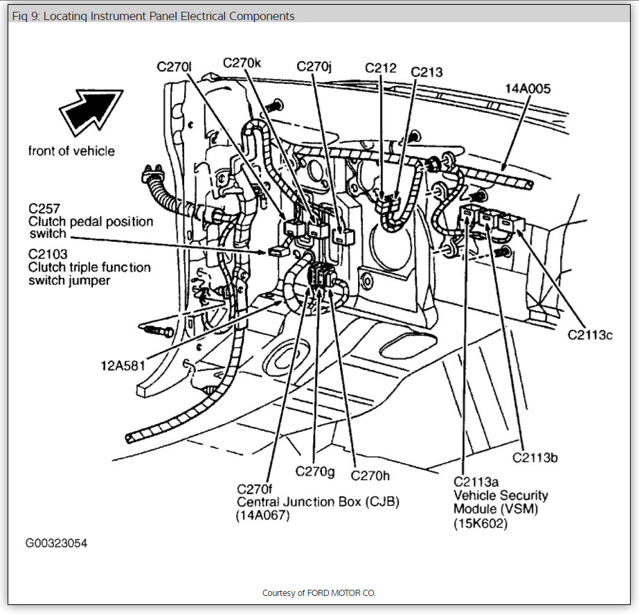

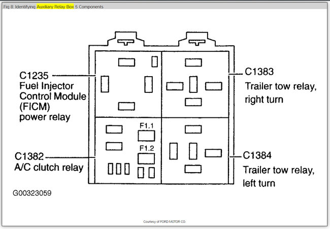

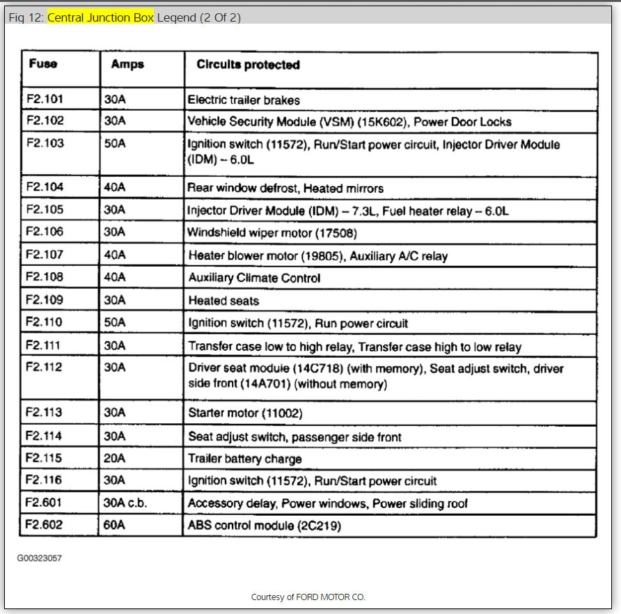

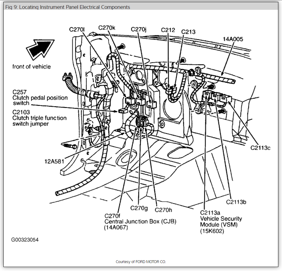

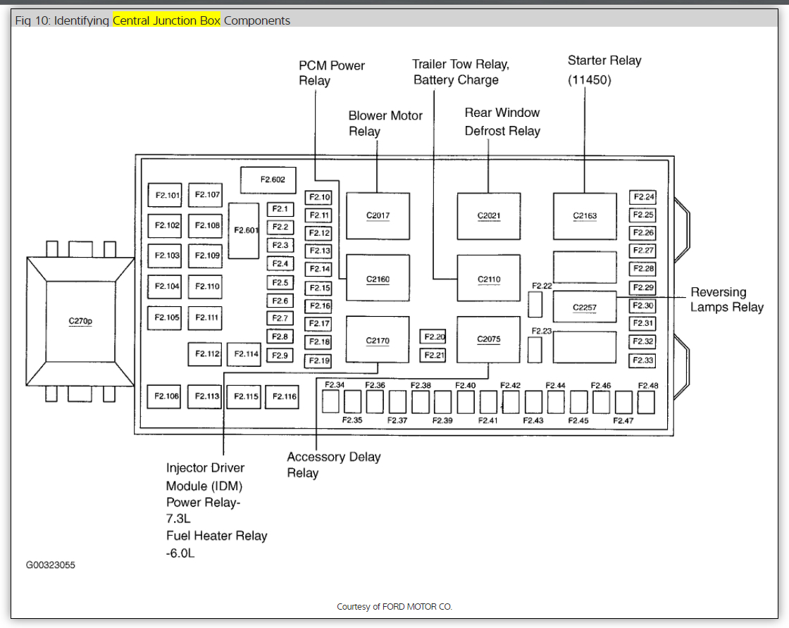

I am not sure if the engine wills tart without the ICP. But I would check all of the fuses, Here is a guide and some diagrams (below) to help you get started.
Is the security light flashing when you try to start it?
Can you check the fuel injector control module relay as well?

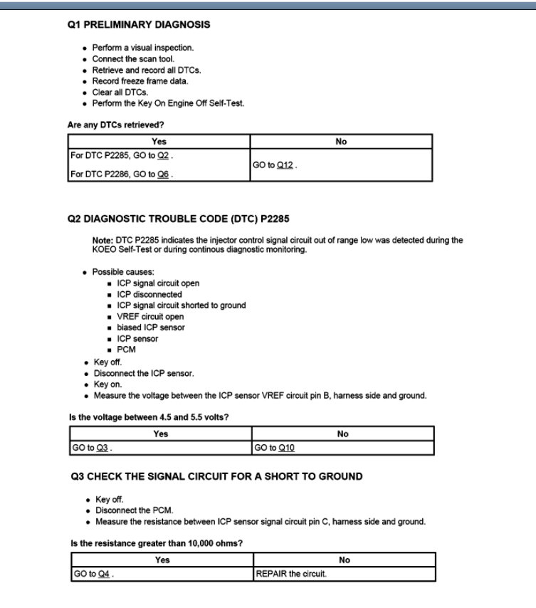

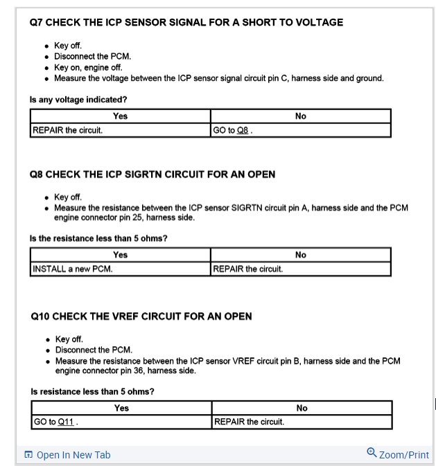

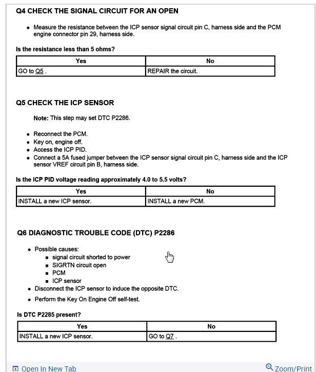

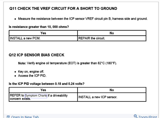

Is your vehicle a 2003 F350 6.0L like shown in the heading of this question?
If so, here is the testing that we need to run through.
P2285 - Injector Control Pressure sensor circuit low
Let's run through this testing as this code will directly cause this issue so we need to start with this.
More then likely you have an issue with the pressure sensor, wiring, or PCM but we need to run through the testing to find out. Thanks
