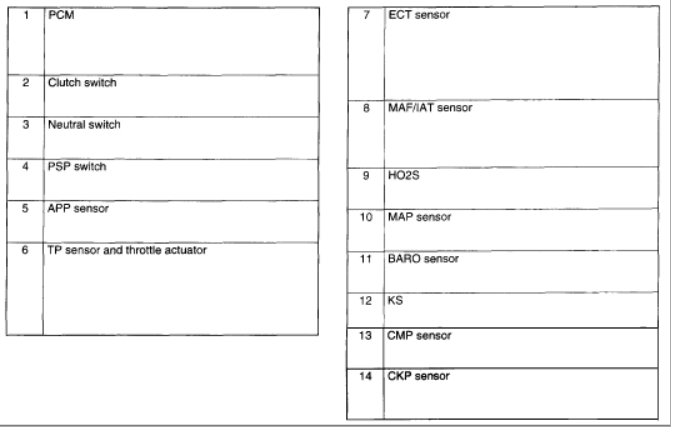

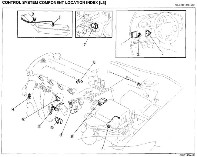

This sounds like you have a crankshaft angle sensor that is going out. Here is a guide to show you what you are in for when changing the sensor out.
