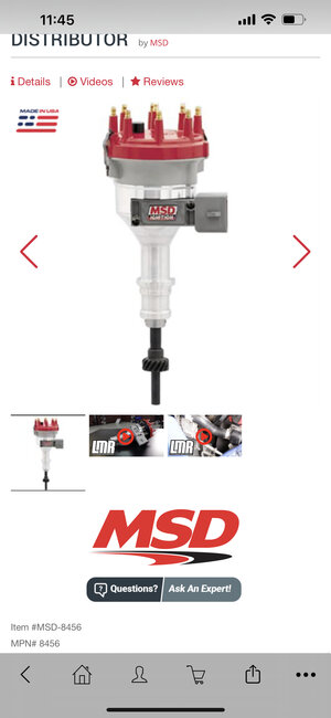

No worries, Ryan. Thank you for getting back to me. Congrats to your buddy’s wedding and also, I want to thank you for answering all my questions about my build I highly appreciate it couldn’t do it without you. So, I have this MSD distributor which I was wondering if it’s a good one to run for the setup I went with.
†b303 cam
†summit racing heads part # SUM-162SBF185WIN
†trick flow forged pistons part # TFS-51404000
†rocker arms trick flow TFS-51400510

RYAN L
  • ADMIN
  • 276 POSTS
No problem! That is what I am here for! Thank you!
So that depends if you are running EFI on your build. That unit has a computer controlled advance curve which is cool but you need the right computer. If that is what you are running, then this unit is perfect!

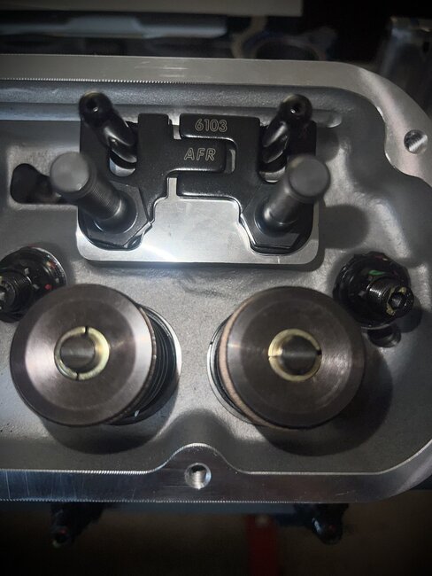

Hey Ryan, I had a question so I’m installing my rocker arms I was wondering if my guide plate lettering needs to be facing down?

FOXBODY.302K
  • 21 POSTS
This is what I have so far.

RYAN L
  • ADMIN
  • 276 POSTS
Hey great question! I had to look it up because off the top of my head I would had said up. But past me said this https://youtu.be/DVVW_mgo1YE?t=192 face down. So, I would have read that out of the directions that came with the heads so that is got to be it. You might want to double check yours just in case they changed it for some reason although I do not see why they would. Thanks for using 2CarPros!
