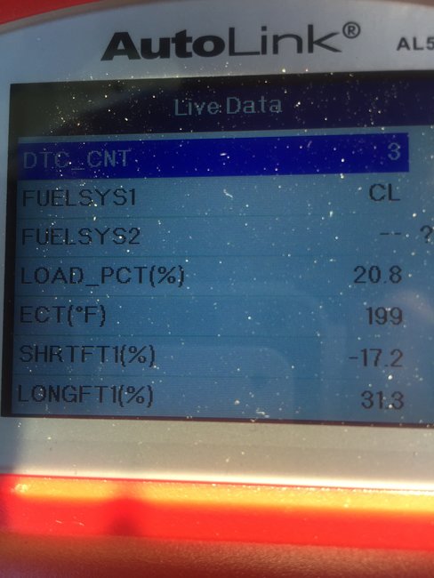

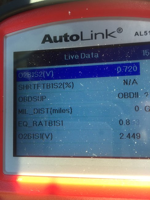

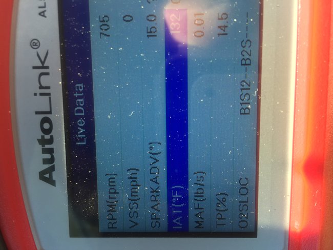

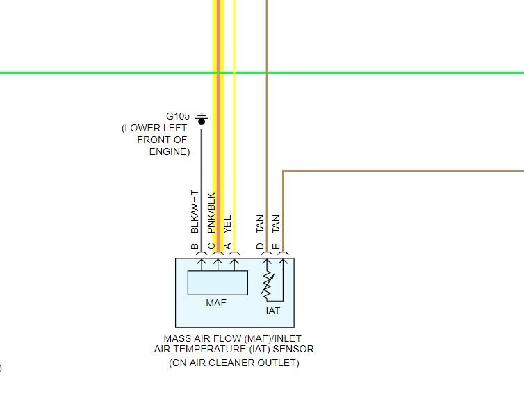

So I did some research and found out that only denso sensors are good with Toyota. The new maf was purchased from advance auto. I scanned the live data and the IAT was reading 132 when the temp outside was only 83. So took the new one out and put the old one in, IAT read 100. But gave me MAF code. Also the ECT was reading 199. Here are some pix of the live data. I'm thinking about getting a denso maf

The coolant temp read 199 but what was the actual coolant temp?Sounds lie you have to do something about the maf if the iat is reading that far off.

How would I get the actual coolant temp compared to the scanner reading?
Saturday, June 18th, 2016 AT 3:07 AM
SATURNTECH9
  • 30,869 POSTS
With a infrared temp gun I usually measure where the top radiator hose goes into the head. Within 10 degrees of what computer says.
Saturday, June 18th, 2016 AT 7:18 AM
SARGON KHABEER
  • 17 POSTS
Update. So I cleaned the maf and tested it with a multimeter and it's all good and car starts right a away with no problem. I still have the p0171 code and on the ready page on the scanner, everything has a green check mark except the cat and o2 sensor with have red x mark. Could that be causing the p0171? The upstream o2 sensor is good and new. Could the downstream o2 sensor be causing this?

The down stream o2 sensor monitors the health of the cat. By comparison of the upstream o2 readings verus the downstream o2 sensor readings.I would say ove 90 percent of the cars I have seen with a code p0171 have been caused by a vacuum leak somewhere.

Ok so I put a new maf sensor and still the same. Did a vacuum leak test and nothing. But, I put my hand under the catalytic converter and there is hot air coming out from a very small hole at the front side of the converter. Not the joints. Could that be causing the problem since the scanner showes cat and o2 sensor not ready?

No that won't set a lean code the upstream o2 sensor monitors that. From what I saw intake manifold leak number one by far and second place is mass air flow sensor and O2 sensor is way down on the list for causing that code.

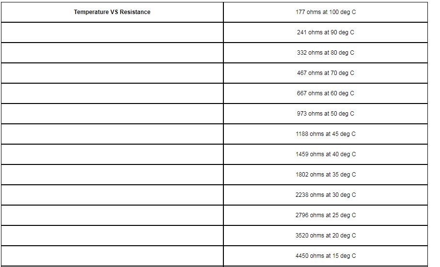

Very hard to start, some time 3 or 4 times need to try but some time starting smoothly
I checked pugs all are OK
Friday, October 16th, 2020 AT 10:04 AM (Merged)

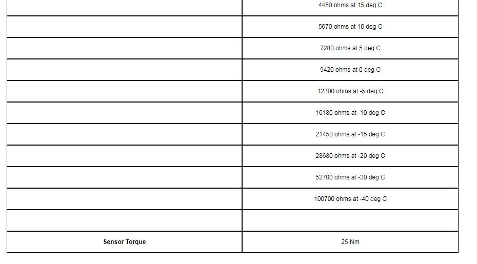

  • 75,992 POSTS
Check fuel pressure and coolant temperature sensor then comeback

ASHRAF_AK
  • 6 POSTS
As you said, I checked coolant temperature sensor then found loose connection on the connector.
After I connected properly, the probles is solved
Thank you very very much

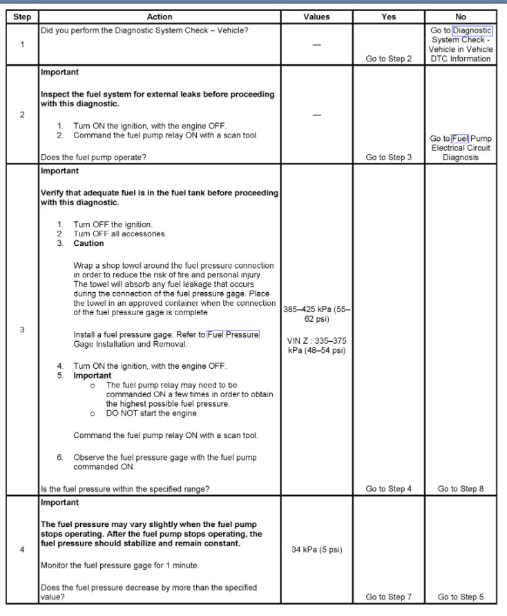

HMAC300
  • 48,601 POSTS

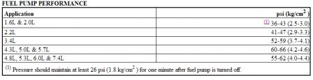

Scan for codes and check fuel pressure with a gauge in US auto parts rent it. It may be losing fuel pressure due to many things should be 44-50 psi and not drop after 5 minutes.
+1
MANAN123
Sir, fuel pressure I just checked with a guage. It is not losing the pressure, it remained normal even aftr 30 minutess. Your kind view please.
HMAC300
  • 48,601 POSTS
We really do not have Toyota's with that size of engine here in USA, so the spec I gave may be incorrect, but it has to stay at minimum pressure otherwise it is too low. Scan for codes as well.
