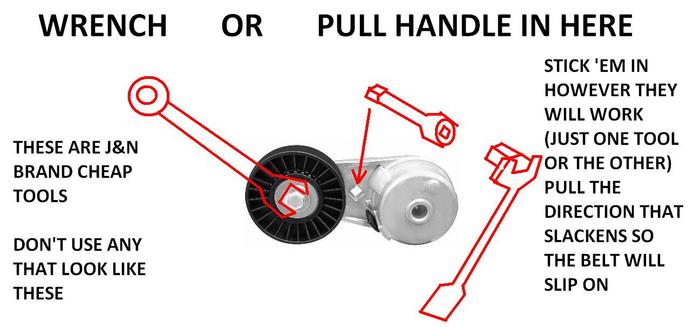

Thanks for keeping me around. CJ wants me gone (lol). I'm sorry you couldn't watch the video I sent, but glad to hear you found a different one. It really isn't too hard to do. The only bad part is the limited amount of space you get to work with. As far as the ratchet, it will either be a 3/8" or 1/2" ratchet needed. Please keep in mind that not all of the tensioniers use just a ratchet. Some require a socket be used on the pulley bolt to move the adjuster. You will know which you need by looking at the adjuster to see if there is a small square cut-out for a ratchet. If there isn't, you will use a socket on the pulleys center bolt.

Ooops did I get you fellas in trouble? I'm sorry but this has been professional I got my car on the road today! And it felt great battery didn't come on or anything.I can't thank you enough &CJ if you want I can give you the chess square recipe & maybe you & the family can tryem. Super simple & yummy
