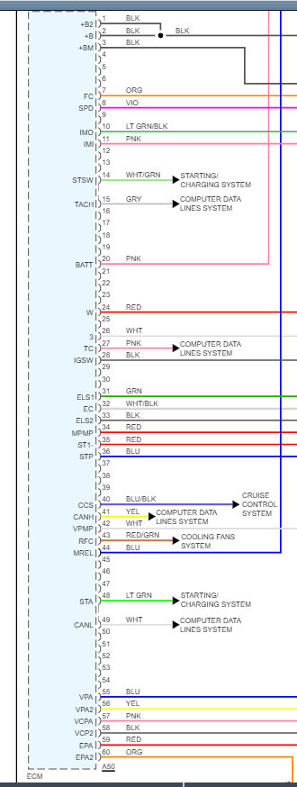

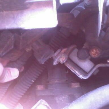

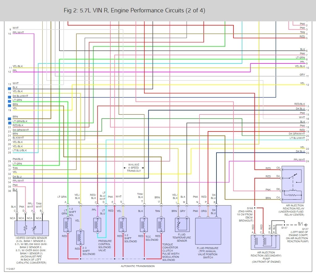

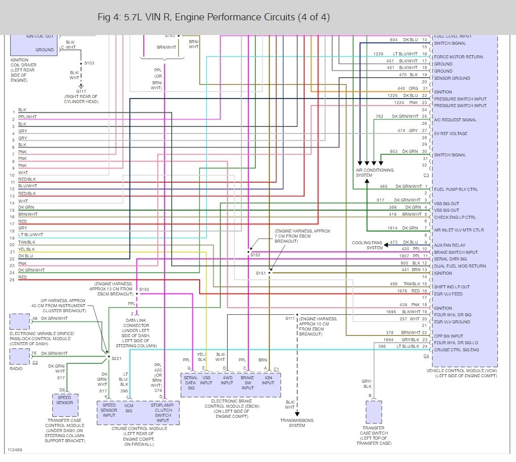

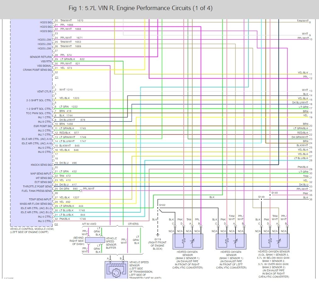

All four O2's are reading lean rich lean rich and showing circuit fault
BSHEPPARD84
  • 1999 CHEVROLET 3500
  • 5.7L
  • V8
  • 2WD
  • 200,000 MILES

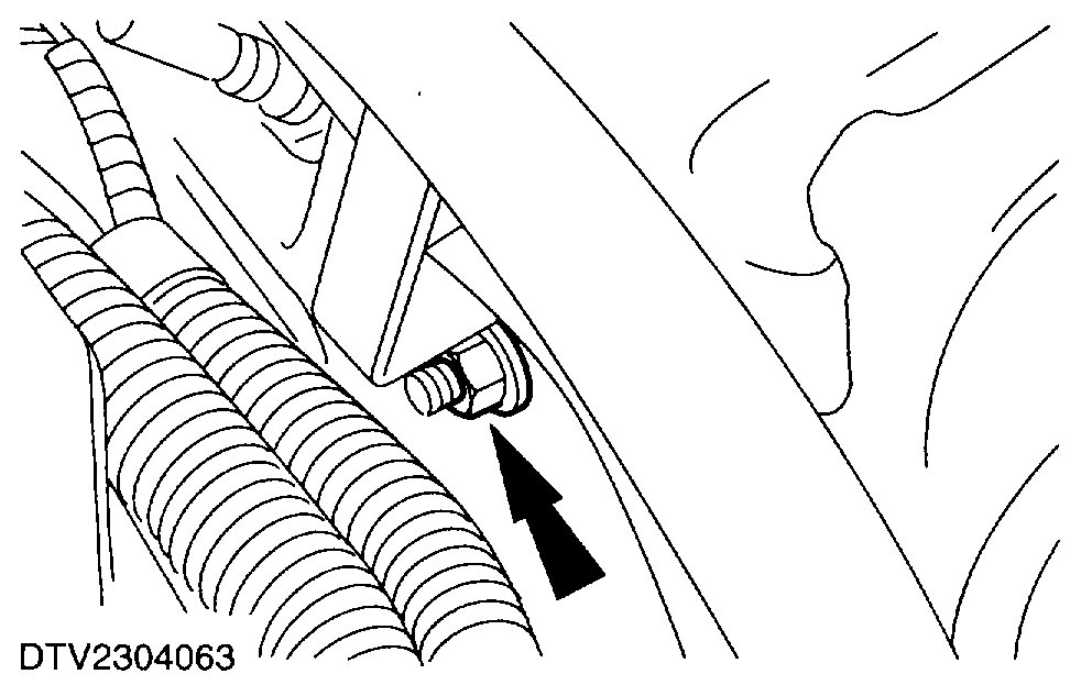

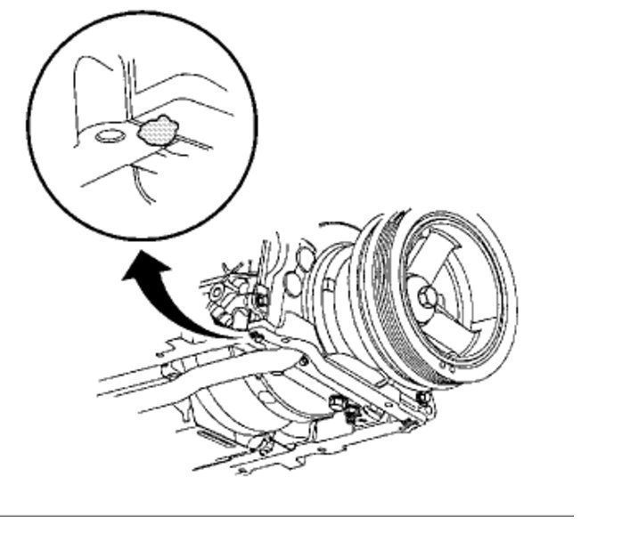

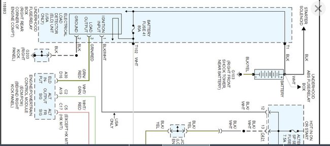

I have 5.04 reference volts at all 4. I was thinking ground but have no idea where to look. Anyone have a diagram or input would help?
Truck is a C3500
Tuesday, August 20th, 2019 AT 4:51 PM
21 Replies
  • 110,192 POSTS
Welcome to 2CarPros.

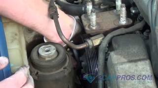

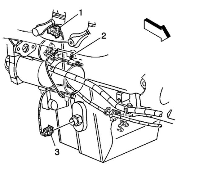

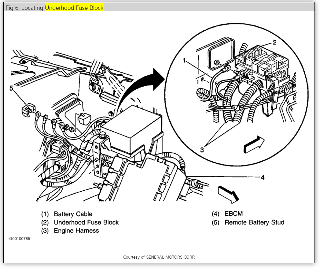

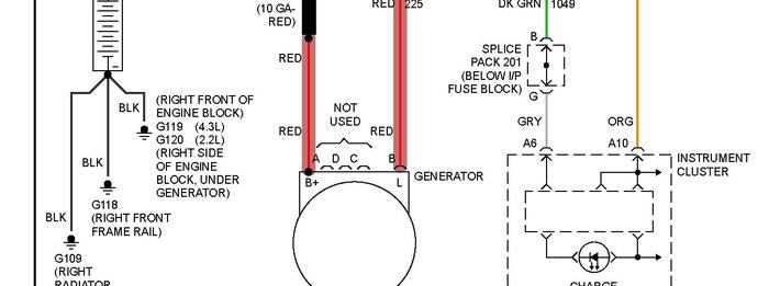

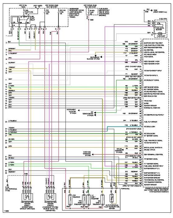

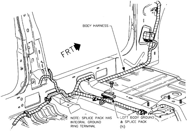

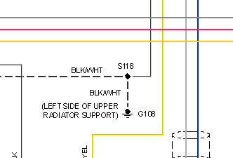

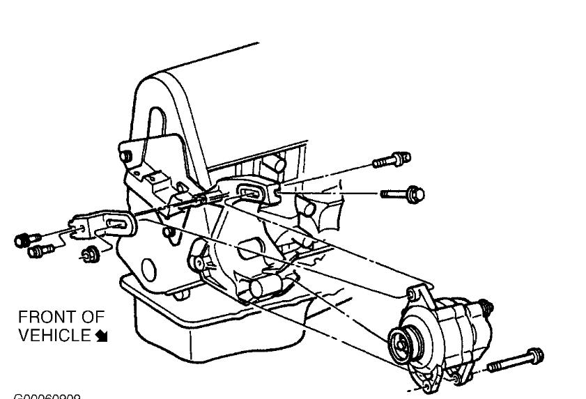

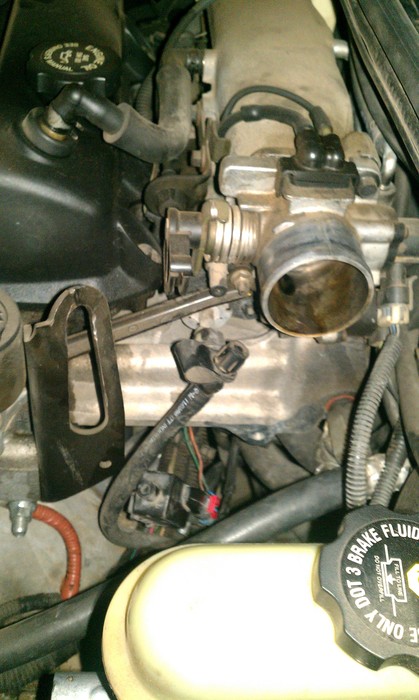

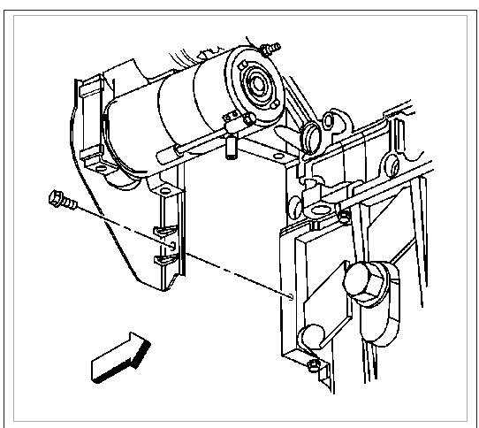

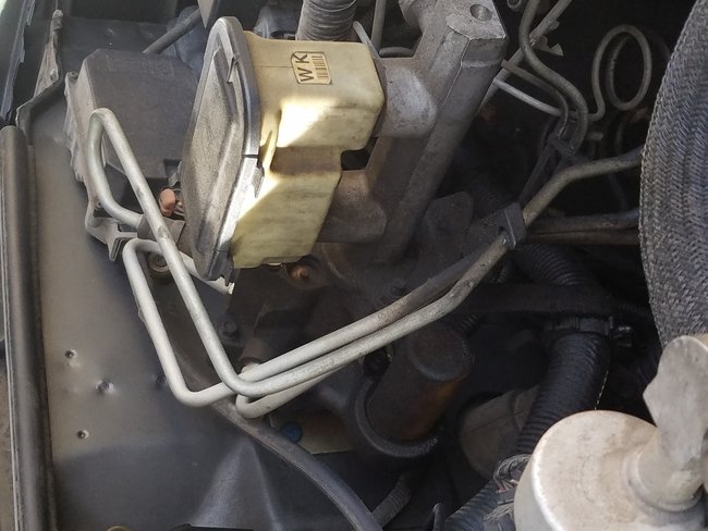

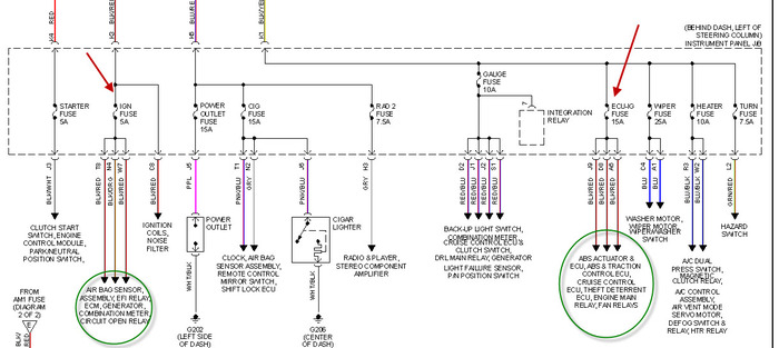

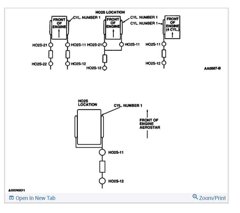

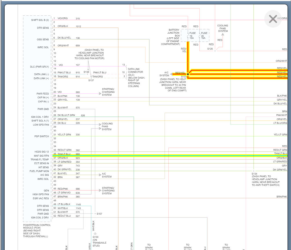

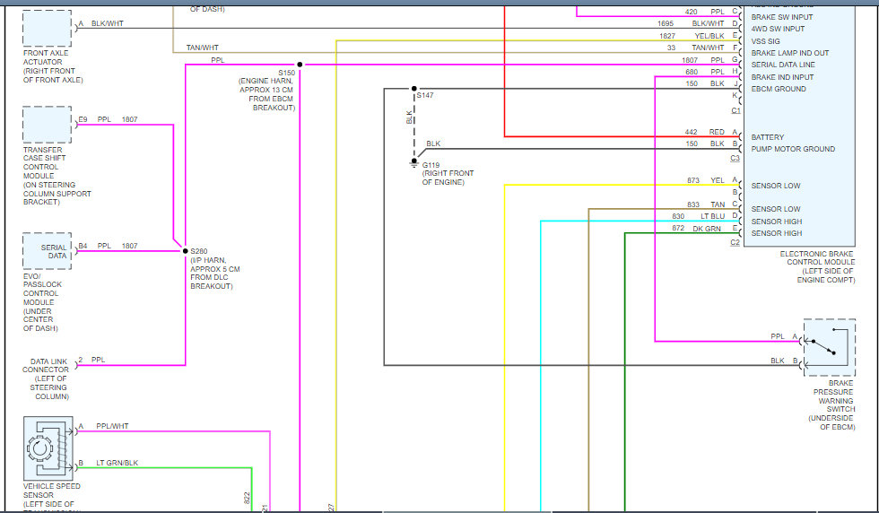

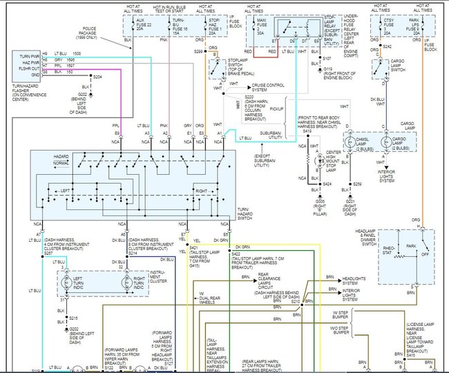

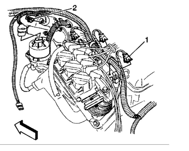

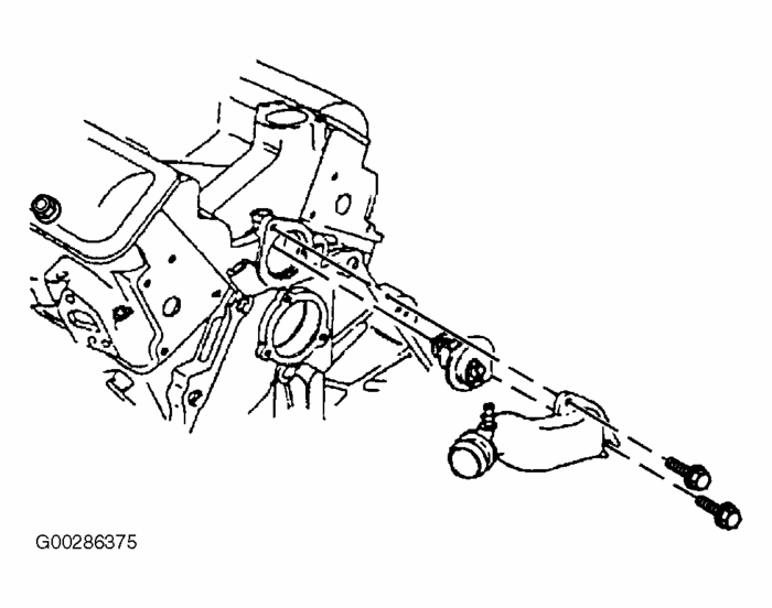

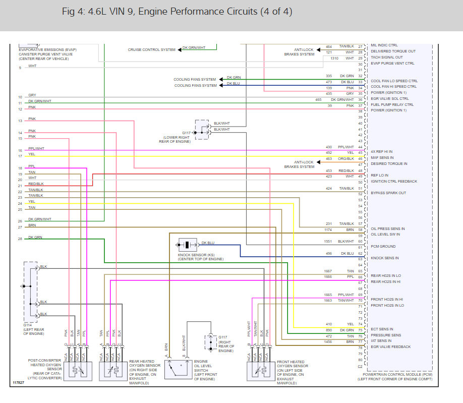

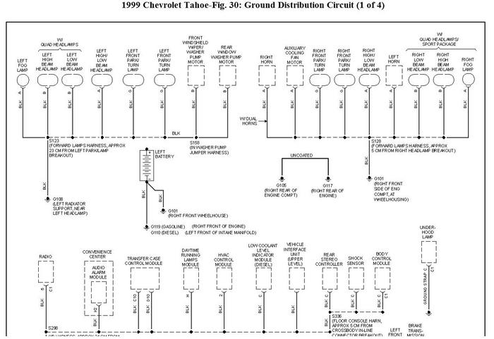

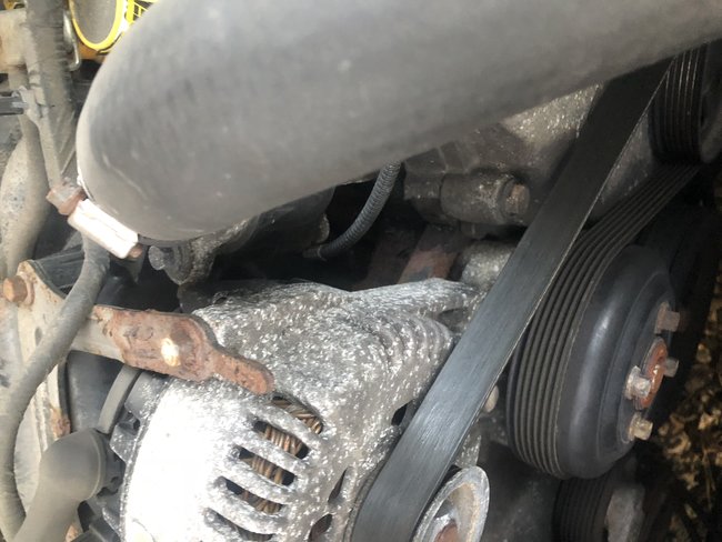

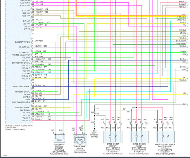

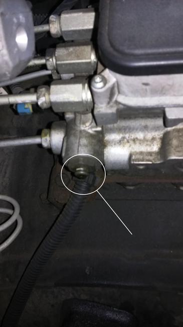

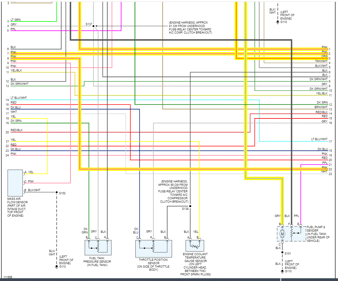

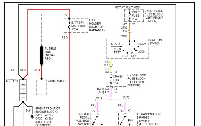

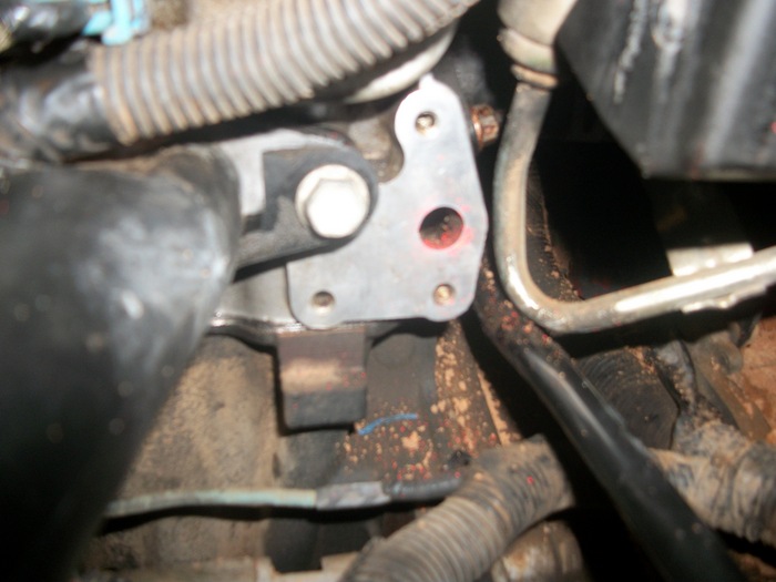

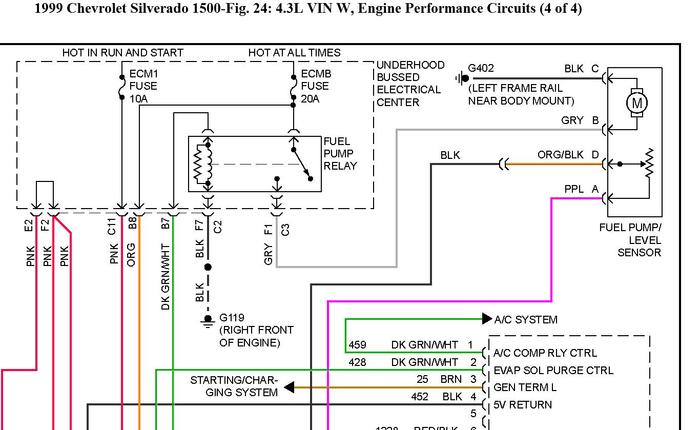

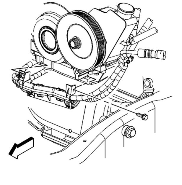

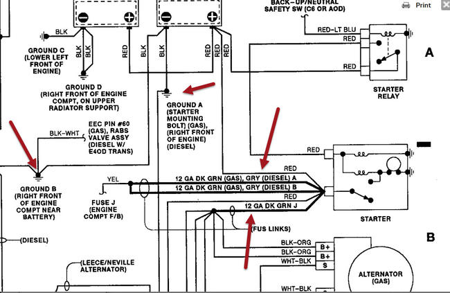

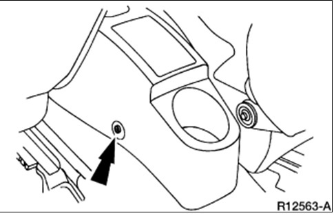

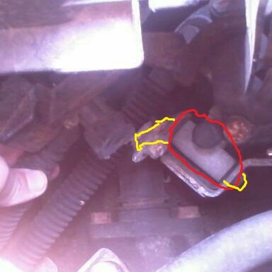

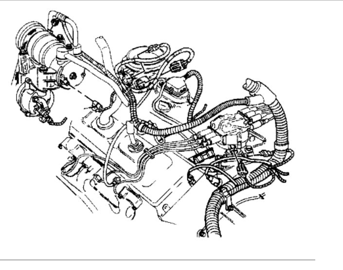

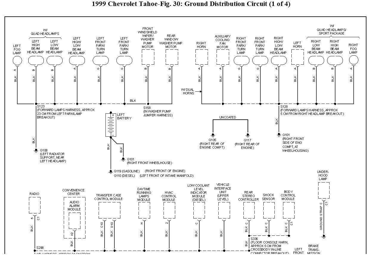

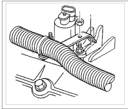

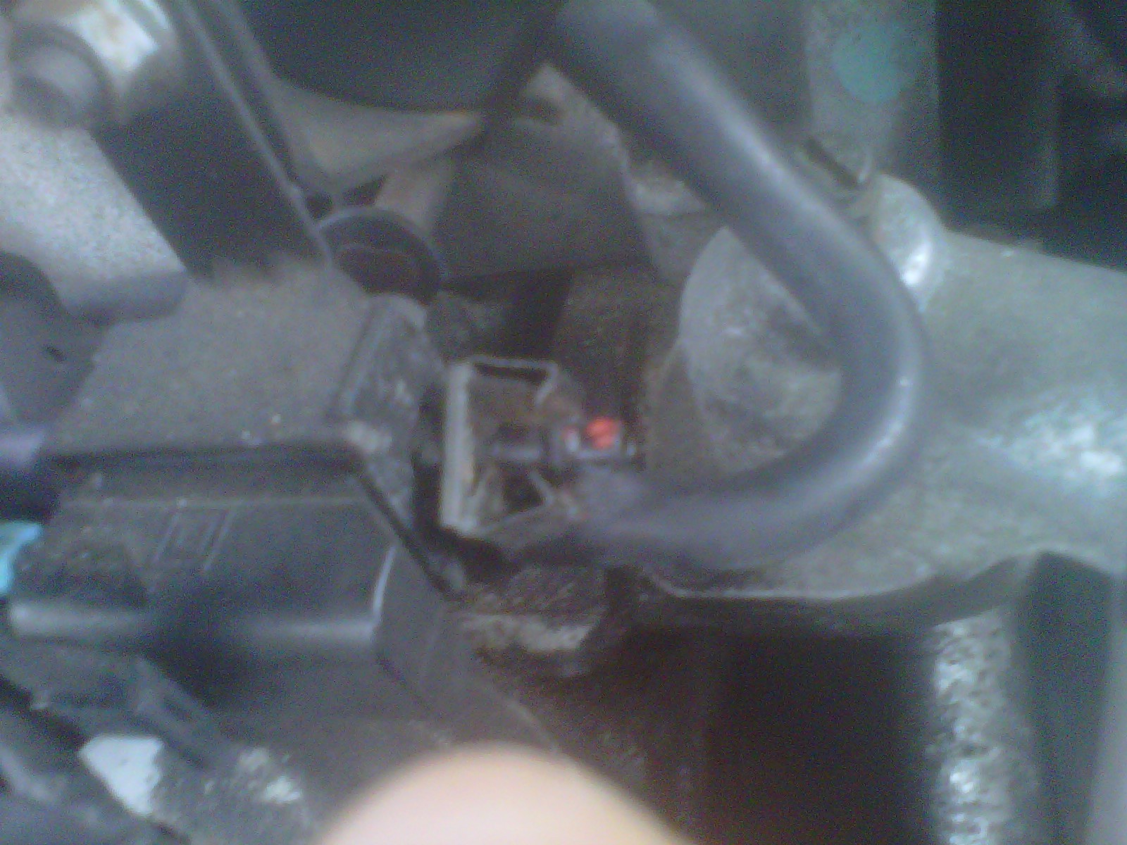

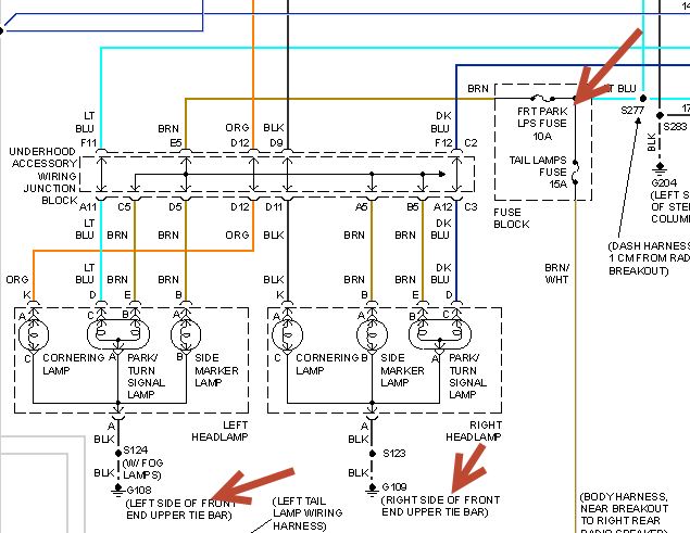

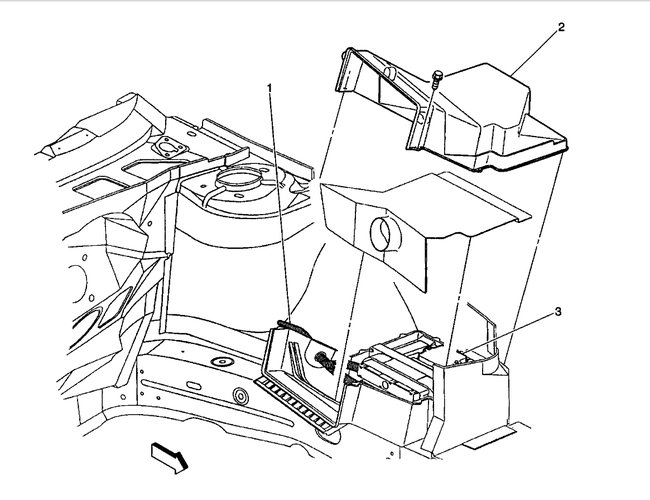

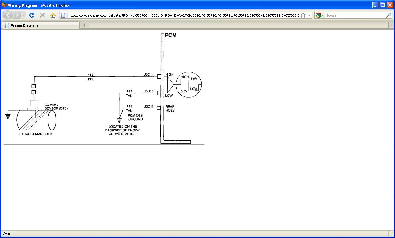

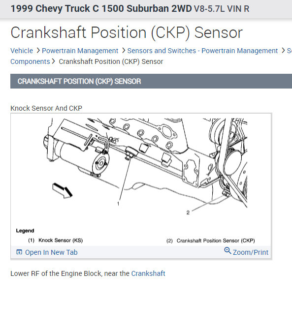

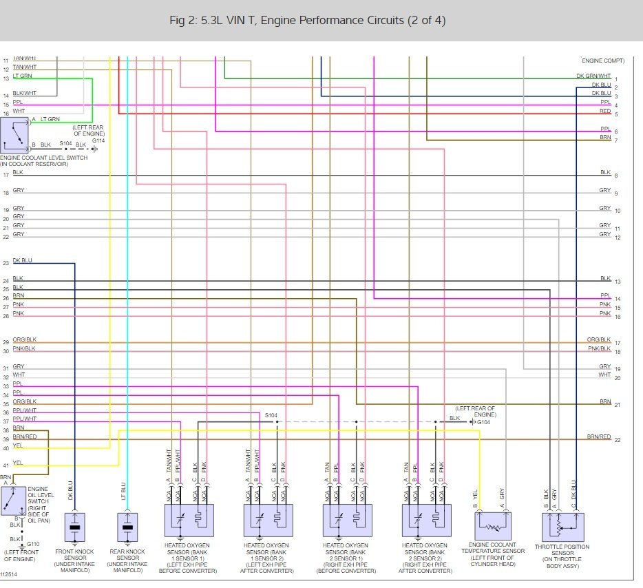

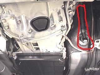

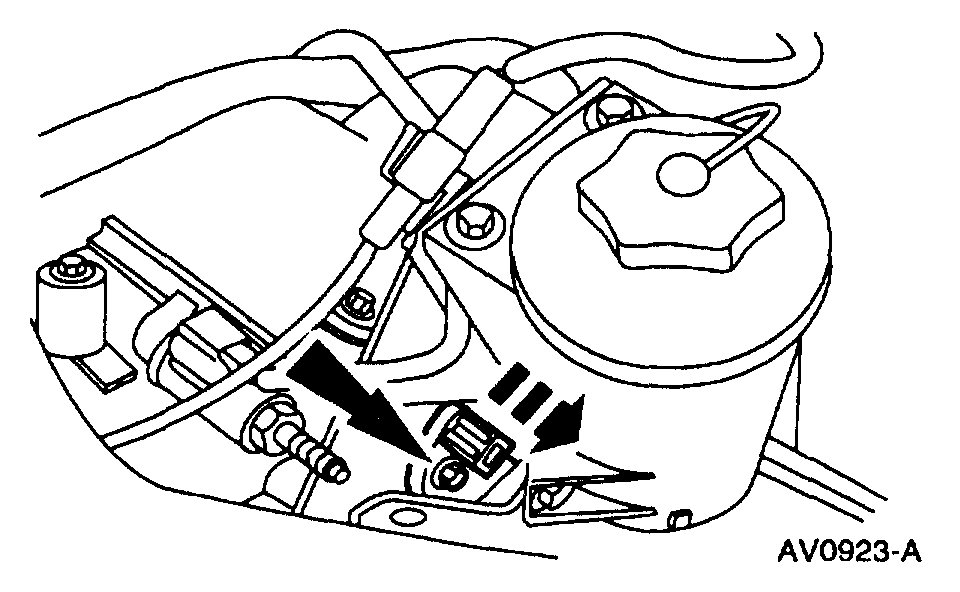

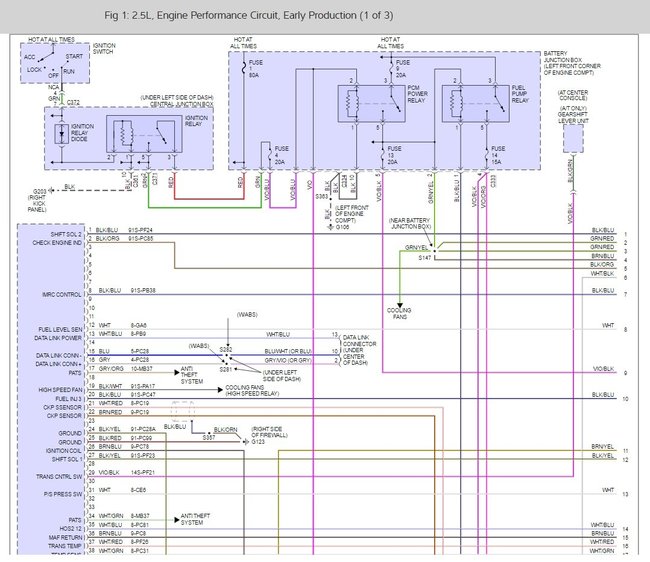

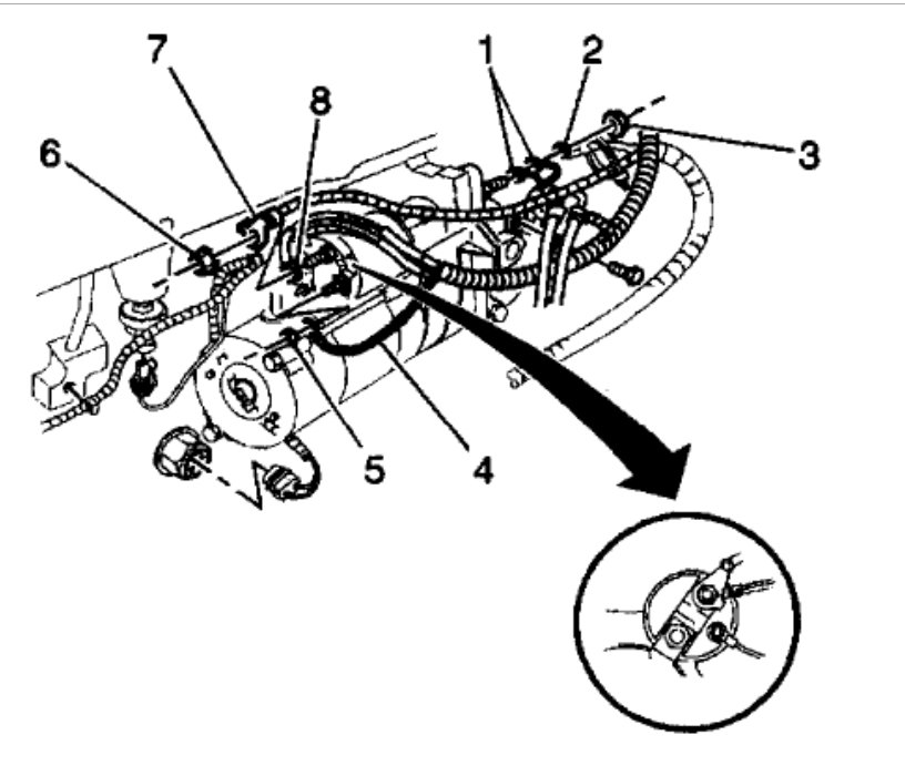

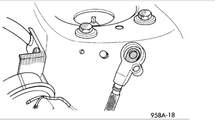

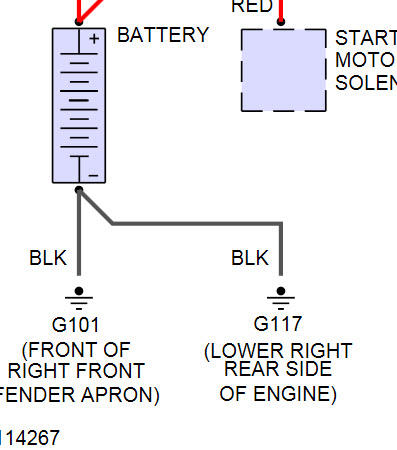

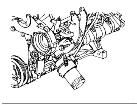

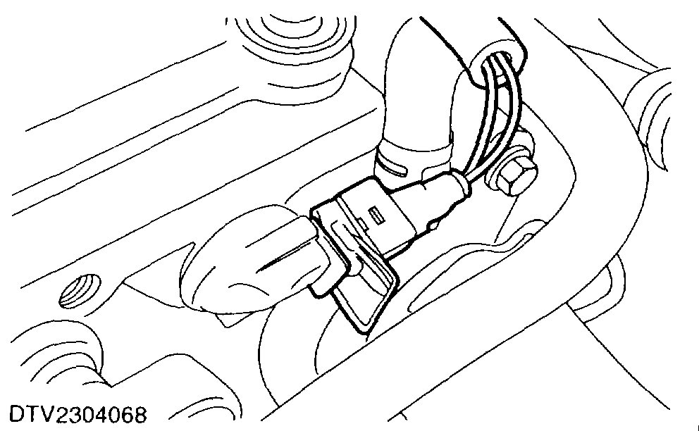

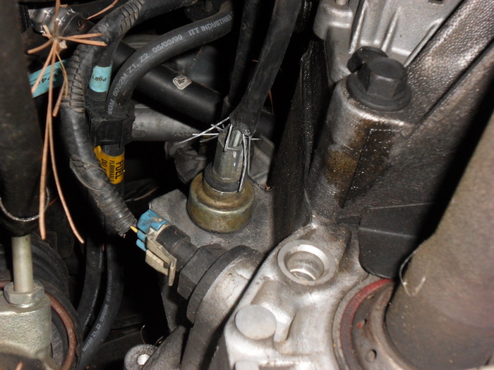

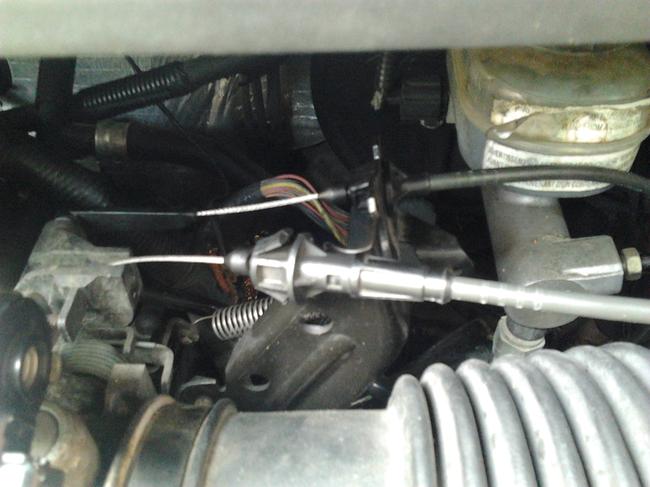

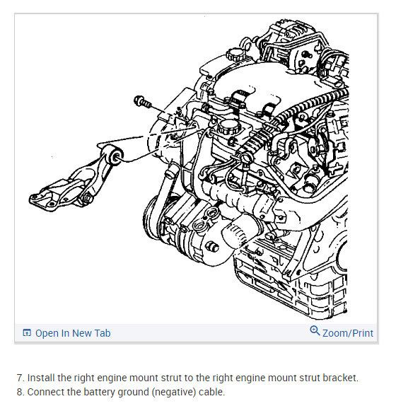

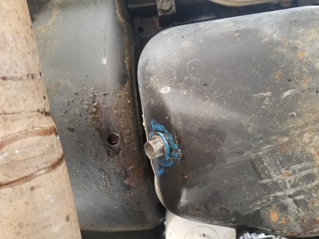

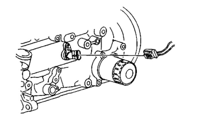

First, all sensor have a common ground. Additionally, there are two splices to tie them together. I attached a pic to help you locate the ground which is on the right front of the engine block.
Are you sure there isn't a vacuum leak or fuel pressure issue causing the computer to over compensate resulting in the fluctuation?
Let me know if this helps.

Is that right front when you looking at the front of the motor?

I just glanced at the readings on the live data. It had said all o2's were saying circuit fault. I inspected the harnesses and they looked okay, but I was more worried about the voltages. I may inspect them again, but as all 4 say it. It must be something else. Do you have a picture of where the ground should be?
Tuesday, August 20th, 2019 AT 6:51 PM
  • 110,192 POSTS
Welcome back:
It's the right front of the engine block. Take a look at the picture I attached earlier.
Let me know. Also, what trouble code are you getting? Also, check the ground. I have seen the connectors fail and end up with a really weak ground or none at all.
Tuesday, August 20th, 2019 AT 8:15 PM
BSHEPPARD84
  • 14 POSTS
P0161
P0141
P0155
i guess I don't understand the right front. Is that right front as in passenger side right front as if your sitting in the truck or standing in front of the truck which would make it driver side front? Sorry
Tuesday, August 20th, 2019 AT 8:22 PM
  • 110,192 POSTS
Welcome back:
Passenger side and no need to be sorry. Someone had to tell me once too. In automotive manuals, they give the side as if you are sitting in the driver's seat.

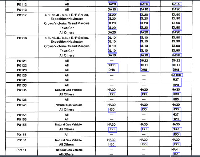

Now, the only code I can look up is the 155. Here is why:
Change Vehicle Bookmarks Library Request Conversion Calculator Technician's Reference - Collision
Search vehicle information
1999 Chevy Truck C 3500 Truck 2WD V8-5.7L VIN R
P0161
Vehicle ALL Diagnostic Trouble Codes ( DTC ) Testing and Inspection P Code Charts P0161
P0161
Under 8600 GVW Without C6P
Over 8600 GVW With C6P
I need the GVW

Okay, passenger side front of the block and it will be on the block itself or on the frame? Mine is below 8600.
Tuesday, August 20th, 2019 AT 8:34 PM
  • 110,192 POSTS
It should be on the block. At least that is what the schematic indicates.
Tuesday, August 20th, 2019 AT 8:40 PM
BSHEPPARD84
  • 14 POSTS

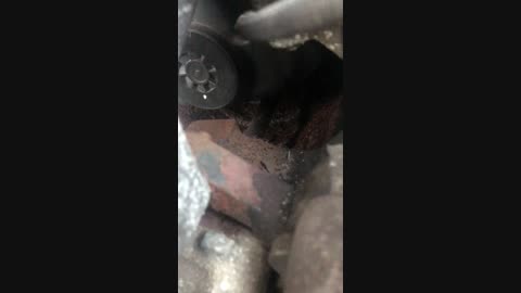

Okay, so I think I found the ground right below the mechanical pump block off plate. There is a battery ground there and right next to that on another ground post is a smaller ground. I followed it up and it has 4 black wires tje purple and I think redish pink wires. It goes into a big loom under the intake hat and looks like it goes into the PCM.

Either that ground is corroded. Didn't look too bad or I lost connection ground circuit inside the PCM.

Check the connector. They sometimes fall apart when touched.

I don't think I had any splices. I can't remember what I said, lol. So could I take the ground off the block for the o2's use it to check a positive wire and see if my test light lights up? And that would confirm a good ground from the PCM? I'm only assuming that the wires go to the PCM. When they go into that big loom I can't tell where they go but to the PCM is my logical guess.
Wednesday, August 21st, 2019 AT 7:17 PM
BSHEPPARD84
  • 14 POSTS

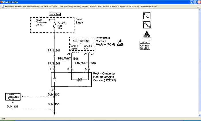

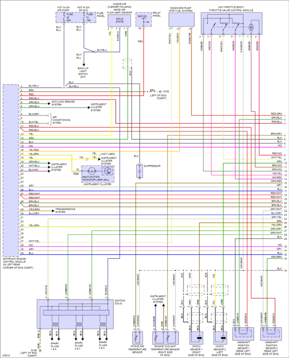

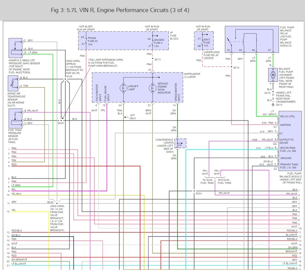

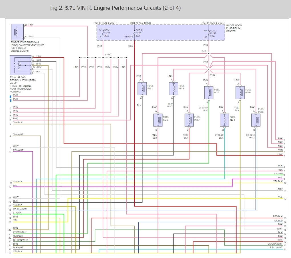

Also coming from the ground on the block the diagram shows them going to each o2. Are they going from the block ground directly to the PCM and then to the o2 sensors or going from the block ground to the o2 sensors then to the PCM?
Wednesday, August 21st, 2019 AT 7:23 PM
  • 110,192 POSTS
Welcome back:
Checking grounds that way usually works. However, in the case I described earlier, when higher voltage was applied to the ground, it failed. Do it the way you suggested but make sure the condition of the wiring is good.
If I recall correctly, power runs from the PCM to the sensor, then to the ground.

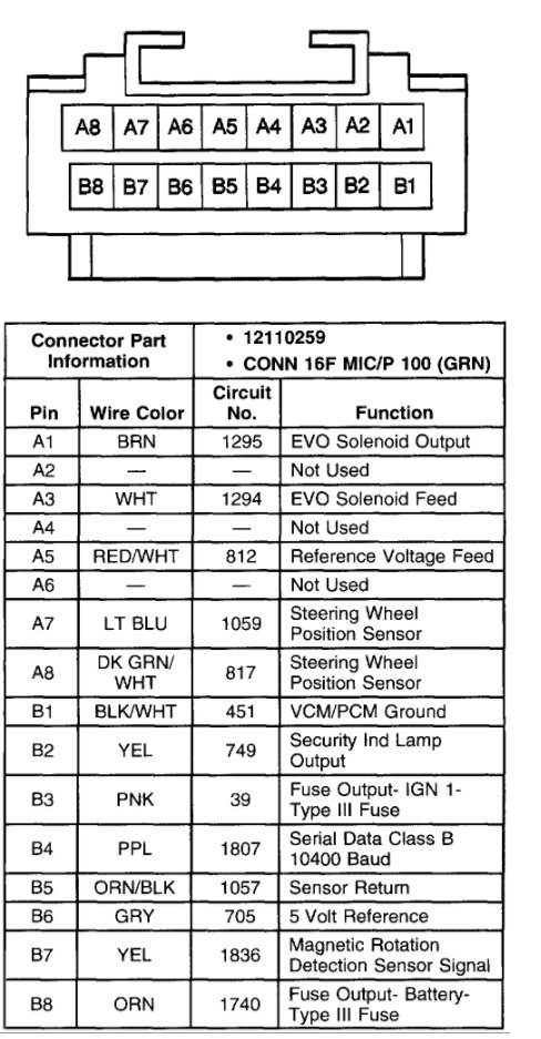

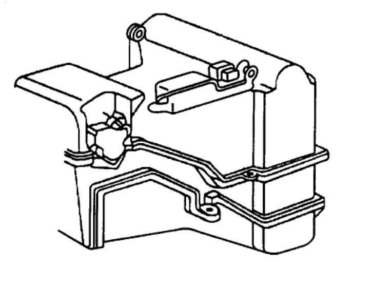

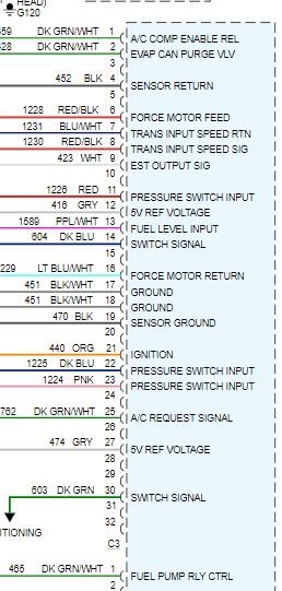

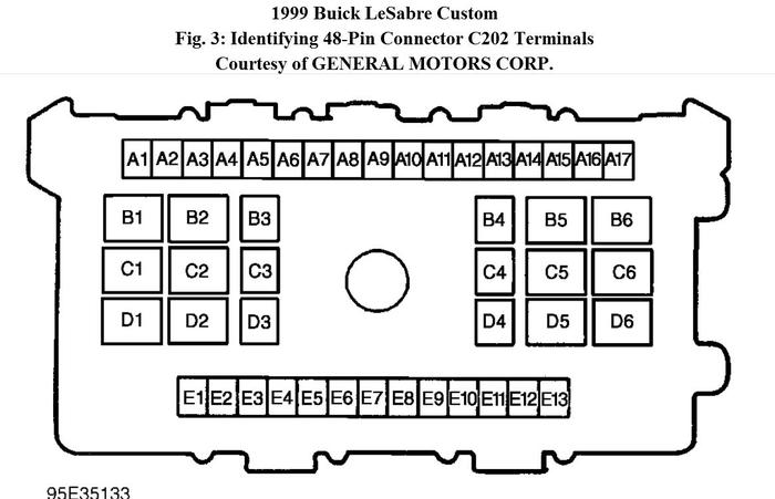

Would you happen to know or have a diagram of the which harness on the PCM has the grounds? Then I could run a continuity test from the PCM to the o2 grounds and see if there are any open circulates from the PCM to the o2's. Then go from the o2's grounds to block ground continuity.
Wednesday, August 21st, 2019 AT 8:38 PM
BSHEPPARD84
  • 14 POSTS
I meant open circuits.

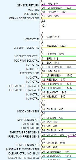

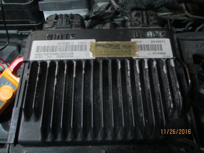

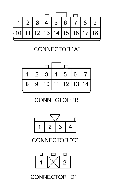

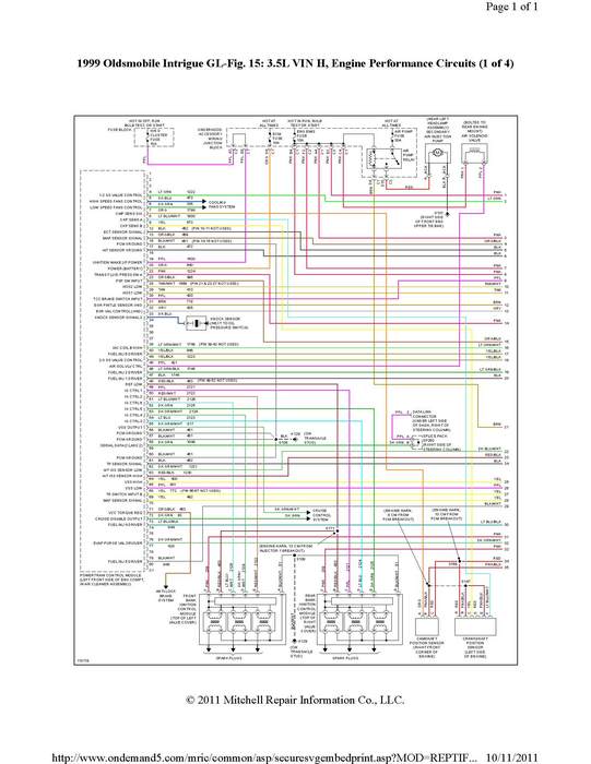

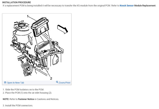

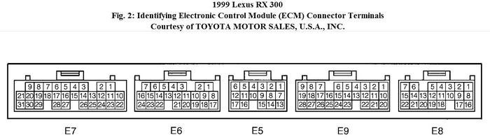

  • 110,192 POSTS
Welcome back:

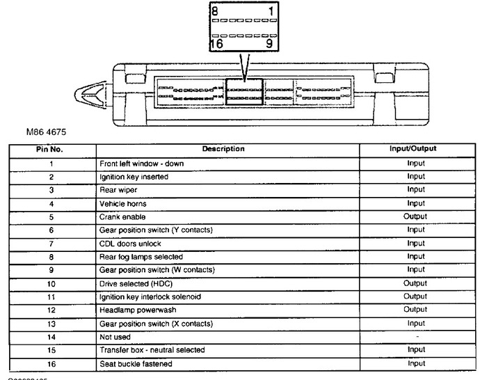

I attached several pics below of the control module pin-out. I overlapped them so you can follow them.
Thursday, August 22nd, 2019 AT 8:48 PM
BSHEPPARD84
  • 14 POSTS
I don't really know what you mean by overlapping them or which connector it is top or bottom plugs on the PCM on the fender, but I'll do my best to locate the wires for the o2's and see if they are corroded or something.
