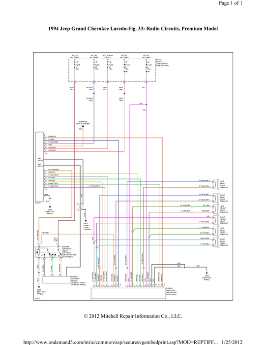

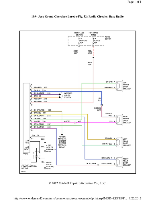

In the mean time I am trying to get the speaker wires hooked up on the radio and It seems like none of them work. Do you have a wiring diagram for the stock wiring? 94 jeep grand cherokee. Thanks

RIVERMIKERAT
  • 6,110 POSTS
You asked for stereo schematics. Here you go.
