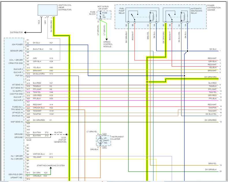

All the fuses are fine already checked. No check engine light, and light came on though, as well as the oil light has been on since it happened.

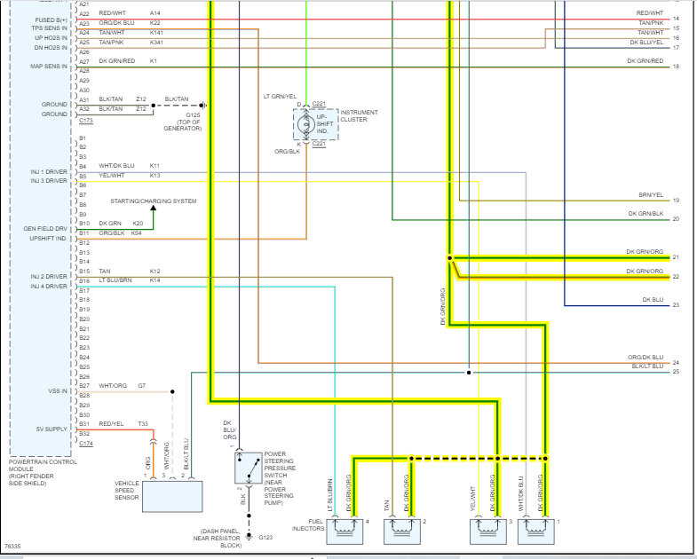

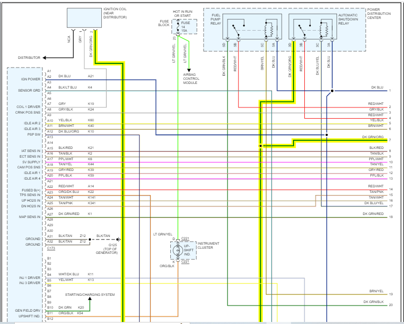

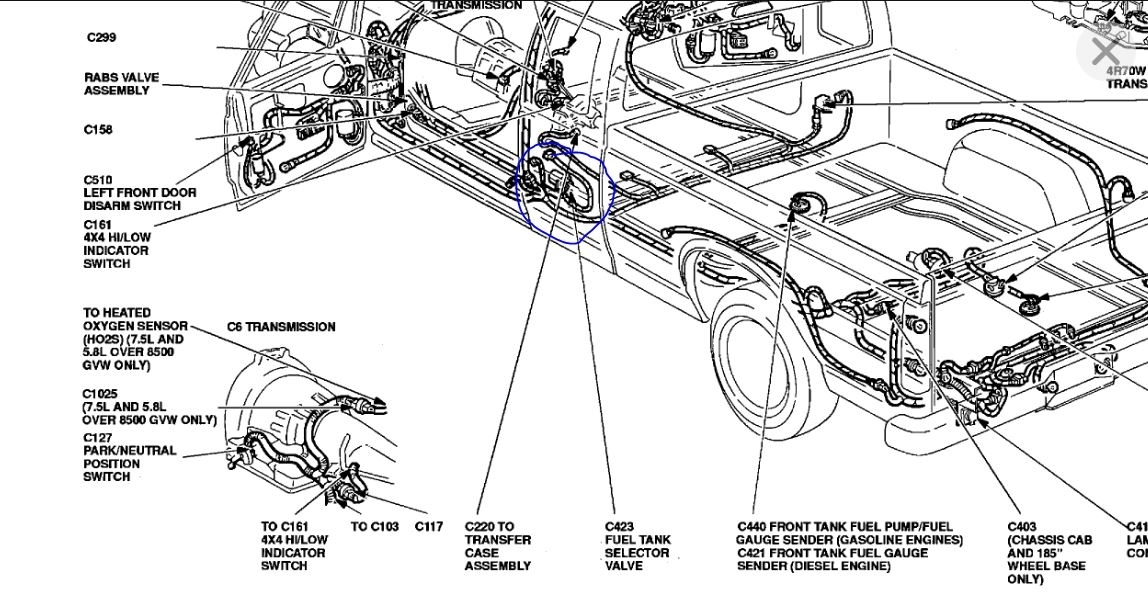

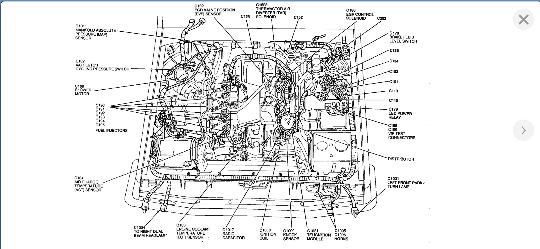

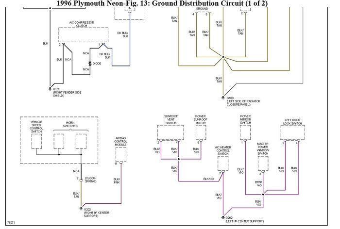

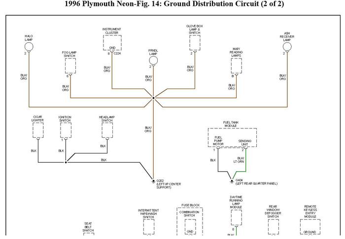

Okay, you just told me you checked them but how? Thanks

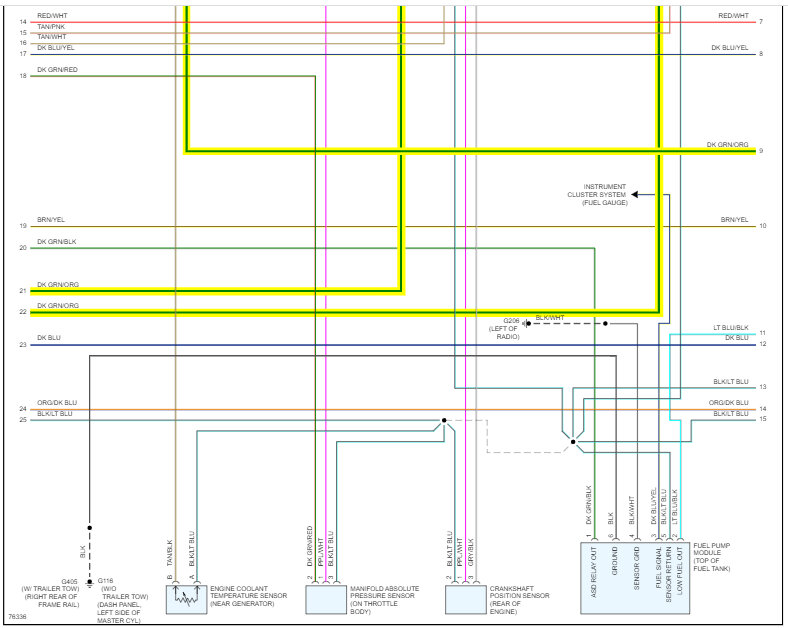

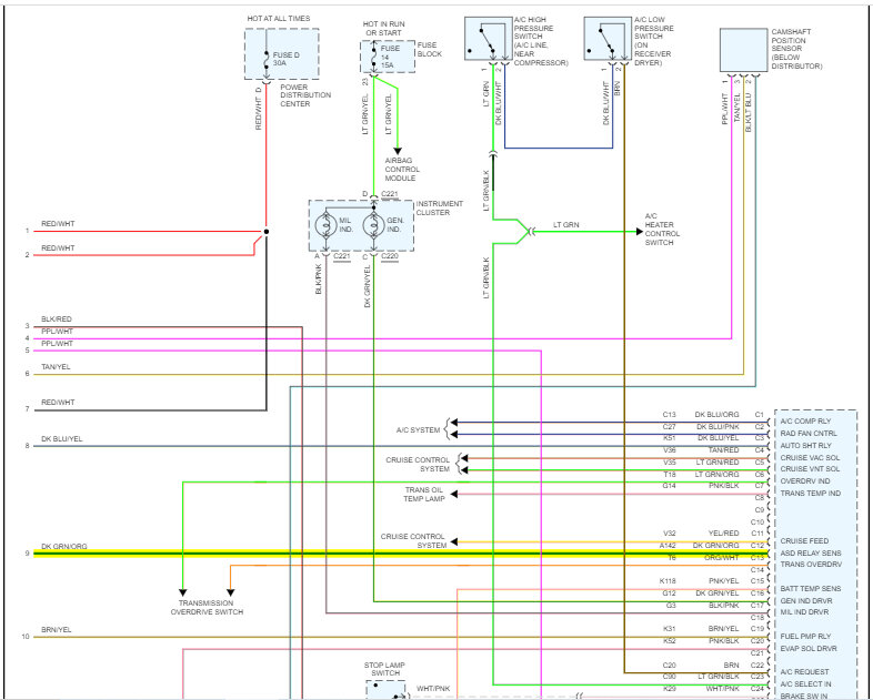

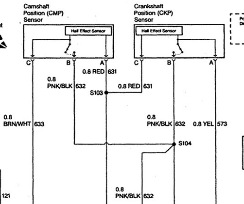

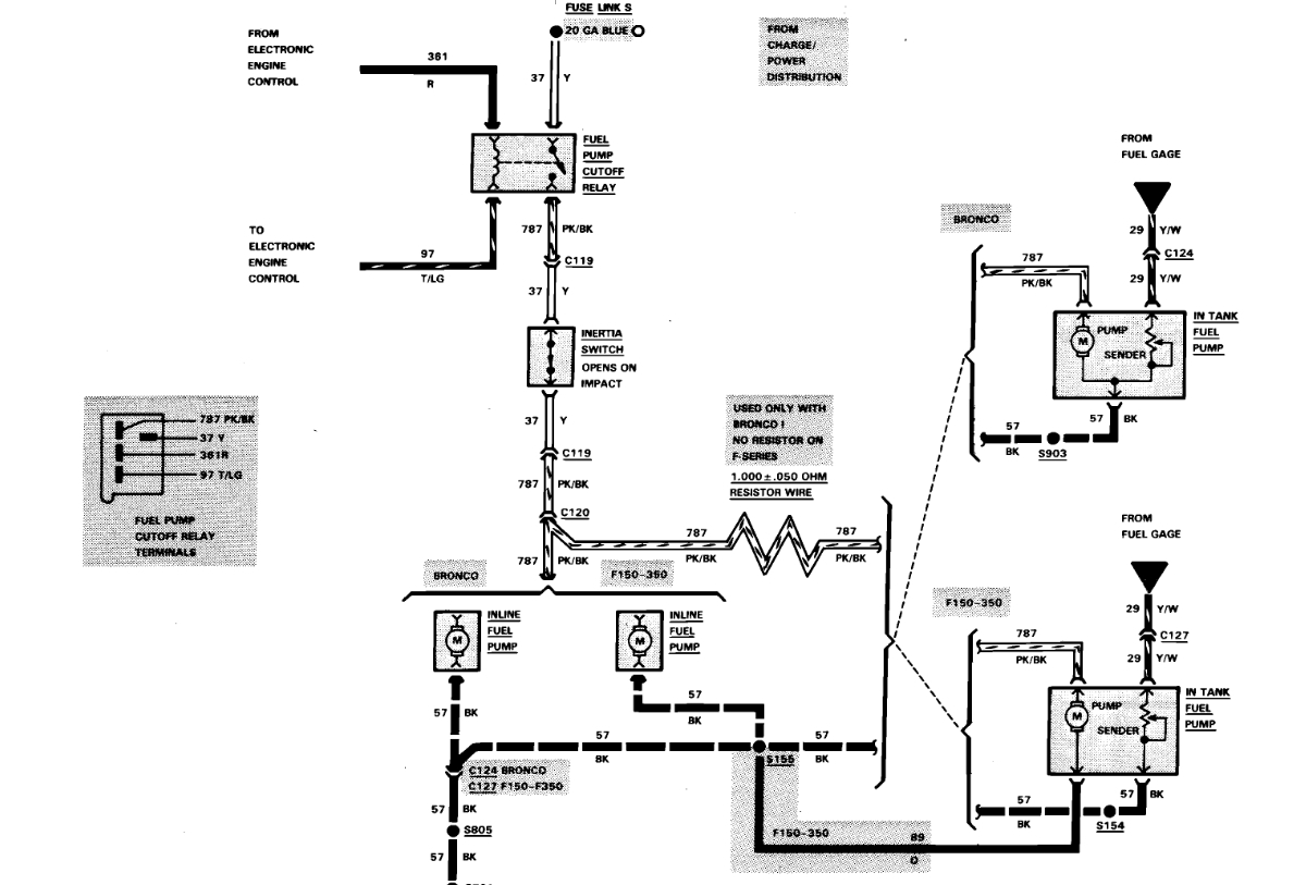

Okay, I attached a connector diagram. Use your test light and check for power to the ECM at the terminals marked power or battery to be sure it is getting power.

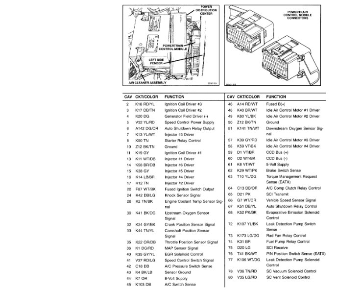

So, I just got an engine code. Two of them I already know 12-55, the other two are pointing at the cam shaft sensor, which I just replaced new. 54 from the cel codes and the code reader is giving p0340.
Tuesday, March 13th, 2018 AT 3:21 PM
Okay, is there any way you can borrow a volt meter to check the voltage at the cam sensor?
Tuesday, March 13th, 2018 AT 3:25 PM
