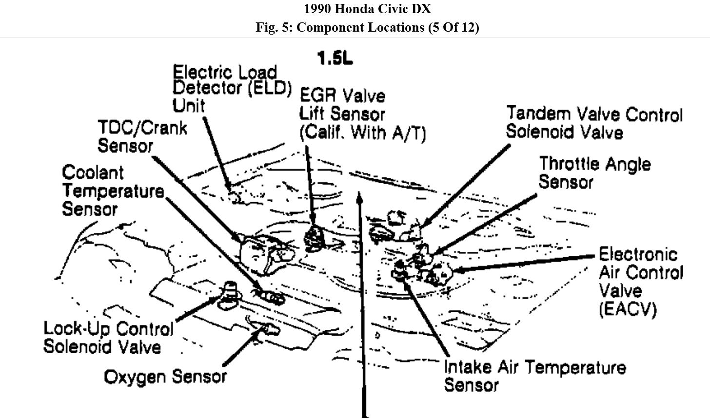

Your's is a 1.5 TBI (throttle body injections and the EACV is on drive side. See diagram, not too good graphic though.
If problem is intermittent, it most likely is a loose or contminated wire connector. Part should look soething like the one in video but your should ab all aluminium unlees it has ben changed to the newer version with the black cylinder.

It's the older version that's probably all alluminum. The video, though hte car isn't my car (93 has quite a few changes too), the name idle control valve tells me more than electronic control valve. If it controls the idle that explains the surging engine. But cleaning it I wouldn't want to try as its an air control valve that's Electronically controlled (EAVC). If the wires are clear or there's no loose connection, should it be replaced instead? Or would a cleaning be okay even though it's an electronic device?
