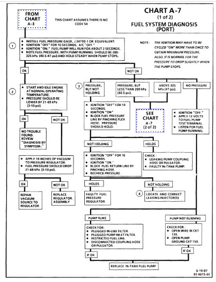

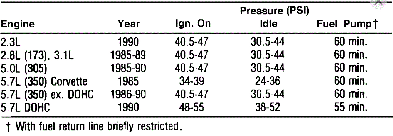

I attached the chart for you for the pressure.
With the key on, engine off, what is the pressure?
Tuesday, August 18th, 2020 AT 11:11 AM
ETERNALARIANNE
  • 224 POSTS
Key on, engine off, the pressure goes up to 35-40 then drops to 0 until I try to crank it then it goes back up to 35-40.
Tuesday, August 18th, 2020 AT 11:16 AM
Looks like your pump has a bad check valve.

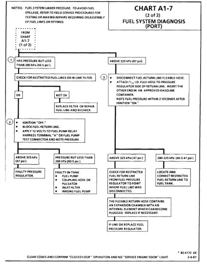

Here are flow charts to use in order to diagnose a fuel pressure problem for your car. Just remember that the problem of the vehicle stalling can be caused by many different things, so let's use these charts in order to either cure the problem or at least eliminate the fuel system as a possible suspect.
