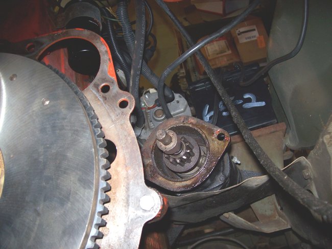

1955 Jeep CJ-5 will not start. Starter makes a clunking sound when activated and won't turn over. I have replaced the starter, solenoid and getting ready to replace the coil. This is a 6 volt jeep!

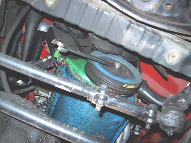

The new starter does what?

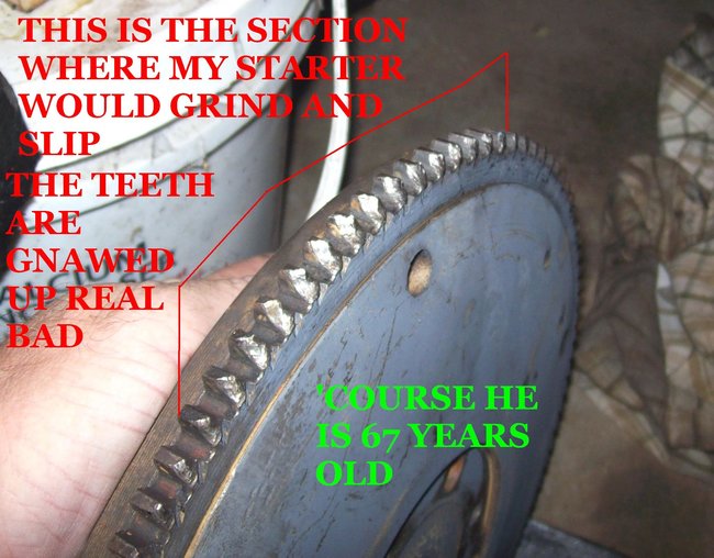

With the starter out, did you look at the teeth on the flywheel?
Can you get two full engine revolutions with a wrench, keys out, out of gear. (See my picture)

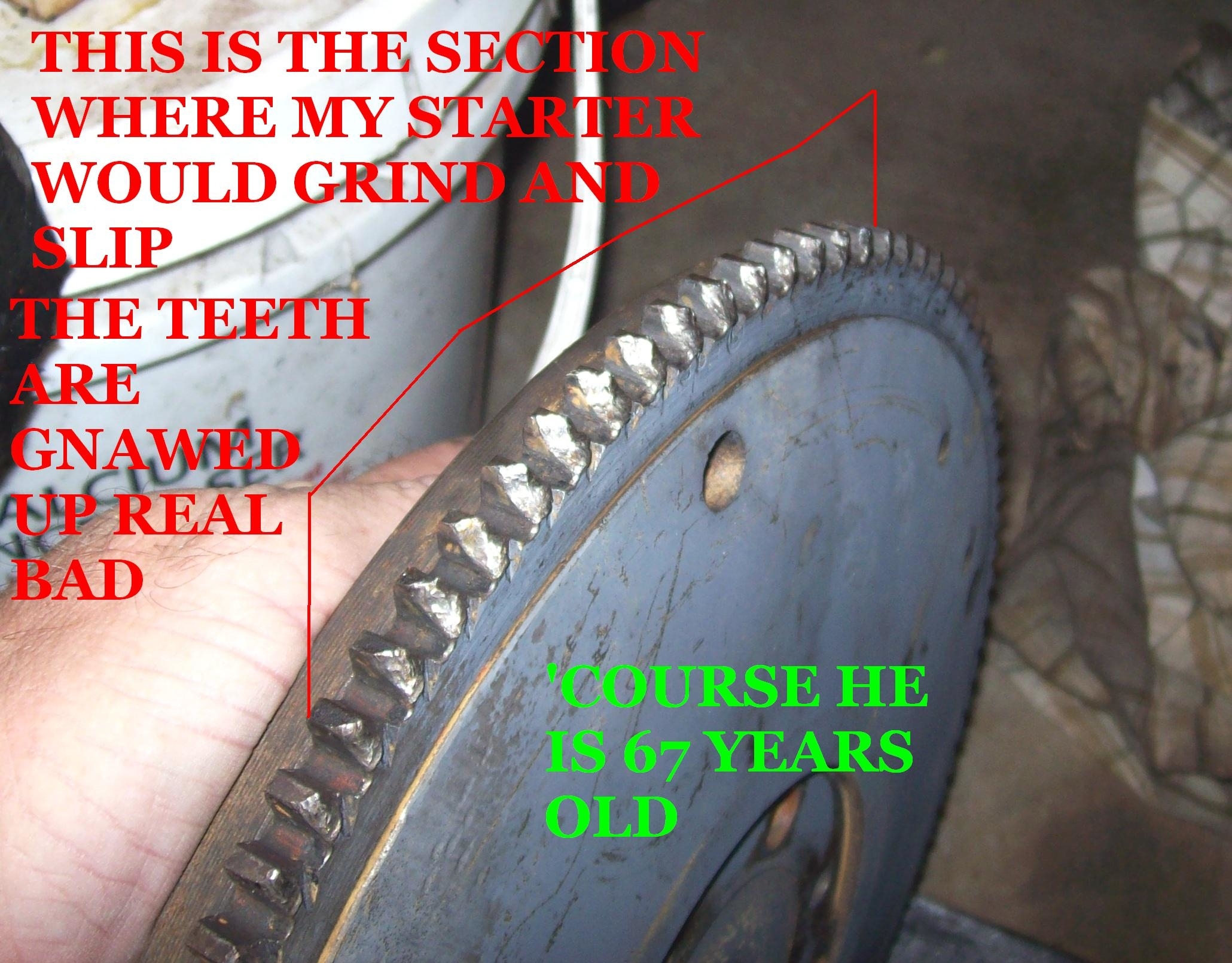

Picture 2 old ring
Picture 3 new ring
I have a 1946 134 (2.2) Flat head
