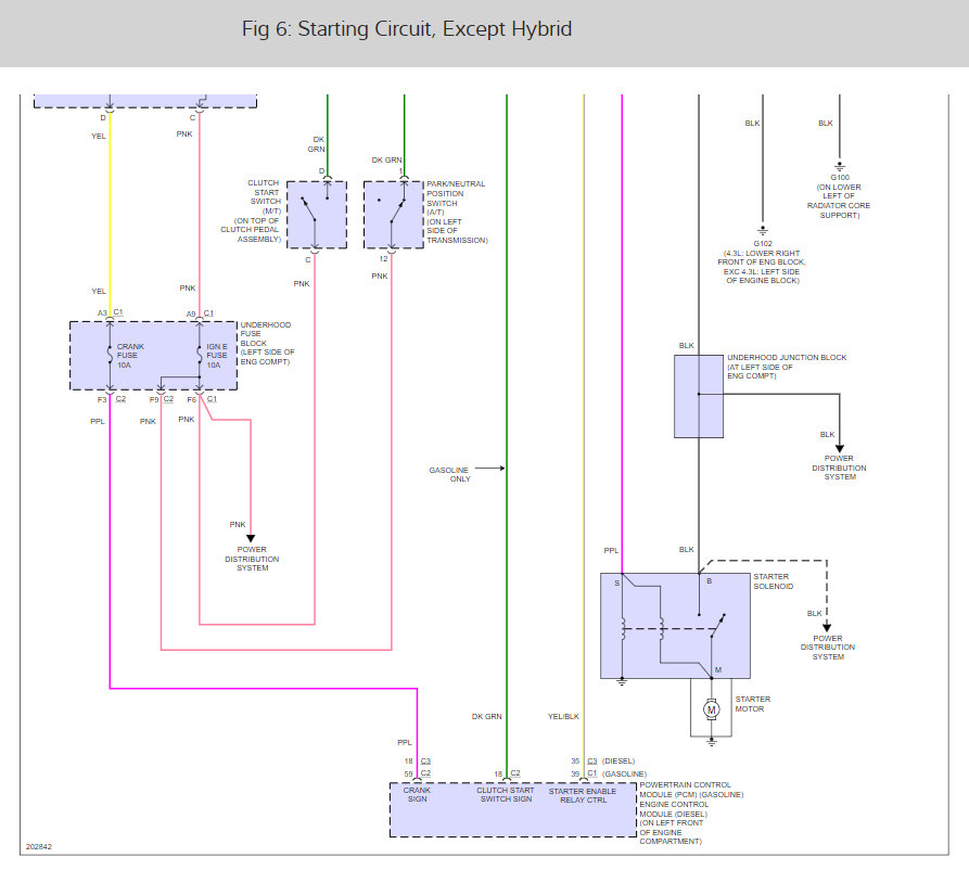

2005 Chevy Silverado 1500 HD 6.0 liter engine. I've been having this starting problem recently which seems to be increasing with time to the point where I drive my truck, stop for a short period and it will not start. My battery tester shows the battery as being 2/3 full charge. As far as I know the battery is 3 years old), or as long as I have owned the truck. I go to start the truck and it won't crank. Sometimes I get just one click from the solinoid, other times a rapid succession of clicking, but no engine crank. If I jump start it, it gives a reluctant crank, but then starts up. Today the same thing happened but no one to help jump start. I unplugged any chargers I had plugged into cigarrette lighters. It did the same thing, but after about 5-10 minutes after trying it repeatedly with the same results, the engine finally cranks and the truck starts up. I have checked my battery terminals for corrossion and snugged terminal bolts down. I see no loose connections at battery. Not sure, but I think it may be a starter or a ignition switch problem. Sometimes when I turn the vehicle off, it seems like the dash lights stay illuminted when key is removed. One thing to note is that I recently had an alcohol ignition interlock device on the truck and it was removed about 6 months ago. About the time the issue started. Related or not, I do not know. I'd appreciate any feedback I can get on the issue as I don't have money just to throw at the truck until I find the answer.

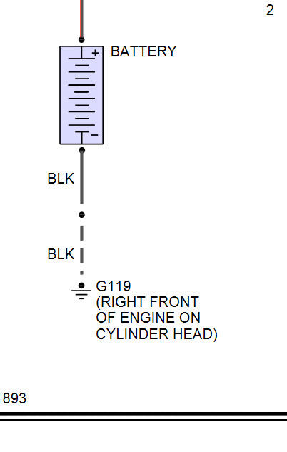

It sounds like you have a bad ground but to be sure lets look at this guide. This guide can help us fix it
Check out the diagrams (Below). Please let us know what you find. We are interested to see what it is.

Thanks Hmac300. I have checked the battery ground connection. It is snug and corrossion free. Today it is starting, reluctantly, but starting. I have checked all the wiring associated with the battery, ground, alternator, starter and all seem in good condition, corrosion free, and tight. I'm leaning towards the starter or the relay. But seeing how I'm getting the clicking when I turn the key, I would imagine the relay is probably working fine. I have been reading some of the others forum posts. I could remove the starter and have the auto parts store recondition it. Any thoughts on that?

Thy can test it first to see I f that is the problem. Also have them check battery for condition including load test that may be the problem as well even if it's new

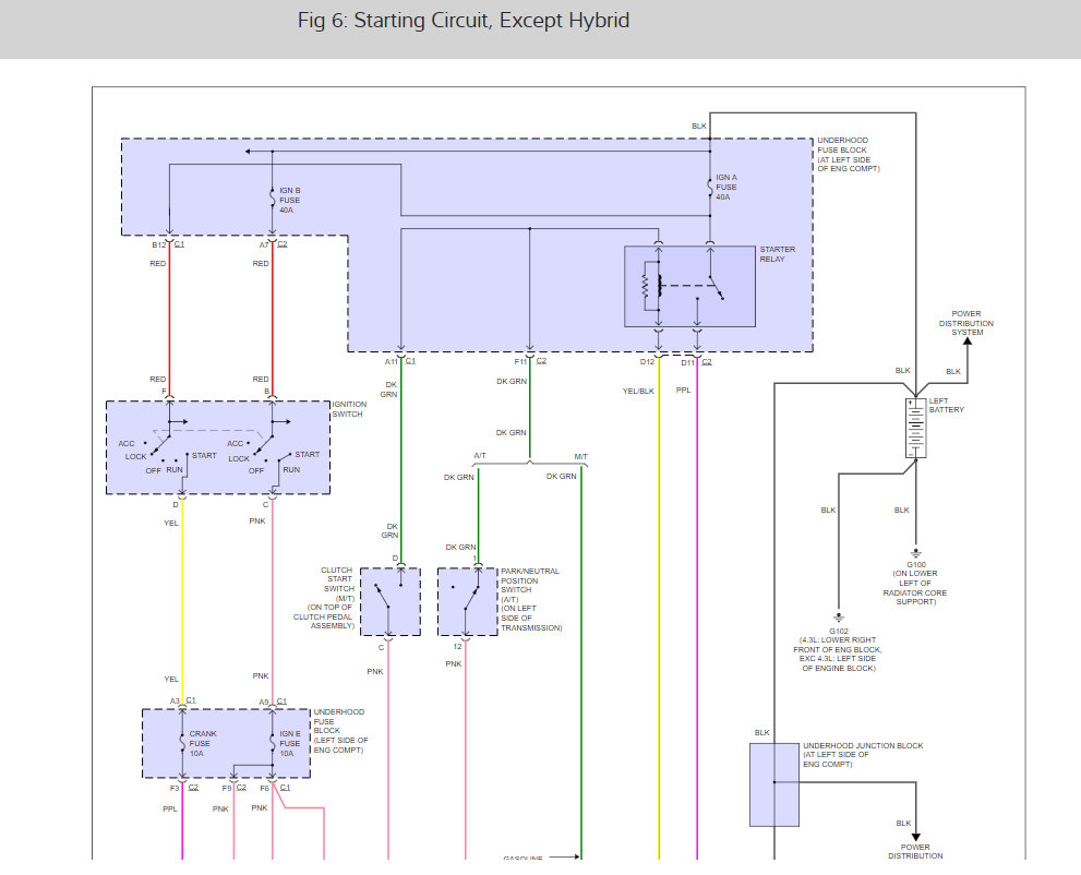

When you say will not crank you mean the starter motor is not working? If so this guide will help get us started.
Here is the starter wiring diagrams so you can see how the system works. Check out the diagrams (below). Please let us know. Cheers, Ken

Tried to start and got buzz and click all electrical appears good radio and lights work fine battery indicator shows good charge. Lights on dash go blank when key is turned with the buzz and then a click when released. Could it be relay, solenoid or starter? Can I test relay?

Your best bet would be to see if the purple wire at the starter has power with the key in the start position?If so try tapping on the starter with a hammer and the key in the start position and see if it starts?
