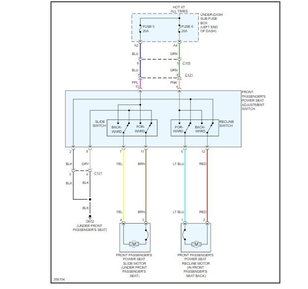

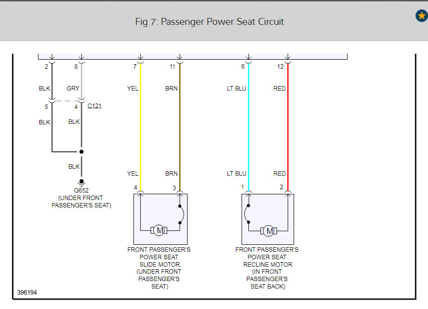

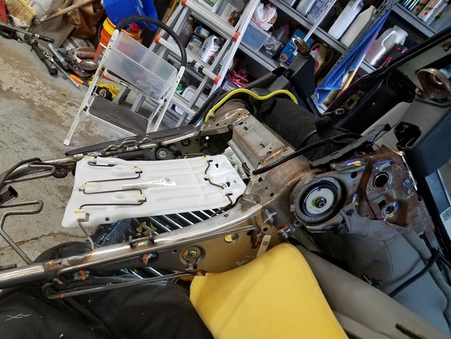

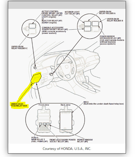

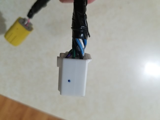

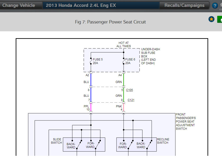

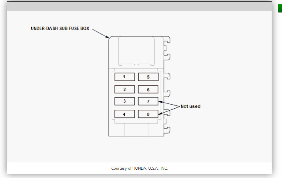

Hi, I have a Sport model with a maual passenger seat and purchase a electric passenger seat from a 2013 Honda Accord EX-L 4 cylinder engine. Would you be able to help me rewire from the manual seat to the plugins for the electric? What I'm thinking is all I would have to do is add 2 power lines with 20 amp fuses from the fuse block to the 2 switches for forward and back and tilt forward and back. This seat doesn't have the other functions that the drivers seat does which is why I wanted to do this. Honda passenger seats suck in every way. If it's not feasible I'll throw the electric one away and suffer on my 3,000 mile trip in October. Thanks, Phil

That is correct. The two power wires coming into pins #4 and 10 of the Power Seat Connector are both 20A fused circuits. You will also need to run ground wires from pins #2 and 8 of the Power Seat Connector to a ground. You can use a self tapping screw and make your own, just make sure all the paint is removed where you are placing the ground, to make good metal to metal connection, a toothed star washer would be preferred(not a necessity), but ring connectors for the wires are required. Also a little dielectric grease will help prevent corrosion from building up on the ground. In the diagrams down below I have included all the information that you will need. Please get back to us with how everything turns out.

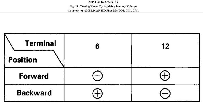

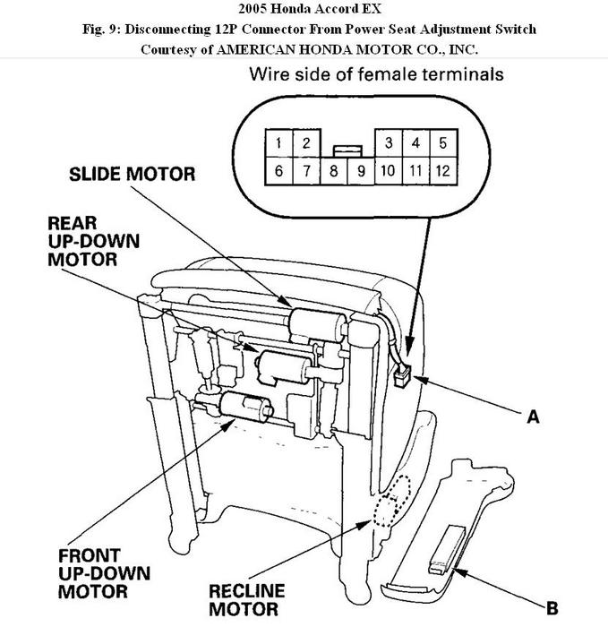

MOTOR TEST
DRIVER'S 8-WAY ADJUSTABLE POWER SEAT
1. Remove the driver's seat.
2. Disconnect the 12P connector (A) from the power seat adjustment switch (B).
3. Test each motor by applying battery voltage and body ground to the terminals.
4. If the motor does not run or fails to run smoothly, check for an open in the driver's seat wire harness between the 12P connector and each motor connector. If the harness is OK, replace the motor.

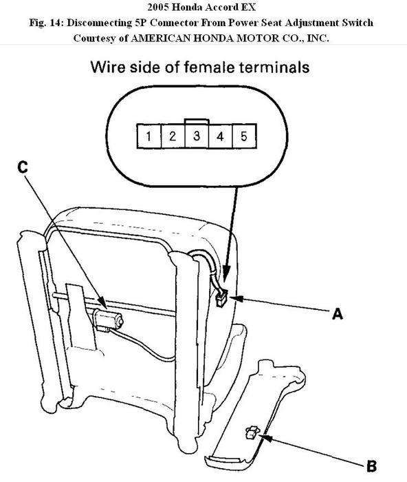

DRIVER'S 2-WAY ADJUSTABLE POWER SEAT
2. Disconnect the 5P connector (A) from the power seat adjustment switch (B).
3. Test the motor (C) by applying battery voltage to the 5P connector No. 2 (or No. 4) and ground to the No. 4 (or No. 2) terminals. The motor should run.
4. If the motor does not run or fails to run smoothly, check for an open in the wire between the 5P connector and the motor 2P connector. If the harness is OK, replace the motor.
