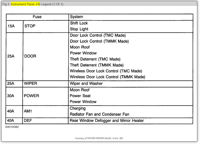

When I push either the driver or passenger door lock switch or key fob all doors will lock or unlock.
However, if I keep pushing lock/unlock/lock the drivers door will stop responding, but the other three doors will operate properly. Then, if I push lock/unlock repeatedly 4-5 times then the passenger door will stop responding. The back doors will always work properly.
The main problem is that sometimes in the afternoon (it seems to be correlated to heat because the problem is always worse in the afternoons) the drivers side door will not work at all. When I use the key fob I will think I'm locking all the doors and the drivers side door will remain unlocked. Or when I try to unlock the vehicle with the fob all the doors will unlock except the drivers side.

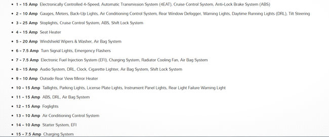

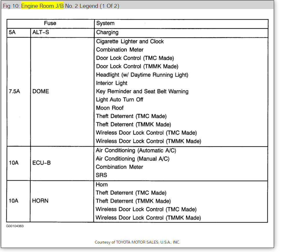

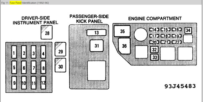

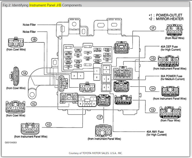

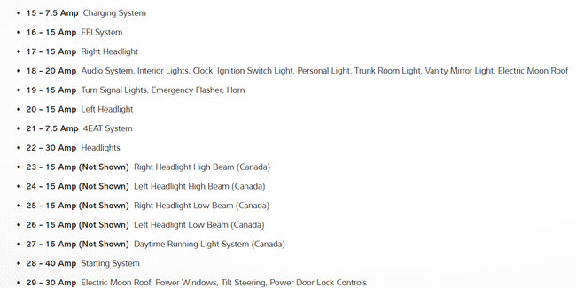

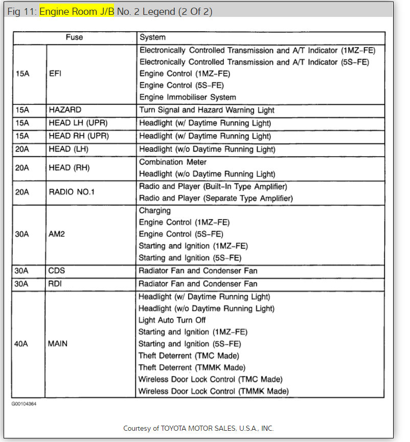

It could be the main switch but to be sure lets start by checking the fuses here is a guide to help with the door locks wiring diagrams and fuse panels in the diagrams below.
Aug 12, 2019 at 5:45 PM
ELMACHIN
thank you it was the door lock fuse #25 in the fuse panel.

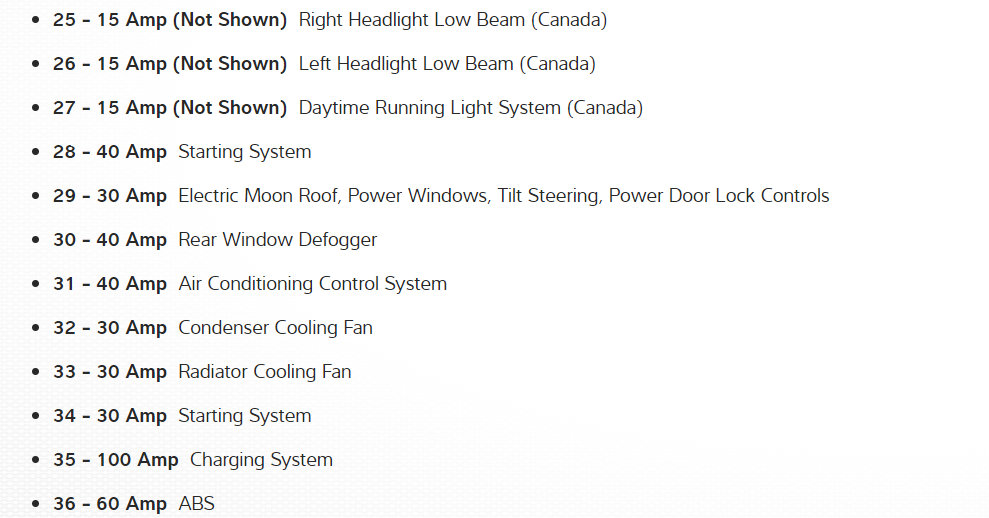

I have tried to find the pink 30A fuse. I have looked and looked. Driver side panel, driver side kick panel, passenger side kick panel and all three fuse and relay compartments under the hood. I do not find a fuse for the power doors and windows. The manual has a diagram but it is not correct for my car (Canada).
Help. Where do I find that damn hidden fuse?
Dec 17, 2020 at 12:18 PM (Merged)
  • CAR REPAIR CONTRIBUTOR
  • 54,354 POSTS

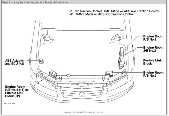

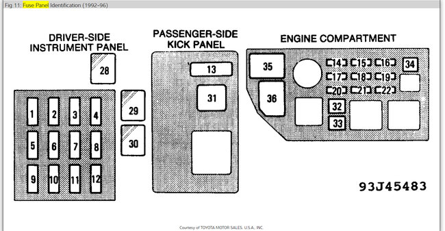

There is a main power relay and a 30 amp fuse in the interior fuse panel that need to be checked. here is the fuse and relay location with how to check the fuse and relay:
and
Check out the diagrams (below). Please let us know what you find.

TOYOTECH
  • 33 POSTS

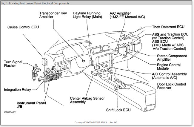

to the left of the steering wheel there is an access panel- behind it is a fuse block that contains a 20 or 30A fuse for the windows and door locks. It has a clear plastic top about half the size of a postage stamp.You should be able to see the fuse link in it and whether or not it is intact or burned. If the fuse is good, you may have broken wires in the d/s door harness-open the door and you will see the rubber sleeved harness leave the door and go into the body by the left kick panel- the wires typically break there. If the fuse is blown you may have a motor or actuator that is either shorted or drawing too much current and/or a problem in the wire harness.

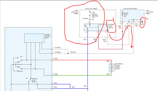

It sounds like the main power relay is not working. Here is a guide to help you test the relay and the relay location along with the wiring diagrams so you can see how the system works:
#29 is the power relay. Check out the diagrams (below). Please let us know what happens.

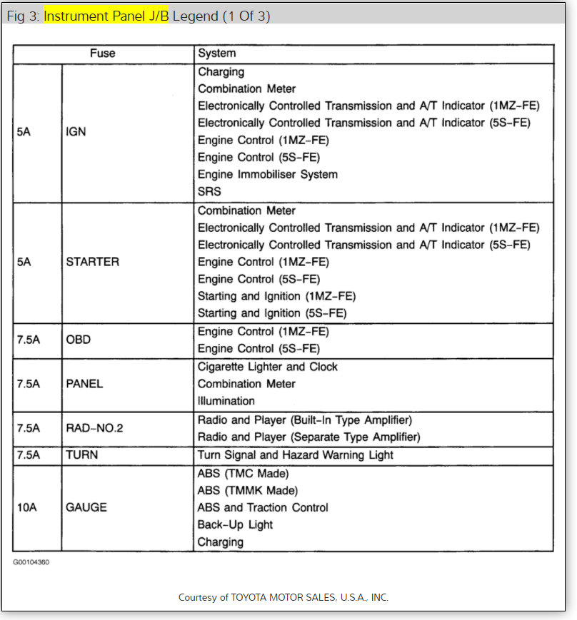

SPRAVECEK
Hi my power windows and locks are not working..i cannot find the fuse that is causing this problem. i have checked every fuse twice. Would it be under the hood or in the drives panel? i also checked the kicker panel on the floor. Please help
Dec 17, 2020 at 12:20 PM (Merged)

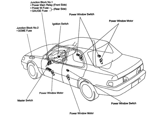

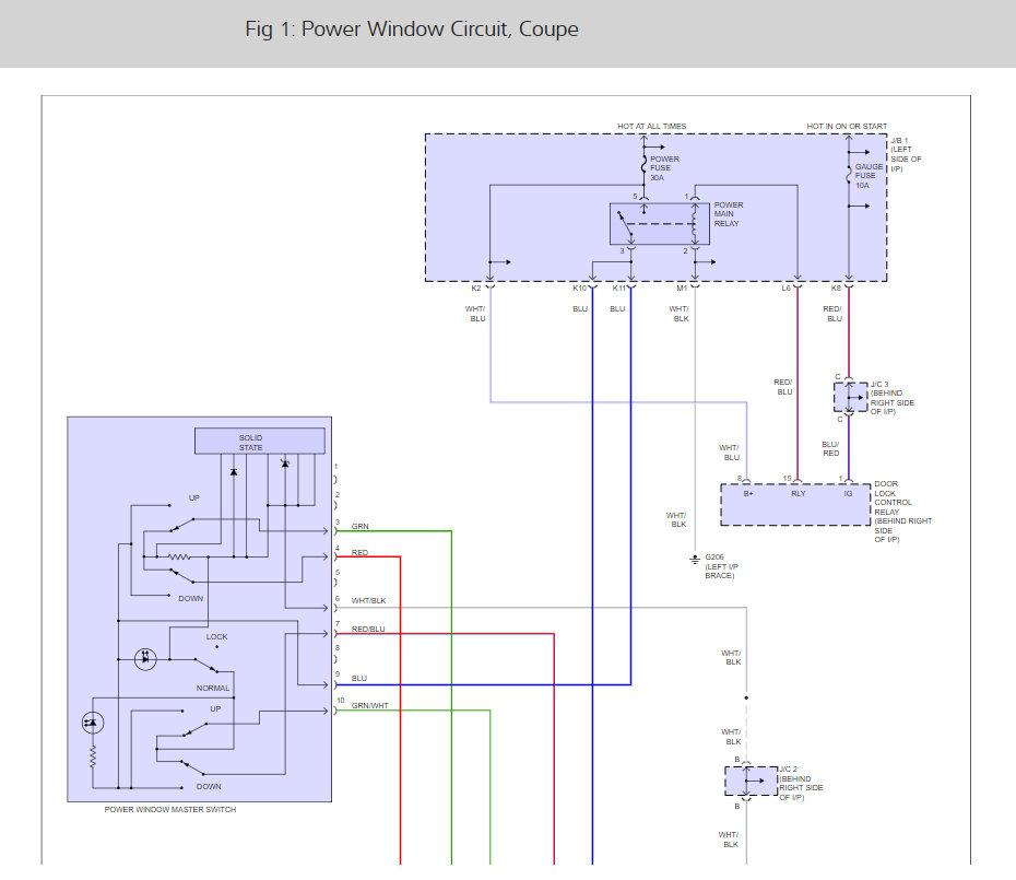

  • 75,992 POSTS
For door locks/windows -check power fuse 30qmp and gauge fuse 10amp in the J/B #1 left side of instrument panel. If okay check the main relay same location
SPRAVECEK
i will donate if we can find the problem..all of my fuses are fine. Unless its a relay that im not sure how to check

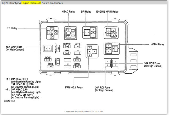

  • 75,992 POSTS
Are both fuse as mentioned earlier are okay if so do below
Find the main relay on fuse/relay block no.2 on left inner fender panel. Swap it with a like relay or replace it. Did it work?? No do below
Now open the drivers door panel at the master switch check for power at the blue wire, turn key On. Do you have it-let me know

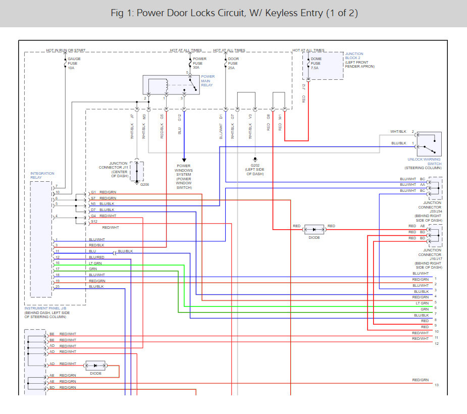

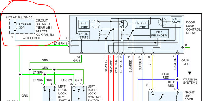

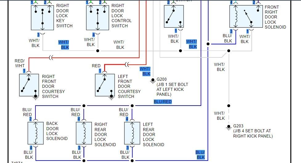

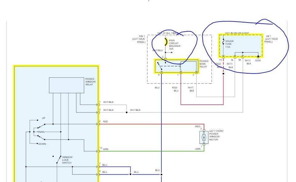

Good morning,
I attached the wiring diagrams for both areas. They are both powered off the same breaker in the fuse block. Verify power on both sides of the circuit breaker with the key in the on position.

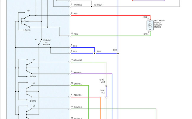

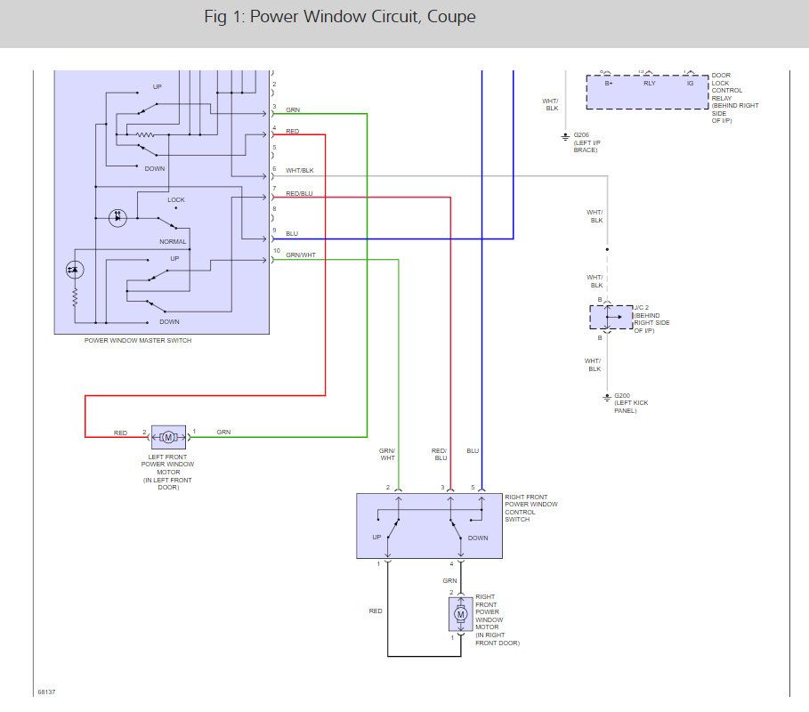

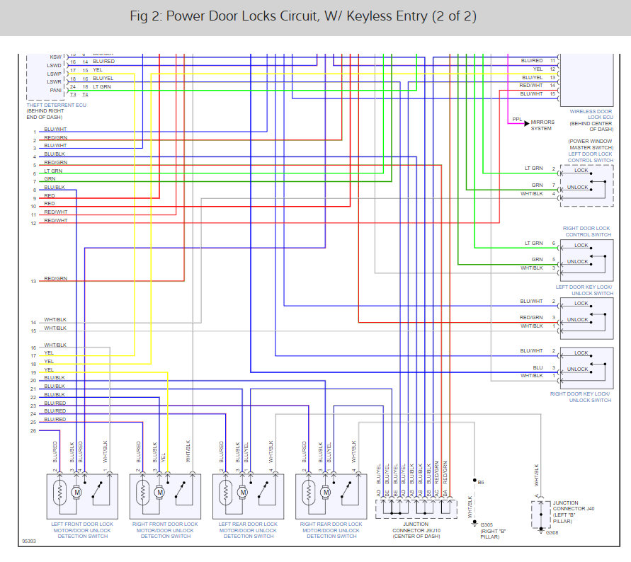

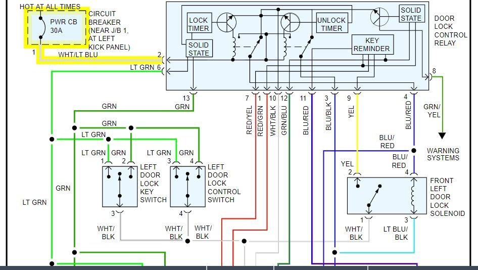

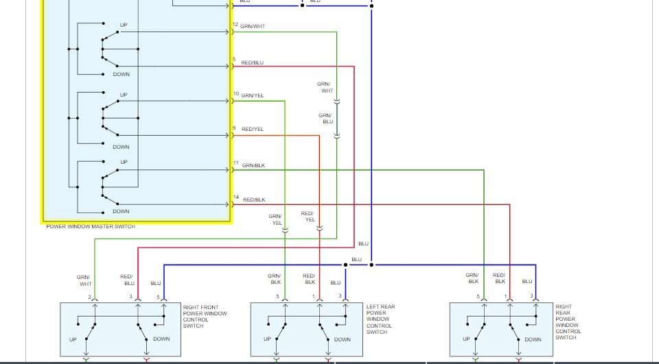

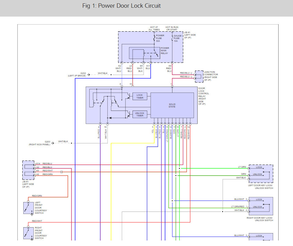

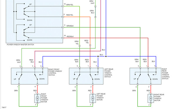

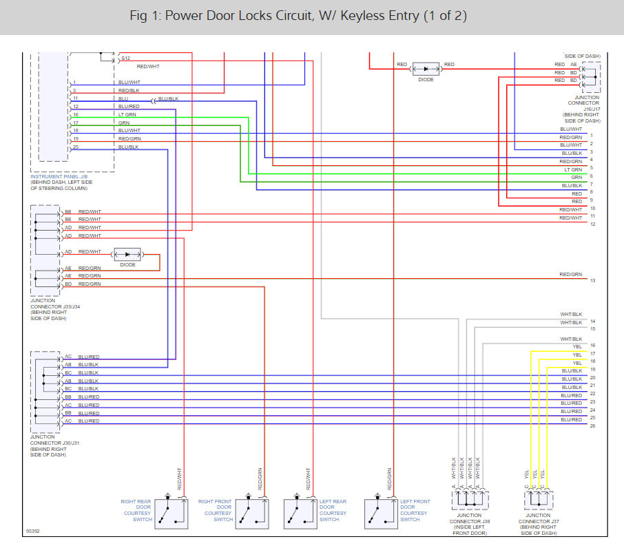

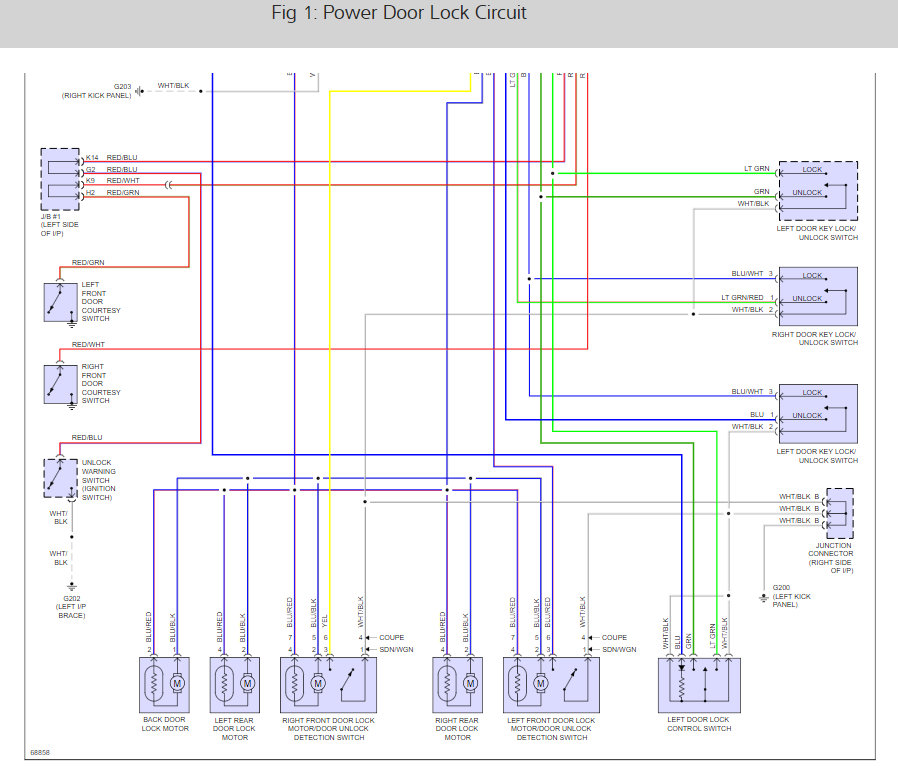

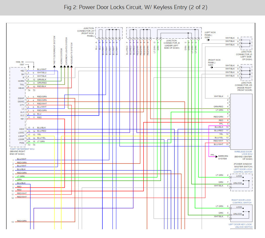

  • 110,190 POSTS
I have attached a few pics below of the wiring schematics. The first three pertain to the windows. Picture 4 shows power for the locks. Since none of them are working, the first thing you need to confirm is there is power from the circuit breakers. For the windows, you need to check for power to the blue wire and the white/black wire. As far as the locks, the white/light blue wire should always have power.
Here are a few links you may find helpful:
If there is power, check to make sure the grounds indicated are good.
