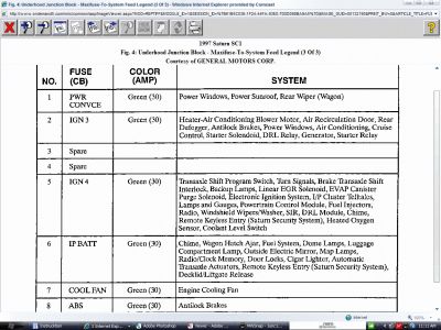

MWRIGHT
WON'T START EVEN WITH A JUMP. IGNITION MAKES NO NOISE AT ALL. HEAD LIGHTS WORK, RADIO WORKS, INSIDE LIGHT DOESN'T WORK AND TRUNK RELEASE DOESN'T WORK. PLEASE ADVISE.
CHECKED ALL FUSES AND SEEM TO BE FINE. WHAT ELSE COULD IT BE?

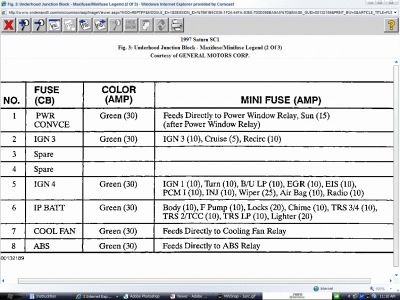

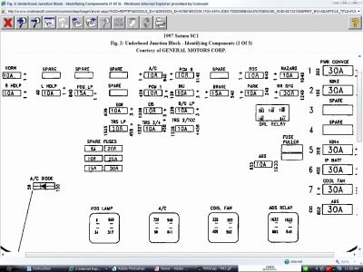

You did not tell us what model so this is for the SC1, Check all fuses marke IGN...Under hood junction block, on the drivers inner fender.
https://images.2carpros.com/forum/automotive_pictures/62217_Junc_1.jpg
https://images.2carpros.com/forum/automotive_pictures/62217_Junc1_1.jpg
https://images.2carpros.com/forum/automotive_pictures/62217_Junc2_1.jpg
