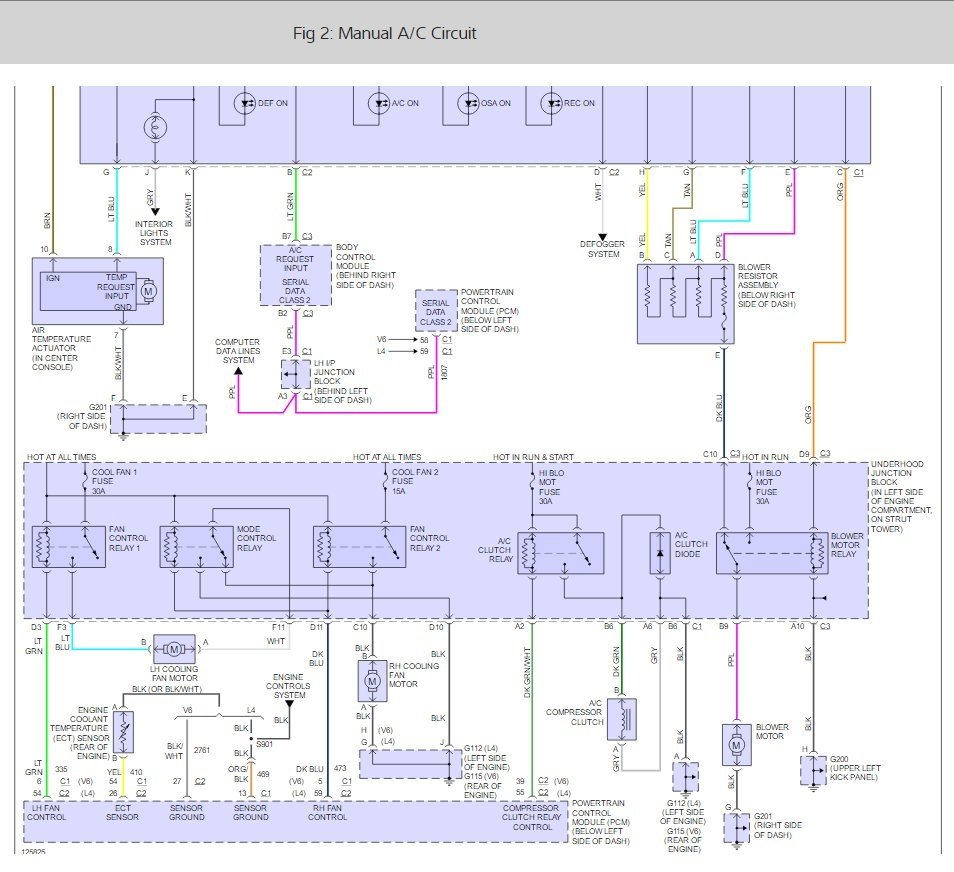

My car starting over heating so I checked under the hood and notice I had lost antifreeze from the surge tank. I added more antifreeze, started the engine and noticed the cooling fans were not running. Do they turn on only when needed or is there a problem with a fuse or relay? Thanks for the help!

They turn on at a predetermined temperature. Do they turn on if you allow the temp to start going beyond normal?

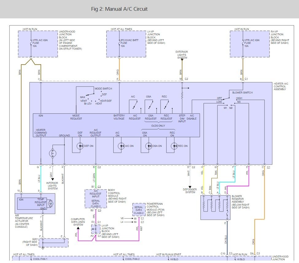

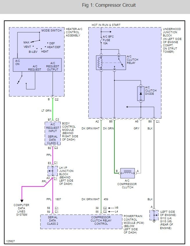

Hi my aleros cooling fans will not come on the car overheats at idle but is fine on the highway I checked all relays and fuses jumper wired fans and both worked when wired straight to battery any ideas about whats going on also I wondered could the fact that the ac is not working have any thing to do with it could it be possible that the pcm reads no pressure and does not turn on compressor fan because fan should come on when ac button is on right?

It's possible, check for faulty A/C pressure switch, also test out the engine coolant temp. Sensor.

Cooling fans don't come on with AC, and now realize AC clutch doesn't engage when push the AC button

It sounds like the system has lost power so I would start by seeing if the fuses have power on both sides and then I would check the air conditioner relays. Here are some guides and air conditioner wiring diagrams to help you do some testing and get the problem fixed.
and
and
Please run some tests and get back to us so we can continue helping you.
