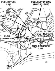

I have a 2001 Jeep Grand Cherokee with a 4.7 liter V8 and 148,000 miles. Towards the beginning of this year, the Jeep developed a problem where it will stall as I come to a stop. It doesn't do it all of the time, but it is becoming more frequent. I previously read that this problem may be due to a faulty camshaft position sensor or even the crankshaft position sensor. I've replaced both sensors, but the problem remains. The vehicle does start back up once it has stalled, but sometimes it takes a few attempts. I initially thought it may be temperature dependent, but it happens regardless of cold or hot ambient conditions. I receive no check engine light when it stalls. Your help is greatly appreciated.

No codes are present (I took the Jeep to AutoZone and had them check for codes). In regards to a tune-up; I've had the injectors cleaned, new spark plugs, new air filter and an oil change with new oil filter. I was also told that if the problem was the fuel filter, I would have problems while at highway speeds or while accelerating (especially during hard acceleration), but not while idling or coasting to a stop. I'm really not sure what to check next. Your help / advice is very much appreciated.

Ok check your fuel pressure at an idle and at higher rpm it should not be less then 44.2 psi

Problem Fixed! It turned out to be the Fuel Filter/Pressure Regulator (all one piece). It was intermittently failing to maintain sufficient pressure during coast down. It was $29.99 at AutoZone and wasn't too terrible to remove / install. Thanks to all those who provided advice.
