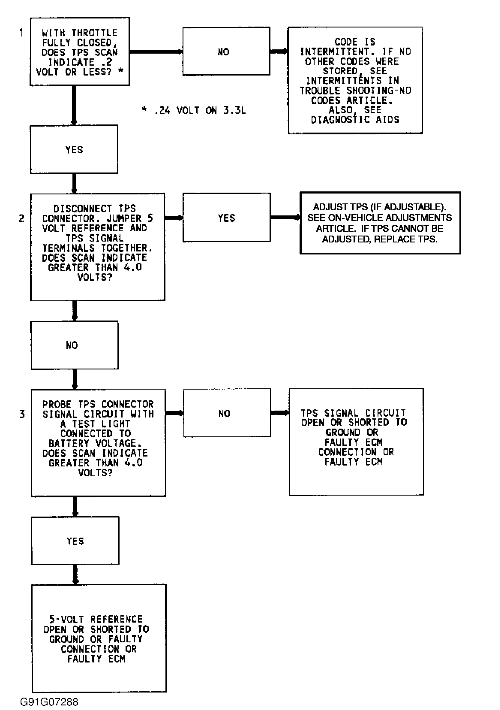

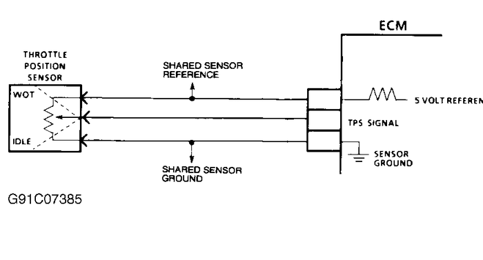

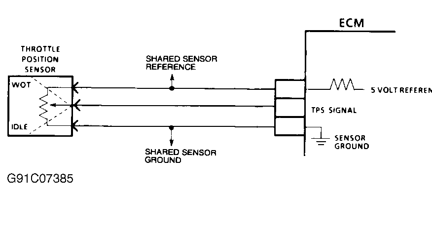

Too fast an idle speed. If an engine without computerized idle speed control is idling too fast and refuses to come down to a normal idle speed despite your best efforts to back off the carburetor idle speed screw or air bypass adjustment screw (fuel injection), air is getting past the throttle somewhere. Common leak paths include the carburetor and throttle body gaskets, carburetor insulator spacers, intake manifold gaskets, and of course, any of the engine's vacuum fittings, hoses and accessories. It is even possible that leaky O-rings around the fuel injectors are allowing air to leak past the seals. Another overlooked item can be a worn throttle shaft and a defective idle speed speed control motor/valve stuck in the extended (high idle speed) position/throttle position sensor. Also the throttle plate could be binding in its bore and kinked accelerator cable, coolant temperature sensor might not be operating properly misleading the computer that the engine is still cold and computer throwing fuel at it raising the idle speed.

My motor idles at 1700 rpms, I checked all the hoses, sprayed carb cleaner around the base of the throttle body to see if there was a leak, (I replaced the gasket about 1year ago) there was no change in the rpms. I replaced the Idle Air Control valve, making sure that the plunger end was out 1.125 of an inch. I also replaced the Throttle Position Senser and the PCV Valve.I was going to replace the oxygen sensor only I can't break it loose.I am not to sure if that would make my truck idle that high anyway.I am realy at a lost on what do next? Can you help me?

Try these test the coolant temperature sensor could be locked-up in the open loop mode and computer giving fuel when not needed, clean the mass airflow and EGR valve out-also check fuel pressure if its within specs-also check the fuel pressure regulator and for a clogged fuel return line.

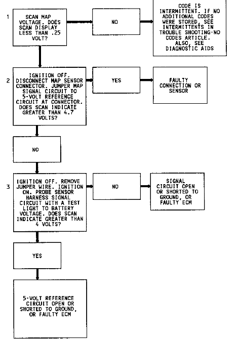

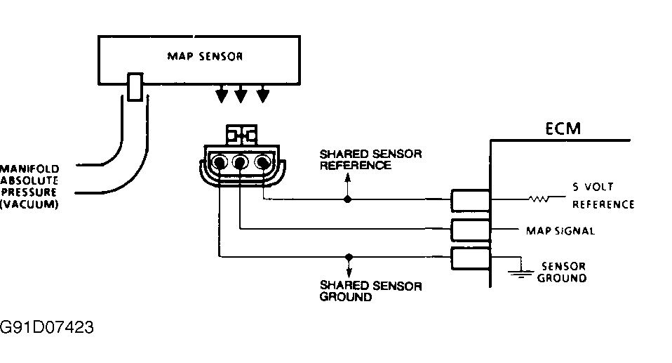

Clean out the idle air control valve/throttle plate and check acc. Cable if its kinked and test the throttle position sensor and manifold absolute pressure sensor
