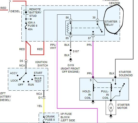

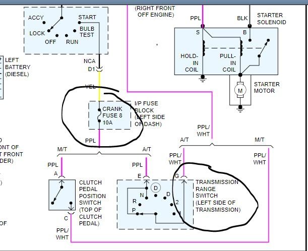

Number eight crank fuse keeps blowing. had ignition switch and harness replaced. can neutral safety switch be bypassed? seems harness leads to that switch then to starter relay.
Sep 3, 2020 at 5:05 PM (Merged)
94 TRANSAM
  • CAR REPAIR CONTRIBUTOR
  • 680 POSTS
Hi, thank you for using 2CarPros. Sorry you're having troubles. Lets see if we can straighten them out.
It is unlikely the switch is the issue. Have you tested the starter and the starter solenoid?
You can easily narrow it down to one or both them with a remote starter switch. They are cheap and save you from pulling the starter to have it tested. If you hook it up and press the button and nothing happens it could be a shorted solenoid or starter.

SWEETLEW
Starter and solenoid were tested. also tested with a fuse savor in park and neutral. lots of shaved wires and some wire nuts under dash board yes wire nuts! So we’re thinking somewhere from ignition switch to neutral safety to starter relay a bare grounded wire.
  • 110,190 POSTS
Welcome to 2CarPros.
You would have to bypass the range sensor and then it won't start at all. I attached a portion of the schematic. I see fuse 8 and it goes directly to the range sensor. Disconnect the range sensor and see if the fuse blows or pull the starter relay and see what happens. If it doesn't blow with the relay pulled, it's between the relay and the starter.. At least that will help us narrow it down. By the way, wire nuts? Ugh!
Let us know.

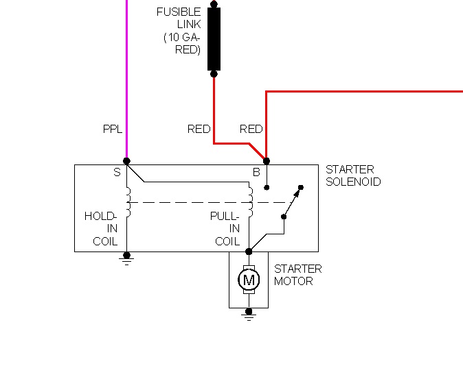

Use a digital multimeter and we can help you do some testing. Place meter leads across battery posts, everything off, what is the reading? If the battery is down, take it off and get it charged.
If battery voltage is lost, where applicable, your security system could be an issue?
You could test the starter circuits, any testing at the starter, make sure tranny is in park or neutral and the parking brake is set.

A security system shouldn't effect the starter. The purple wire at the starter S terminal goes hot with the key in the crank position. The starter B terminal is hot all the time.

Just to add, The purple wire at the starter solenoid, should be be hot with the key in the crank position. Is it? Any testing, make sure the tranny is in park or neutral and the e-brake is set. If the wire isn't hot, check circuits at the starter relay in the underhood fuse box. There are applicable fuses, check the fuse/s. Some of the national brand autostores will test the starter for you, if you take it off and take it to them. Let us know.
