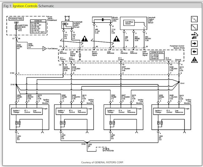

My car is super charged and I drove it through water. The car died and has not restarted since. I removed plugs and blew air down in cylinders but no water. Oil looks milky though. Checked all four coils and they are fine. Replaced spark plugs. Car tries to start but is only firing on two cylinders, left to right cylinders two and three only ones firing. No ignition module on this model. I moved one and four coils to two and three positions and two and three cylinders still only ones firing. Removing air cleaner did not help. Unplugged every wiring connection I could find and inspected, also sprayed with contact cleaner, please help thanks!

Did a compression test, looking at engine from under hood, left to right #1 150# #2 165#. #3 180. #4 120 it's really trying to start just won't. Havnt changed oil yet. Turns over good. Gonna check wire loom that connects to each coil this wknd. Noticed from trying to start only #1 cylinder fowling plug.

I unhooked maf sensor turned over with gas pedal pressed. Still no start. I did turn key on and and checked voltage at the plug in for each coil pack. All 4 plugs tested 12.4 volts. But still no fire from 1 and 4 spark plugs I put a code reader on but no codes, I did have battery unhooked so probably why no codes.

KEN L
  • MASTER CERTIFIED MECHANIC
  • 43,056 POSTS
Hey Pat,
It sound slike it might be a shorted coil either on 1 or 4 becasue they are related. Here is a wiring diagram to help fix the problem.
Try unplugging one or the other to see if the park will come back.
Please let us know happens so it will help others.
Best, Ken

PATJ2466
  • 18 POSTS
I did move good coil2 and 3 to 1 and 4 spot& 1 and 4 to 2 and 3 spot. Still only got spark from 2 and 3. But I'll try what u said. Need all the help I can get! Thanks
