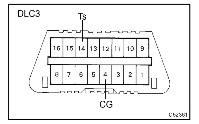

I'm trying to figure out which terminals I need to connect a wire to to do a zero point calibration are my vehicle listed above. any help would be greatly appreciated. Thanks in advance.

I posted the calibration procedure for you below. You will need an advanced scan tool for this. Why do you think you need to do this calibration?

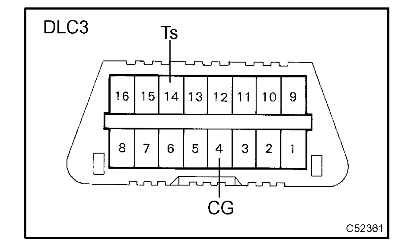

3. Using SST, repeat a cycle of short and open between terminals Ts and CG of DLC3 4 times or more within 8 sec. Check that the VSC indicator light is lit indicating the recorded zero point is erased.

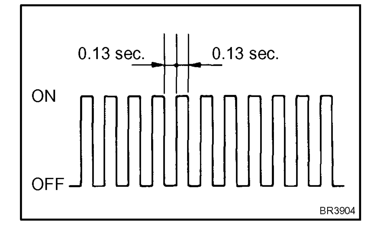

3. After turning the ignition switch ON, check that the VSC warning light is lit for about 4 sec. and then starts quick blinking at 0.13 sec. intervals.

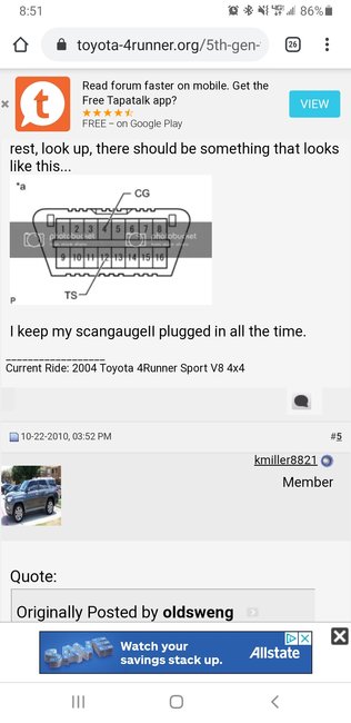

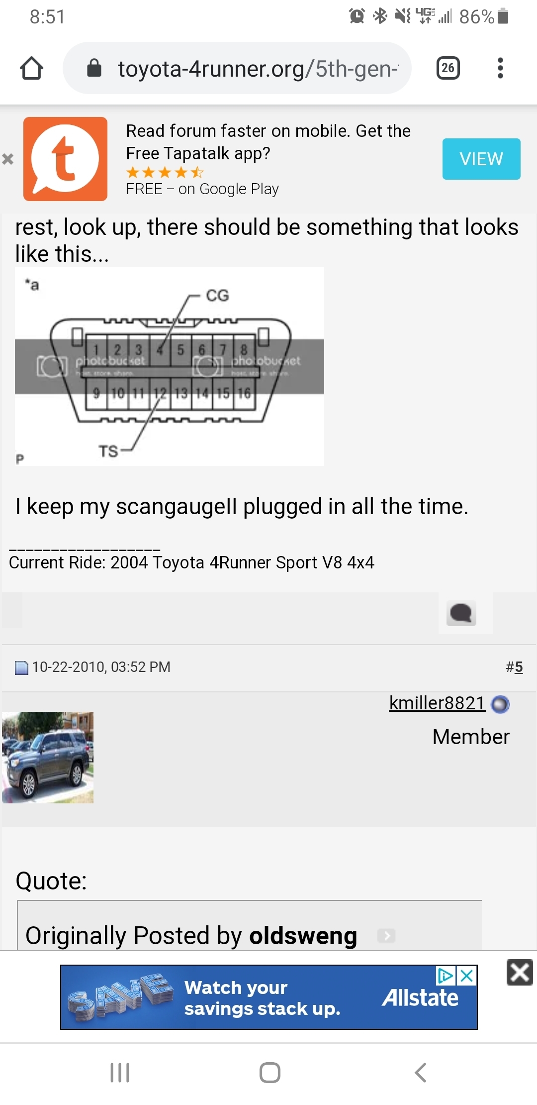

I just want to make sure I'm putting the wires in the right terminal because I keep getting different information one says 4 + 12. Your images are showing me 14 + 4.
Nov 5, 2020 at 6:52 AM
  • CAR REPAIR CONTRIBUTOR
That is correct. 4 and 14 are the ones.
